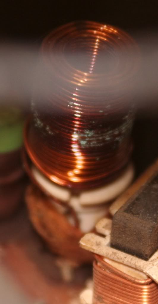

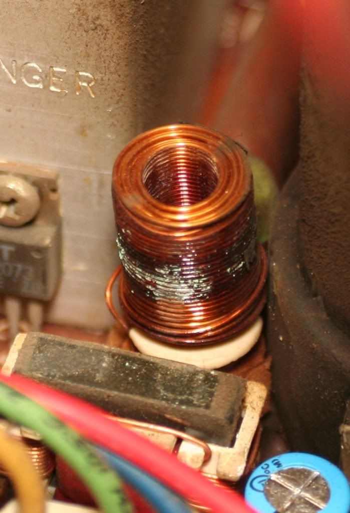

We're back to examining the horizontal width coil - here's a few pics of the broken coil:
ELutz tells me that the discoloration and crusty junk on the coil is a sign that the coil heated up and melted the coating on the wire, causing a short. Being shorted MIGHT be the cause in my high voltage issues.
Does any of this make sense to anyone? If so, I will see if I can swap out the coil with another one that may fit. Unless some generous soul here has a junk Disco chassis with a good coil on it they'd like to donate to my cause? :D
