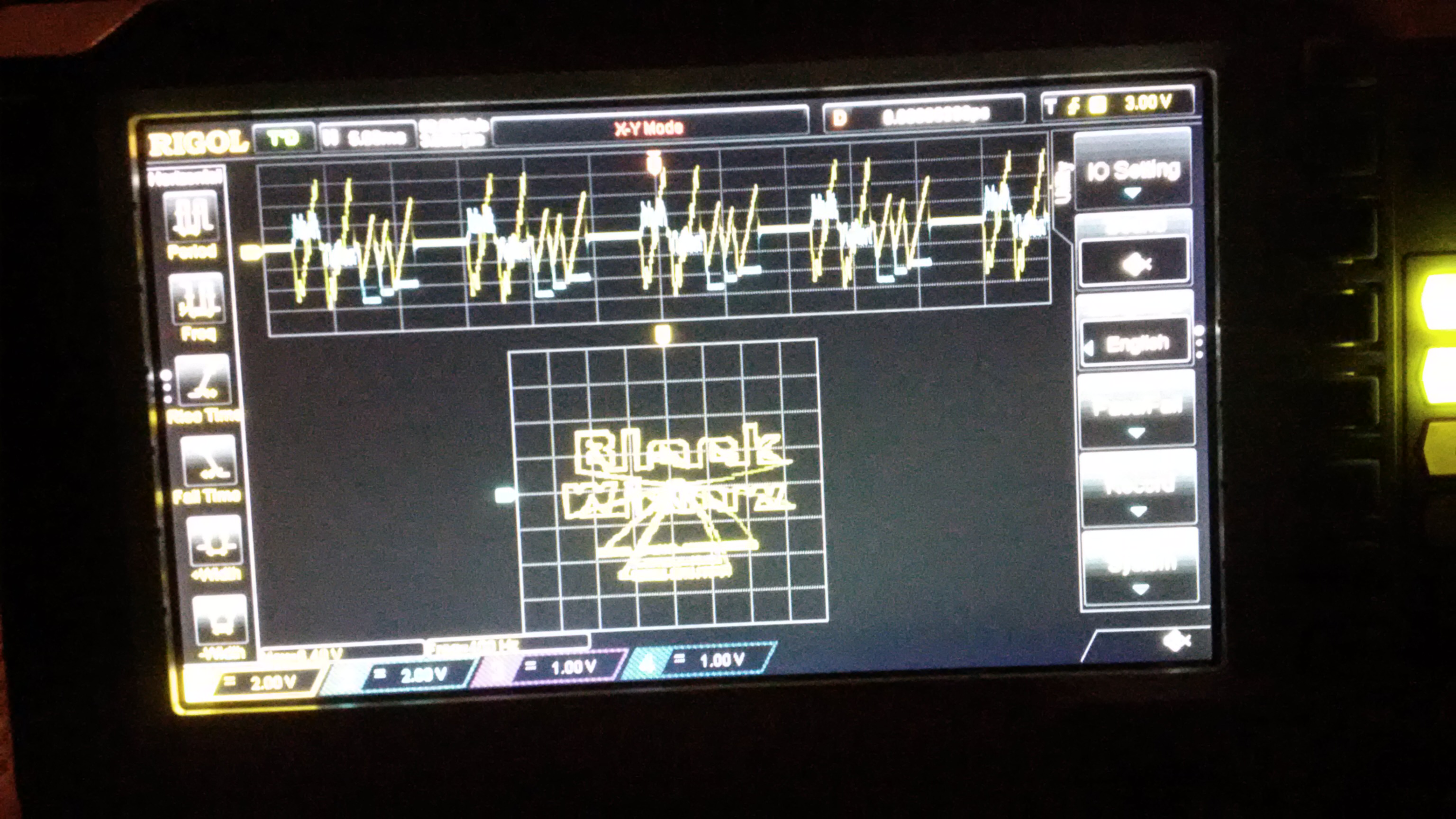

A nice digital scope which surprised me the other day with this debug screen ->
(I was debugging a dead BW PCB; can you tell?) :)

Hi there sir. I just picked up the 1054z and really very very new to this device.
But I am getting more and more hands on.
I have several Asteroids games and gave it a go last night with trying to get an image from the pcb board onto the scope.
I am doing something wrong. Mine does not look like this image here.
I am in XY mode. And I have the probes on the X out and Y out on the board...ch1 and ch2 is set on the scope as that is what I am using.
How do you then dial in the image so you can get your semi decent game screen going? I know this is not analog but I would like to see something....
Right now, I get a wiggly vertical line..thats it.
Thank you.
First confirm the X and Y waveforms in Y-T mode. (You can observe the blue and yellow channels at the top of the pic below).
Then center each waveform on the scope. (You can see the >> marker below).
Then choose XY. (This combines each channel as shown at the bottom of the pic below).
Time base and channel voltage setting shown below. (5ms, 2V, 2V).
Bandwidth likely not important.
If the Y-T do not look like the trapezoids shown, then you won't get a proper XY representation.
