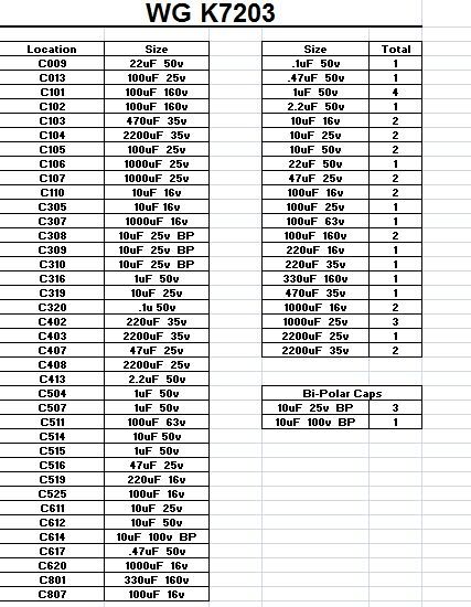

Basically, I have a spare 25K7000 cap kit I recently ordered and never used, and I happen to need a cap kit for a 19K7200. I'm thinking there are only a few differences and would like to know (if anyone knows) what those differences are. Getting ready for another parts order, maybe I can get away with piecing something together?
Yes, there are differences. It also matters whether you have a K7201 or a K7203. I though I had the K7201 list here, but I guess it's at work.
Here's the K7000 list. The 25" usually has an extra cap on the neckboard that isn't on this list:
Here's my list of the K7203:
I'm with Mod on this one....the K7000, K7201, and the K7203 are three very different chassis. For completeness, here's the 7201...

I have a 7201, looks like theres quite a few differences, better off just buying a new cap kit. Oh well, I guess I have a spare K7000 kit if anyone is in need.
