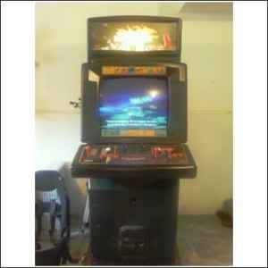

im goin to pick up a a die hard arcade machine tonnight and need a littleinfo looks like the cab is almost a candy cab
is the whole cab plastic or is it sitting on a wodden base what size monitors do these have are the 19 inch or 25 inch
guy is asking 150$ for it wich as long as it has a good monitor i think is fair
$150 is a great price considering the 25" monitor is worth that alone. The game play itself is meh to me. I'd buy one to turn it into a MAME machine.
It sets on a steel diamond plate, 25" monitor, crazy coin mechs
cool thanks im wanting it for the monitor ill probaly sell off the stv board

The monitors are usually a WGM U2520, which if you ask Ken, is one of the worst Wells ever made. The good news is, the 25K7400 is a drop in chassis replacement (which is what I did for mine since the u2520 was dead.
I like these Sega Cabs. They're pretty cool. Only thing that sucks on them is that you need a key to open the CP. If you look underneath the CP on each back corner there is a lock. You need to unlock each to get a look inside. Be sure to ask for the keys otherwise you'll need to try and pick the lock or drill it out.

well it had a great monitor in it till i mucked it up im sooooo pissed at myself right now
while i was removing the cp so it would fit into my house i broke off the horz width coil arggggggggggggggggggggg
the remote board wires were wraped around th ecoil andwhen i unhooked it it droped into the cab and rioed hte coil righ tin half
now it just clicks and has no neck glow
oh well looks like im in te market for a 25 inch monitor still

end the end it all worked out
i ended up trading off all my broken monitors for a good one(i really was runnig out of space anyway) , and now i have it back up and running
alll in all id say it was worth the 150$
great looking cab (always have wanted a candy cab and this is cose enough to one)
and its jamma so now i have a good jamma cab to play all my boards on
would have been much better without me breaking the hors width coil but meh it still didnt cost me any extra cash for the new monitor so oh well lesson learned (also installed my first iso from scratch since hte new monitor requirs a iso)
overal is in great shape also only one small crack up by the marquee that i shoud be able to take care of
here se is just got to rewire the marquee light find a place to mount the new iso fix the small crack and adjust the monitor colors a bit more (wAY TO MUCH GREEN RIGHT NOW )

lol im still having trouble with this damn thing tho i cant get the green out of the picture so ill have to rip the monitor back out agian and head down to my arcade guys warehouse and get another one (this time im not leaving with one till i see it work
