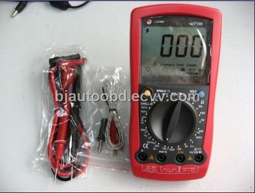

Sounds like you should try a new 9v battery in there and you'd probably start getting real readings again. But as it was pointed out, better DMMs will either give you accurate readings right to the end or at will at least tell you the battery is low so you can change it. If you do replace the battery you should check the voltage on the 9v battery in your meter that was giving you trouble and tell us what the voltage was. :)
I have an ultra-cheapy one I got at Fry's years ago and it is really accurate but the rotary dial drove me a bit nuts -- you have to be really careful to click it into the correct spot to get a proper reading. I finally went and bought an Extech meter for about $50 that I've been really happy with.
I'd like to recommend the Uni-T multimeters. I have one similar to this:
I also have a nice Dick Smith one which has an automatic backlight and does up to 20A, but they don't sell them anymore.
