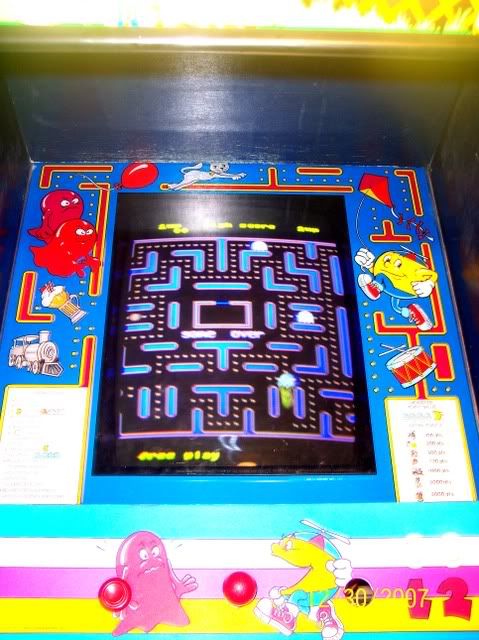

Oh, I'm tempted to milk this one! But the truth is.. I took Chris up on his offer and bought a monitor! Anyone considering buying from Chris.. go for it.. Monitor was spotless.. all new parts, very nice.. No screen burn, and this picture doesn't do it justice..
My camera is acting up.. picture is sharp and colors are deep and true.

Now.. I don't have time to chat.. I got a game to play!

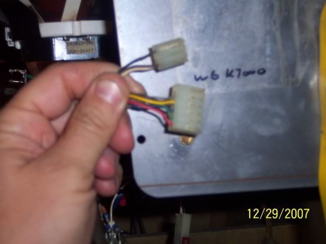

Just capped a Matsushita myself this weekend and I have a strange snych issue. You can get a pic, but it never truly settles down or synchs right. Did not change the flyback, just the caps. I know that the Matsu doesn't use the top synch pin like most monitors do, but even when we took the top synch pin out and swapped the 2 synch wires it still did nothing. The pot in the middle of the chassis has alot of effect on the picture synching, but it never quite gets there. Who has a manual for this monitor?

It may have something to do w/ the game.. but the monitor I got from him did NOT have the same sync as the matsushita..
The TM had a purple and a white wire going to the bottom sync pin.. nothing in the middle.. and a black wire to the top pin..
I had to cut the purple wire to get the WG monitor to work in my JR pac.. Do you need pics?

Mine has from bottom to top, [R, G, B, Ground, Snych, empty] I can see the game attract screen, but it is warped, torn and otherwise scrolling or all of the above, no matter what we do. I am encouraged that I can see a pic at all. We were running it through a frogger pcb/harness.
I'll 2x check mine, but i thought it the grnd and sncy were on the far end from the colors.
I 2x checked.. verify that it isn't 4 blank 5 gnd 6 sync

trying here again...on my Jr pac.. on the board.. the sync wires and video wires came from one large plug..
Black sync wire was number 2 from the left.. white was the 4th pin.. and purple was the 6 pin.. and like I said.. purple and white went to the same bottom plug.. black went to the top plug..
