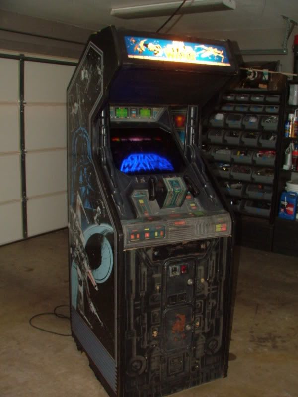

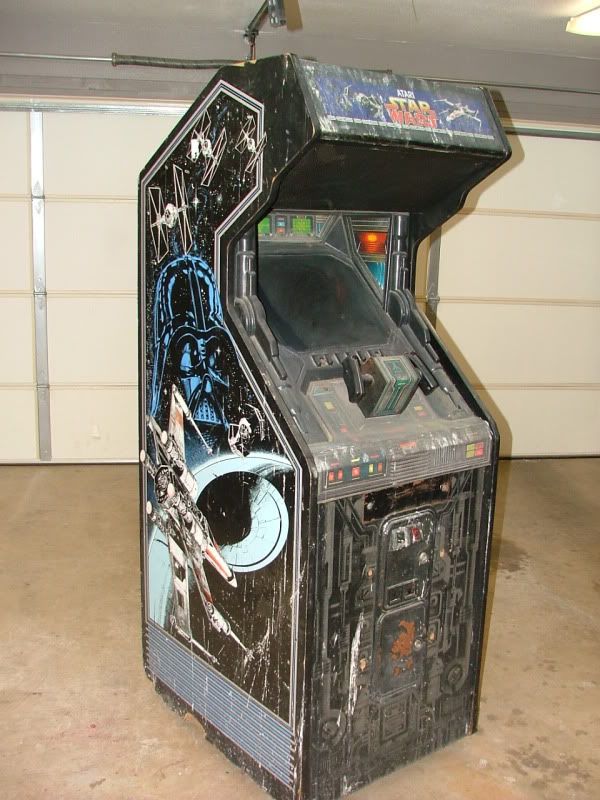

I know, I know, pics or it didn't happen -
Here's a shot pre-Simple Green:
And after:
Some more pics here
Not bad for $20 (or even $40). ;)
