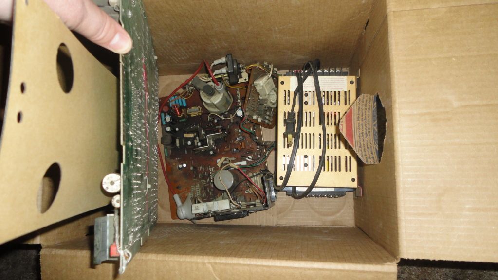

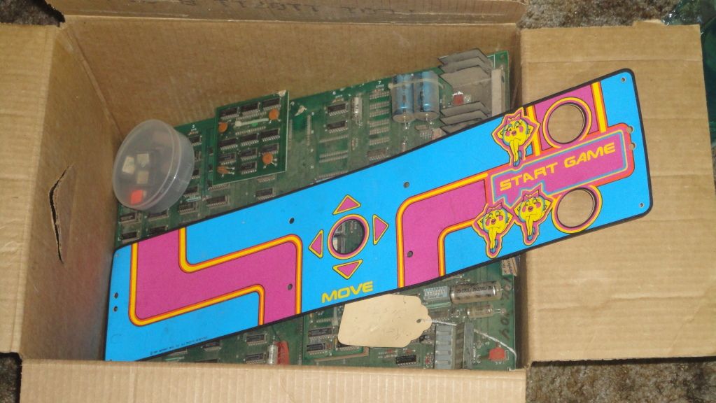

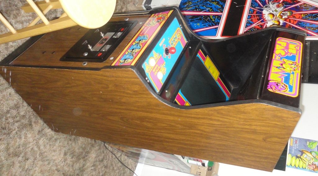

On Thursday I sold my upright Asteroids project to a fellow KLOVer who was more interested in the restore than I was. Today, I took the money from that, as well as my Samsung Blu Ray Player with a handfull of movies and traded it for a working Ms. Pac-Man cabaret. I thought that was a decent trade. When I got there, however, the guy gave me a box of extra stuff. He didn't know if anything worked, but he said he didn't want it so I could have it. The box contained another Ms. Pac-Man PCB, a complete monitor chassis, 2 power supplies, and a NOS Ms. Pac-Man upright CPO.
When I pulled up I could hear the game playing and I thought, "Man they turned that thing up loud!" The guy saw me from the front porched and told me the game was out on the other side of the front porch under the awning. I asked if it had been there long and he told me that he just put it out there when I got off the phone with his wife to make loading it easier. A weight was lifted and I was on cloud 9 again.
The cab is in much better condition than I thought it would be in. I think the guy must have used a crappy cell phone camera for the picture because the marquee and front control panel art isn't as bad in real life. It has the holes from a security bar in front and an add-on pad lock style lock added to the back door.
My wife is at her baby shower and has the camera so I will post my pix when she gets back. The attached picture is from the craigslist ad.

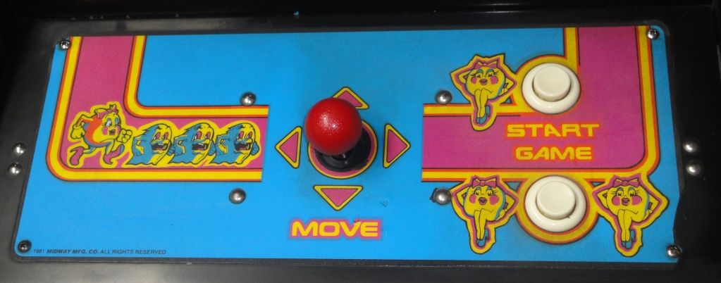

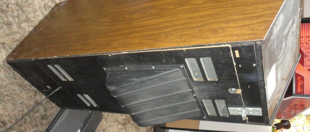

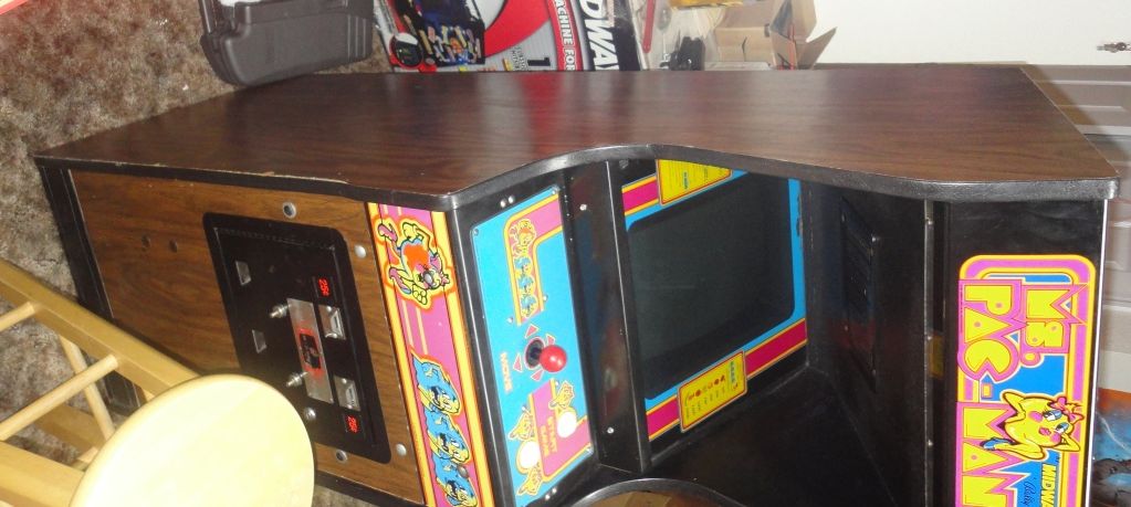

Here are some pictures...

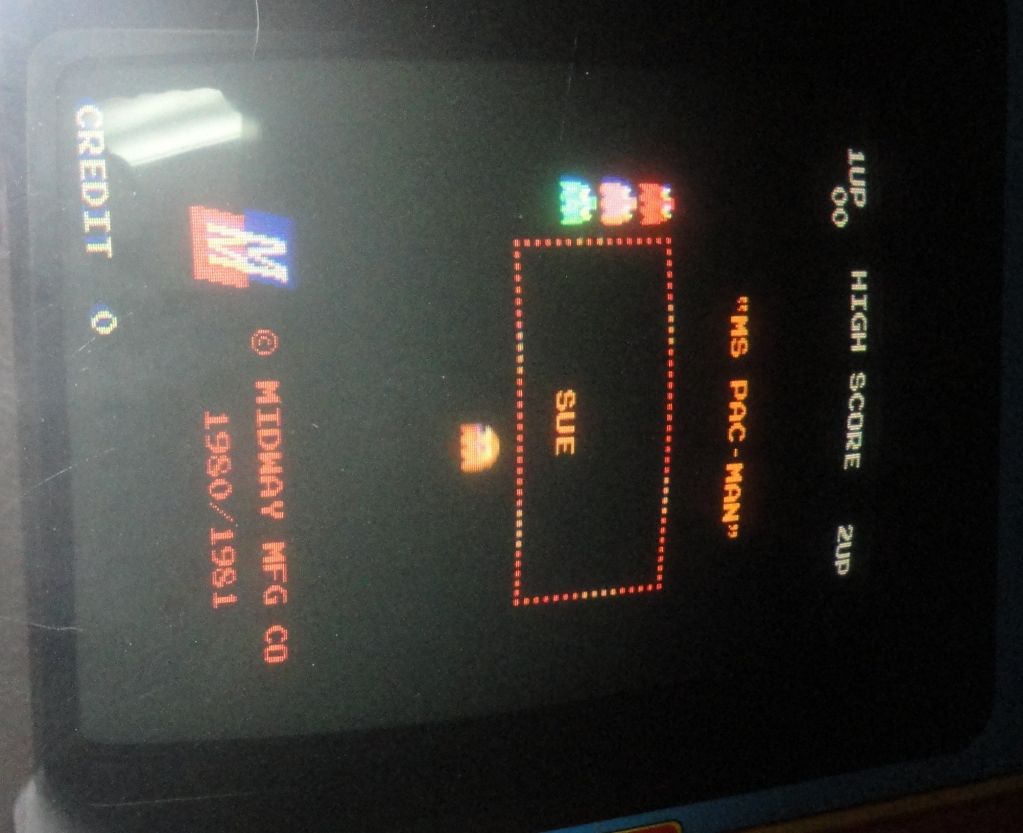

The game works and plays fine, but I noticed a couple things about the game...
- Marquee and Coin Door lights were out so I bought replacement bulbs. Still no light. Should mean fuse is out. Looked inside to test fuses with DMM and the fuse holders had all been removed and rewired into each other with resistors or something. Blah! I'll fix that.

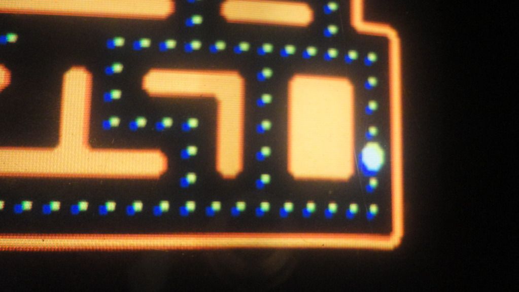

- Monitor has a convergence issue. I'll need to find someone to assist me with that. I still deal with involuntary tremors in my hands a bit so I try to stay away from the monitors and most soldering work.
- Needs the lid for the coin box. I put 2 quarters in and had to fish them out of the bottom of the cab later. Not a big deal, but I'm a NERD so that'll get replaced too.
- Has the speed up chip installed. I HATE THE FAST VERSION. The day I picked this game up was the first time I ever played the FAST version and I am not a fan. Luckily, there was a small tray of chips in the box 'o stuff I got and I believe the guy told me the slow chip is in there.
- PCB is the "hacked" version of Ms. Pac-Man that does not require the daughtercard. Not a big deal since the game is supposed to play the same. However, I will probably find a regular set to replace this one. My extra PCB in the box 'o stuff is also a "hacked" version.
That's what I saw so far...
If you were closer Dan I would totally do that for you. I am really good with setting convergence.
Thanks, you help me with a lot of stuff. It's a shame the distance is so great. It would be cool to work on some of these projects in real life instead of the waiting games we play with snail mail.
Busted out the Magic Eraser on the CPO. I love that thing. This is the middle of the road picture. Left side magically erased while right side is dirty...
I like the way it cleaned up. I'm gonna go work on the CPO on my original maze dot eater...Head-On!

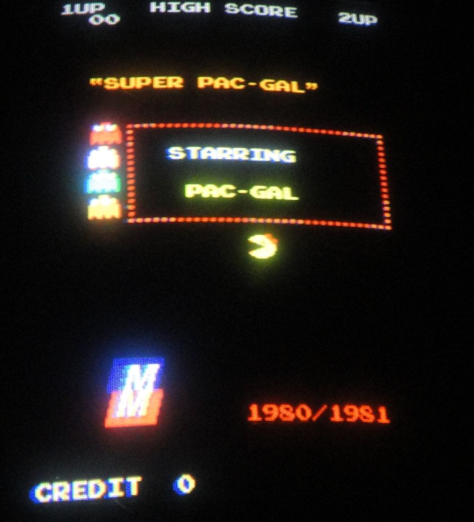

Today I decided to try and fire up the spare board to see if it works...it does. This one is a little different in that is says "Super Pac-Gal" instead of "Ms Pac-Man"
Both boards are hacked versions that make it so you don't need the daughtercard. Now I just gotta check into the box of chips to see if one of them will get me back to slow Ms Pac-Man.
PCB that was in the cab when I bought it...
Spare PCB in the Box 'o Stuff...
Super Pac Gal is pretty cool too, doesn't it have different maze layouts?
