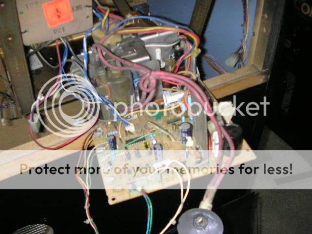

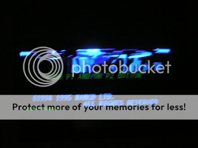

Title says it all.The board is some nock off k7000 2 wires to the anti dode cap.The game is Tekken 2.It looks like the top of the screan folded.
looks like you're missing red too. was this a problem pre-cap kit?
if so, I'd poke around for cold solder on the signal header. check for potential shorts too for added measure. and if Ken says to look into something, then you should probably pay attention to him first. :p
good luck
Thanks for the info Ken, It adjusted a little out not by much.
Mecha, This was not the problem before the cap kit.The monitor had squiggles Middle of the screen and up look like a 5 year old did it.
Both ic chips look as if they have ben replaced and a couple of diodes.
Check the connectors to the monitor and boards. Might be a bit loose. Sometimes when you take a game apart and put it back together you don't fully reconnect stuff. It's happened to me.

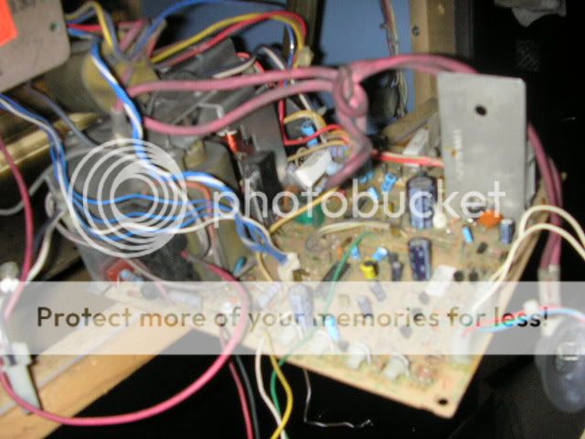

here is some pics.I also forgot to mention, The stand alone heat sink to the right of the board gets hot extremelly quick i allready burnt my finger on it a couple of times.
Yeh that's a Zenith K7000A.
That very tall stand alone heat sink is what draws the heat away from the vertical output IC chip. Chances are your chip has gone bad and needs to be replaced.
Replace the chip with the same number as what is presently installed in your chassis.
