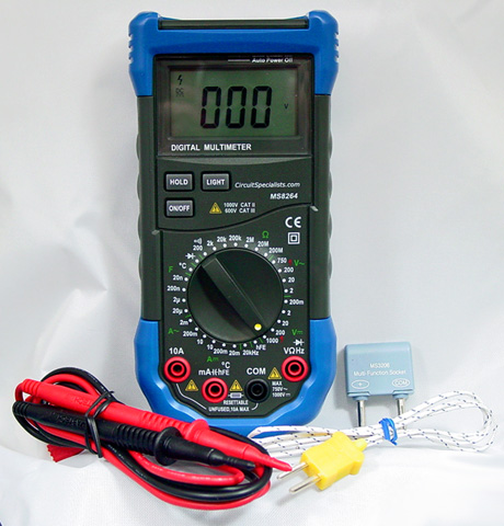

I just bought the Blackjack 4000 from Circuit Specialists (link). It was around $140 shipped. It includes 3 tips and a full cleaning kit
I bought it last Tuesday, it was on my doorstep on Friday. They are currently running a special that includes a free piece of equipment. I grabbed the DMM.
It looks like a Chinese knockoff of a Fluke, but seems to work.
I am just starting to use it, but it seems to do a decent job. I still need to play with the settings a little more to get it dialed in.
