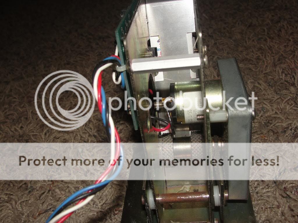

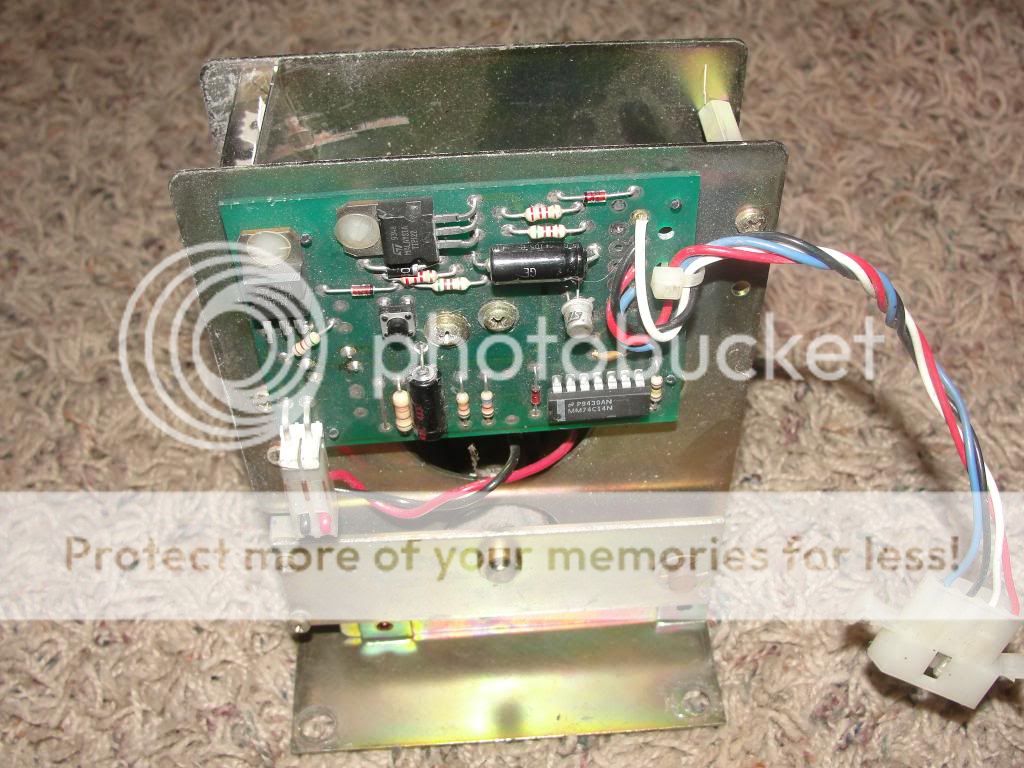

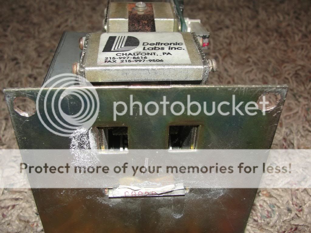

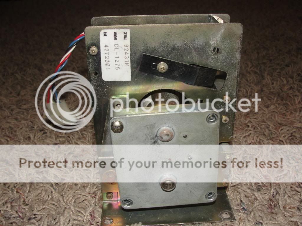

I believe this is ticket dispenser. It appears to be complete with the motor, wheels, pcb, guide, etc. I have no way to test it but I can tell you that there is still tickets in it (see picture) make me an offer I can't refuse if interested.
You can "ungrip" the tickets by pinching the big metal arch towards the back of the mech. Then they'll pull out freely.
I believe you can test it by applying +12V to red and black wires, then checking for a notch signal on one of the other two wires as you move the tickets through it. (The last wire is motor enable from the game.) You can test the motor by just pushing the button on the PCB -- it'll roll.
