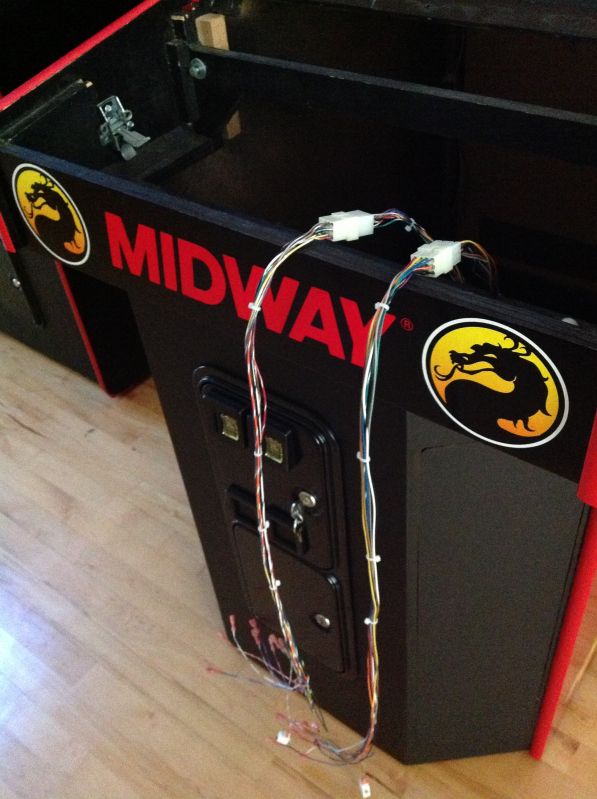

Yea, I sent an email to Bob Roberts asking if he had any of those .156 male/male interconnects and he said they're obsolete junk. Said they were the worst idea midway had and it took them 2 years to realize it.
Was considering using the D molex connectors, like maybe a .093 like these
http://www.therealbobroberts.net/molex093.jpg
yea that's what bob uses, and i've used that in a few games myself. they work well (almost to well as they lock together fairly tight).
Are you guys talking about these? I got these Molex adapters from BOB Roberts in a complete kit:
Yea those are what I'm looking to get. I got the dedicated jamma harness from quarter arcade which is in good condition, but a lot of the adapters need replaced. Interesting note though, the dedicated harness has the kick harness built in, the volume harness and some other bits and bobs.
Hey Brood, I managed to get my wooden panel pulled out fully in my cabinet. I ended up gently hammering on the underside of the of the top wood track. Kind of loosening the piece up and it slid right out. After that's sanded out the top and bottom track to make it smoother.
I also ordered some molex plugs from Bob Roberts. Went with .084 size, very easy to do with the right tools. I'll be posting some pics in my resto thread this weekend once I get the boards in the cabinet.
