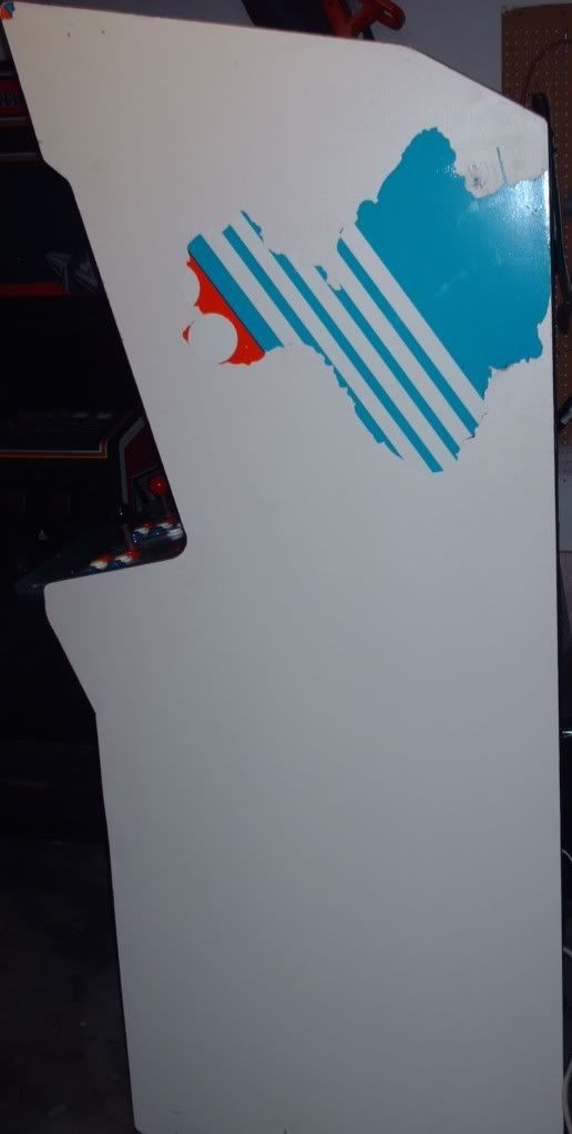

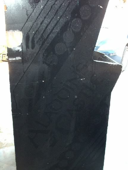

Time to Citistrip! The best option with the stuff is to let it sit, gently go at it with a plastic putty knife and finish it off with a Dobie pad. It needs touch up (obviously) but off to a good start. I started on the lower left and goudged it a bit before I got the hang of it.
Left side art, before:
Left side art, after:

Finished the left side, it took all day for both sides, but no major problems came up. The stripper softens the vinyl artwork underneath, I was always nervous of a major tear or rip.

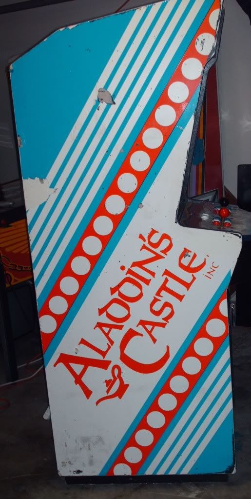

This side is not as good, notice the large amounts of bondo this cab needed to get it straight again. Poor cab.
Thanks for the positive responses so far. I'm not sure where this fits with collectors so I really appreciate knowing what everyone thinks about it.

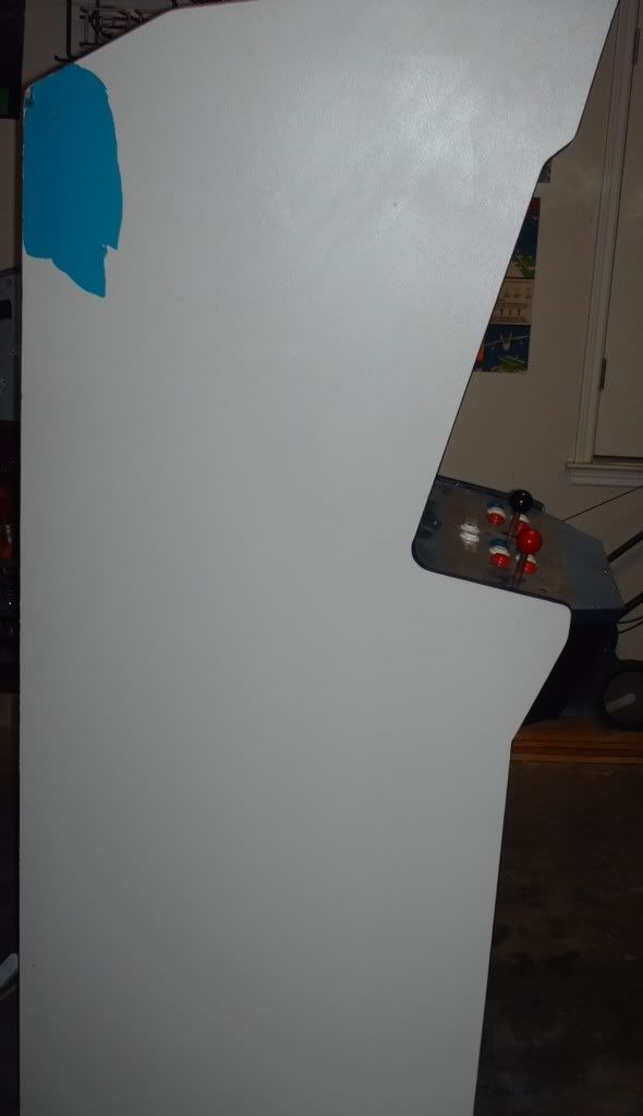

I'll be touching it up removing the small bits of black paint, going over the white with a magic eraser, and probably using some Kilz for the bondo areas.
Before:
After:

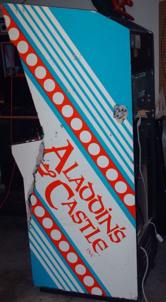

I have one of these, but the sideart is peeling. How are you looking to restore it? Is there replacement art out there? I was just going to paint over it...kind of the opposite of what you just did! :)

Why in the world would you just 'paint over it? That side art is awesome and part of history. Not sure how many of those cabs survive in the world, but I've never seen one. If replacement side art isn't available, at least try to color match and touch it up.

I'm going to go for a light touch, right now I just plan to fill in the white areas and leave everything else alone.

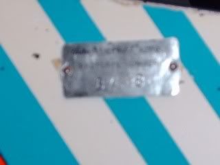

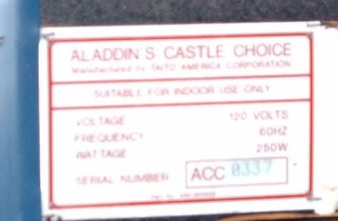

The Bally Aladdin's castle serial number tag. Survived many conversions, MAME, and my paint stripper. It was all black until yesterday.
