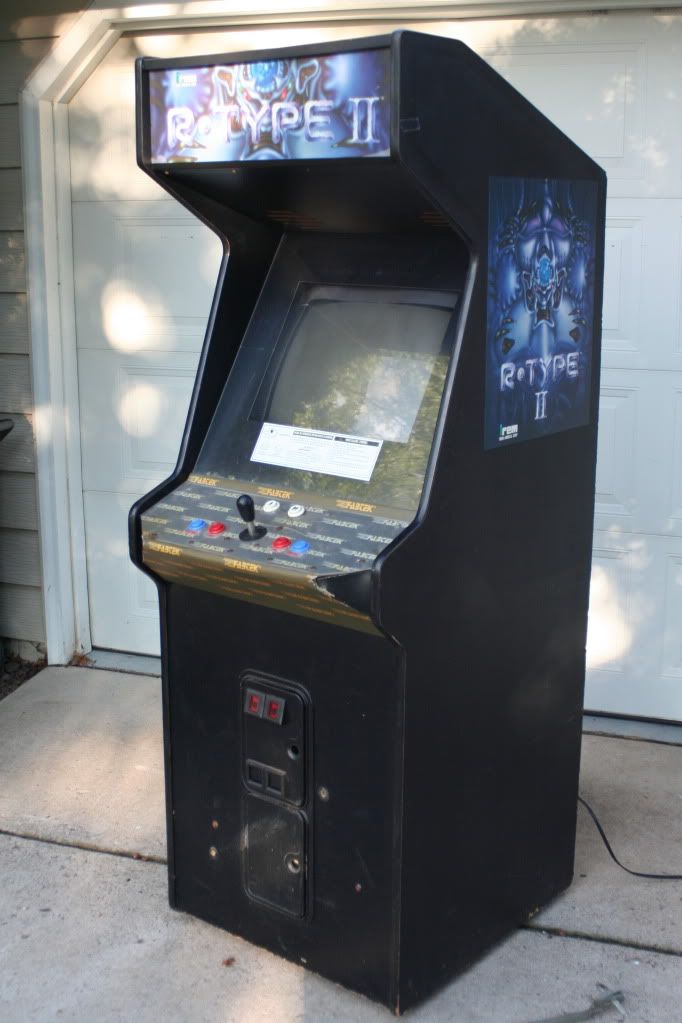

And an ambidextrous single player one, like the R-Type II cab I sold for a friend a while back:
Had I known how rare that ambidextrous panel was, I would have pulled it and swapped it with a normal 2 player one. *dammit*
