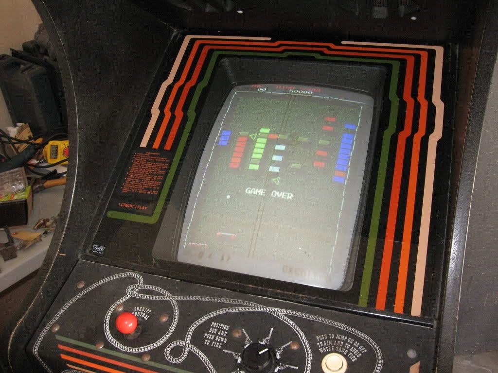

I could use some help with my Wild Western. It is totally dead, with nothing coming up on the screen and no sounds. I've replaced the power supply with a new switching power supply from arcade shop (the original was dead) and verified that the monitor shows a picture. Araknoid looks great by the way with Wild Western train tracks running through it.
Gonna replace that monitor as soon as I get this thing running.

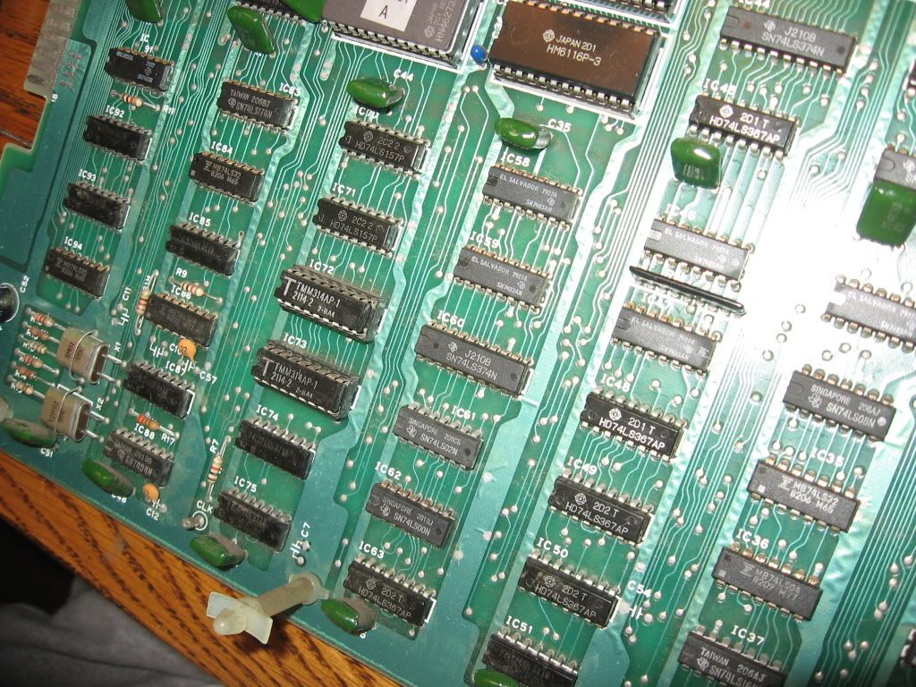

I took the board out yesterday to clean and inspect it. First thing I noticed is that many of the chip legs were very very corroded. I did what I could to clean them up with a toothbrush and water. See before and after:

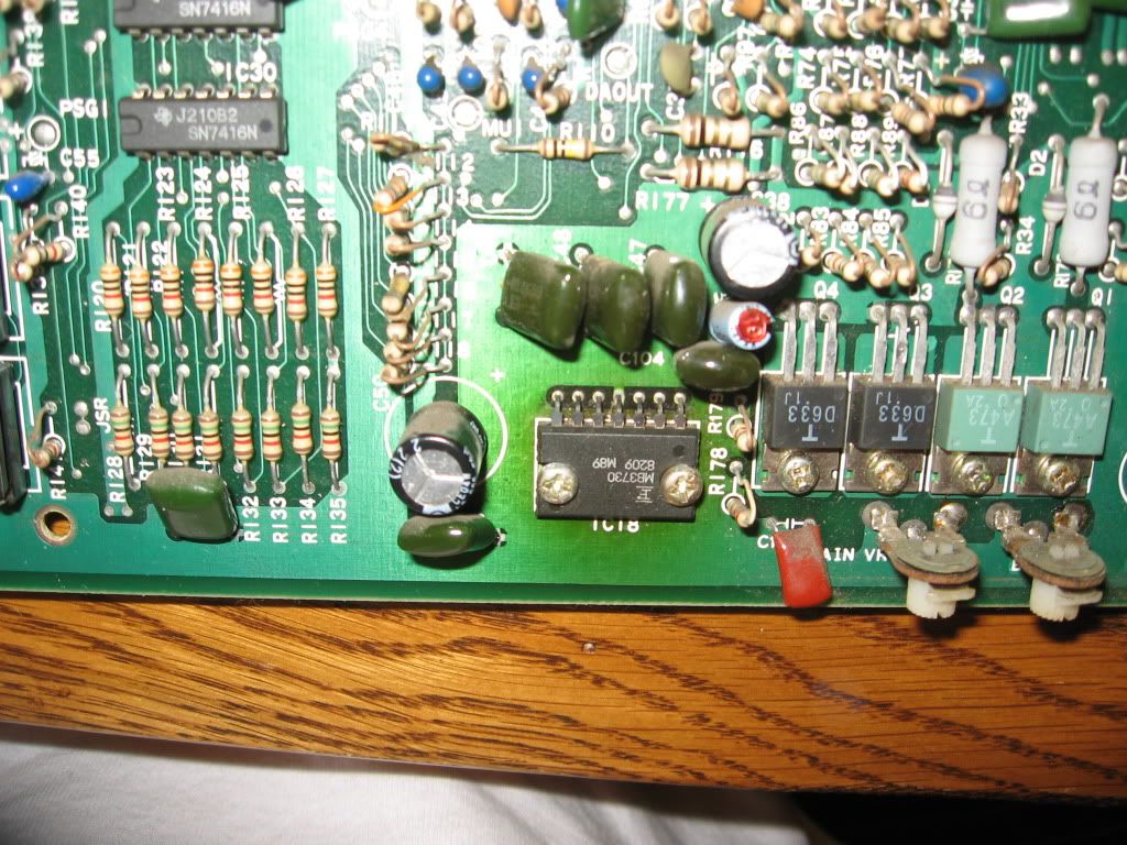

Otherwise, the board looks like it hasn't been touched in 30 years. I see no signs of abuse. There are no scratched traces or bad soldier joints. The only other issue I see is possibly this chip:
Does this look toasted? How would I go about debugging/fixing it?
That chip is a sound amp and it runs hot, that is why you see the discoloration.

is that rust, though? i've seen that on boards from time to time and it's more like dust and dirt collecting on the legs. i don't think rust would come off with a toothbrush and water.
Not sure what it is... probably rust, and the pins didn't come completely clean as you can see from the before/after pics. They did clean up a bit though. Even the rustiest chips seem to be getting 5 volts.

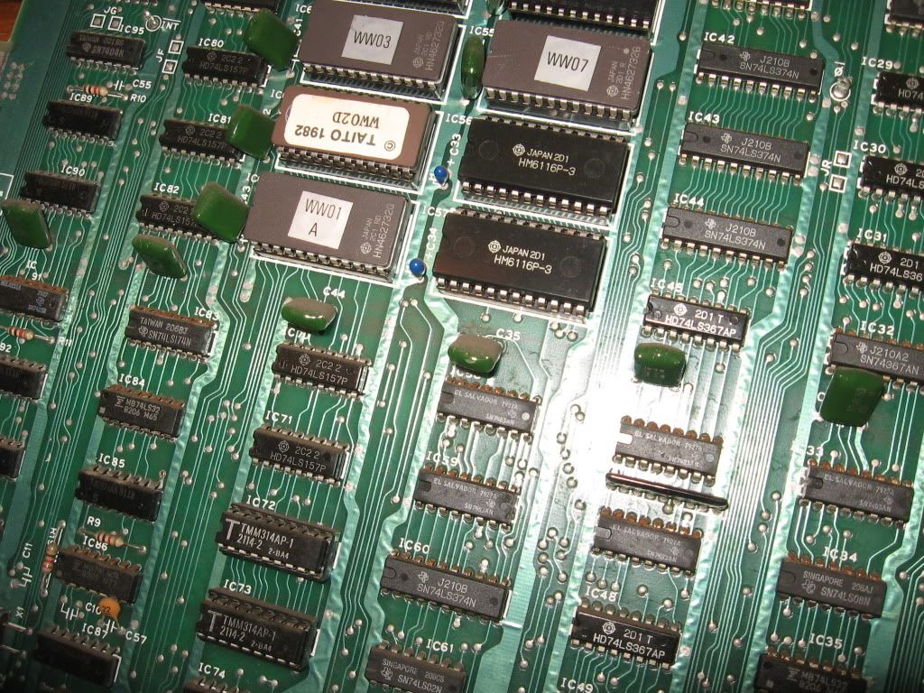

I did some more voltage testing on the chips and I did find a bunch of chips on the top board (the "game board") that aren't getting 5 volts. IC32 is only getting .8 volts and there is a block of 4 chips (IC20, IC10, IC21, and IC11) that are only getting 4.33 volts. Not sure how to test the rest of the chips on the other boards since they are underneath, but there are probably others that are low. Coincidentally, the bad chips I've identified don't have any rust on them, and I didn't notice any bad solder joints when I had the boards on the table. What would cause these chips to be low power?
