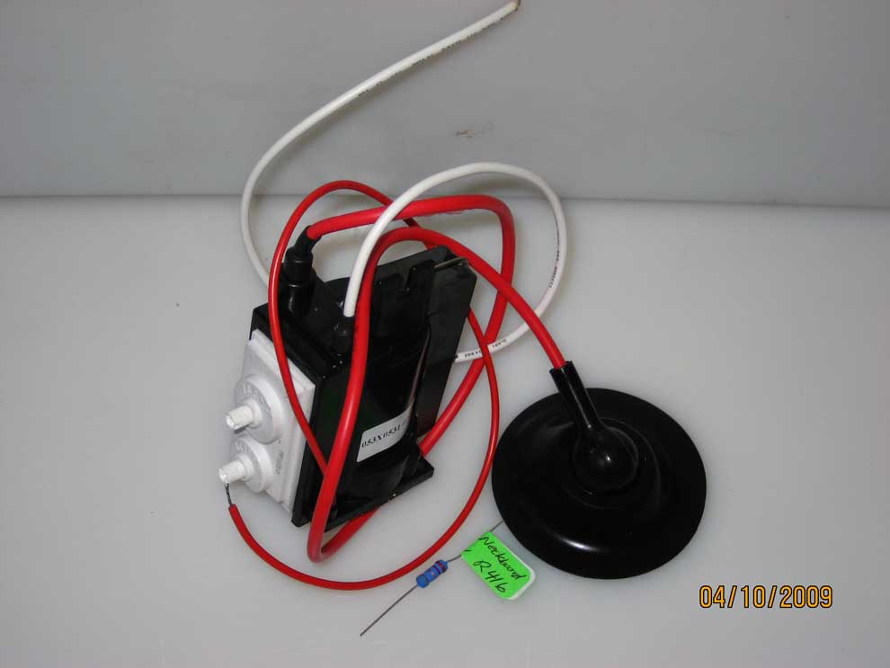

the 5515 flyback, which you need does go bad often. I do have replacements now on my website for $33.00 shipped. you want 053X0531-001. I am the original catalyst for these to even exist in the market along with many others in the first place if that means anything to you.
I see twisted also carries the 6100, amplifone and SANYO ezv. Glad to see others jumped the band wagon to carry these after I was the only one who had to balls to put a end to what I seen as a big price collusion skit that many of the klov users fell for.
Ignore the resistor in the picture thats not needed for the flyback install. that was a earlier version of the flyback that produced a lower heater voltage.
For those of us that have the earlier version, should we return them for a newer version? Did you experience any problems with the earlier version?

Absolutely, anyone may do so. however I don't think I sold more than 10 of the old style and sold them with the resistor change. you would have to check the manufacture date on the small sticker hiding behind the ferrite. i pitched all the old ones years ago.
