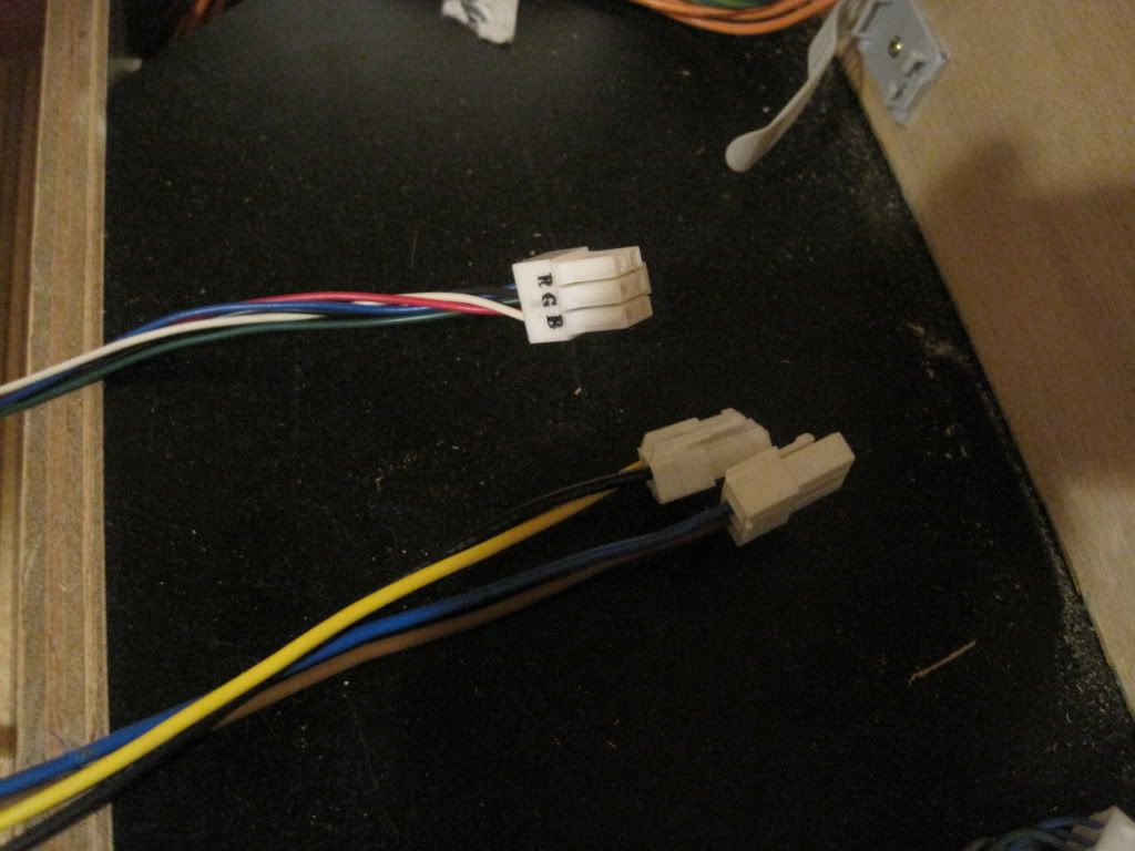

You can see the three end connectors going to the board in this picture. If you follow the wires you can see where they connect on the board
This is enlarged shot of where on the board those 3 wires connect. Now this main hub of a wire connects directly to the board in 3 locations. One of the red wire one for the black and a multicolored one.
These three wires here are on the receieving on, on the actually machine itself.
Okay, I remember those funky connectors now. Yeah, I ended up cutting those off, wiring in the normal connectors that go to the WG monitor, and then connected it up that way.
Yeah, it's a pain in the butt, but it worked...
iirc,
the one group with red, green, blue are, of course RGB connections (r,g,b,sync and ground).
the other two, one is for AC power, the other is for degauss switch.

Of the five wires on the video connector, you will have - Red, Green, Blue, Ground, and Sync. The brown and yellow are the ground and sync. You'll have to check to see which is which. If you follow them to where they connect to the monitor, i believe the chassis is labeled as to which is which.

It is not hard to make a video connector. You could probably even make one that mates to that connector if you could find the proper molex, but it's easier to just cut it off and make a new one.
This is an example of what you'd probably find on the new monitor somewhere. You will sometimes see two separate connectors as seen in this pic, or they will all be on one long connector...

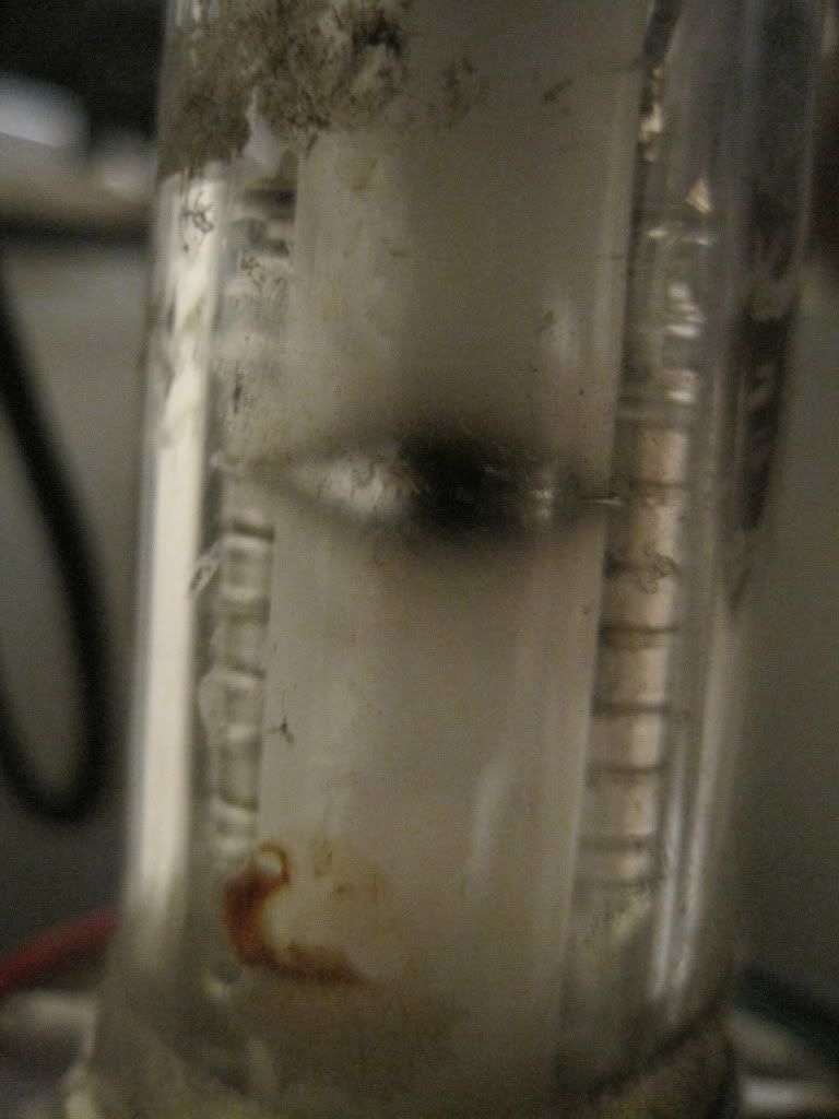

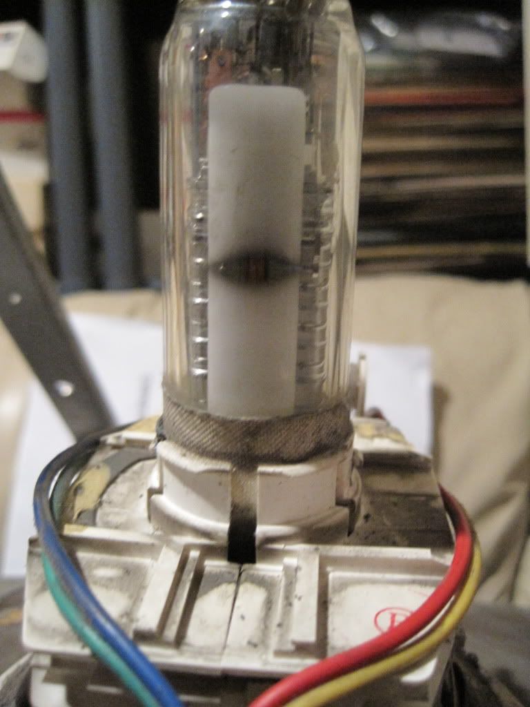

One thing my buddy pointed out to me yesterday was he thinks the actual tube on the monitor is shot. We hooked up the whole monitor and the actual tube itself wasnt firing off. We did not see any activity coming off of it period. So we took it apart removed some of the clamps and we think the actual tube may be burnt. I took a few pictures.
If in fact the tube is shot, better just to buy a new monitor then try to replace it :-/
1) The tube won't "fire off" if the chassis is dead.
2) That isn't a very good indication of whether the "tube is shot". You would need a rejuvenator to be sure.
3) Good luck getting your convergence back to perfect after removing the rings without marking the tube ahead of time.
4) If the tube is indeed verified as bad with a rejuvenator, then you can either buy the new monitor, or find a 27" TV that has a compatible tube and use it with your Toshiba yoke and chassis. But you'd still need to fix the chassis. I recently went on a service call for a K7000 that has a bad tube (rebuilt the chassis first, tested it, still barely had a picture, and hooked up rejuvenator to verify it was bad). It still powered up (static) even though it wouldn't give me a pic...
