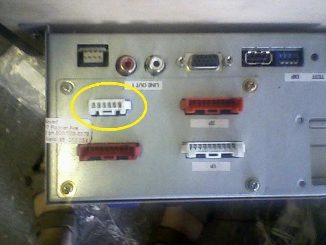

I asked this of a couple people a while back, but the northeast was buried in snow at the time and nobody could help me then. But I need to know this week:
In the picture below, there is a connector that has 2 wires (IIRC) that I circled below. Unfortunately, the wires came out of the connector and need to be put back. I have no wiring diagram, so is there anyone with access to one of these games that can get me a pic, pinout, or description to help me put it back?
Thanks...

ah, you need the wire colors. I'm back in the area working 7 days a week (or roughly every single day from now until October) so I'll see what I can conjure up for you. you just need the wire colors to put back in the connector and not tracebacks to where the wires need to go right?
Yep, we're replacing the CD-ROM and when I was attempting to disconnect that plug, the wires pulled out. I just need to know which goes where on the connector.

all wires are in the order of left to right as they would appear coming from the back of the game's main board.
1P/2P connectors:
black, blue, green, yellow, orange, red, brown
red connector: (probably the one you asked for?)
black, red, green, blue, yellow, orange, purple, brown, white, grey
small white connector:
red, black
I left the cab open, in case there's anything else you needed. but I need to know by tomorrow, we have a boys and girls club coming for a party on Thurs.
EDIT: good god, you DID ask about the little white one, lol. red and then black. :)
red, black
Well, that's great - thanks! But there are 6 spots. So - looking at that picture I posted and assuming that pin 1 is to the left and pin 6 is to the right, where do red and black go?
1 2 3 4 5 6
fudge
red, black, the rest are empty.
that applies to all the wire colors I posted above, left to right, whatever's left at the end is just empty. see, Konami actually made something easy.

I figured it out. I read this the other night, according to some hardcore DDR freaks, but I figured "wtf do these geeks know?" :)
that connector is what drives the NEONS on the subs.
1-Red
2-Black
3-empty
4-empty
5-empty
6-empty
I even unplugged it to verify. you'll see the wires attached to the backs of the subs inside. my red wire had some black heatshrink on it... not sure if that was broken before or what, but the wires attached to the subs on mine were red and black. perhaps those white wires you speak of were the ones they splice into the connector at.

like that. rotated for accuracy. I even drew in the wire colors. :)
