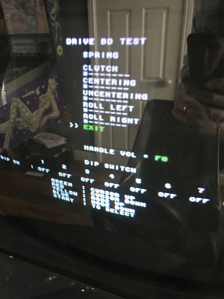

Hi all,
My Daytona steering wheel is ever so slightly pointing to the right however the car drives straight.
I was just wondering how to adjust the wheel so it is physically on center. I've tried removing the wheel itself and adjusting from the front however the wheel will only got back on in certain positions and the current position is the closest to center so I'm thinking I need to adjust things on the back of the dash?

Daytona Steering Calibration
Physically center the steering wheel. Make sure it does not move during this procedure. Go to input test. Handle should read 80h. If not, loosen the two screws on top gear back of steering shaft and adjust pot until it does read 80h. Lock down the screws. Now go into drive Bd test. There is also a hexidecimal value there. It should be 80h too. If not, adjust bottom gear like you did top gear and lock it down. Make sure the wheel does not change position as you do this or it will be out of wack again. With the wheel physcially centered, both pots in both tests should be 80h. Thats all there is to it. There are dipswitch settings on Drive Bd but I would assume no one would have ever messed with them since they left factory.

Hey Ken,
Thanks for your help. You mention that the Drive Board Screen should also read 80H however that screen is a little different to the Input Test Screen all the values begin with a letter and not a number see below:
