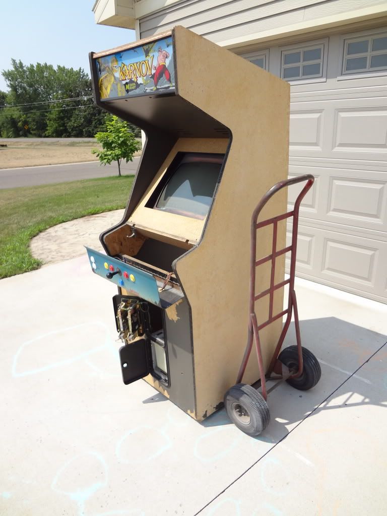

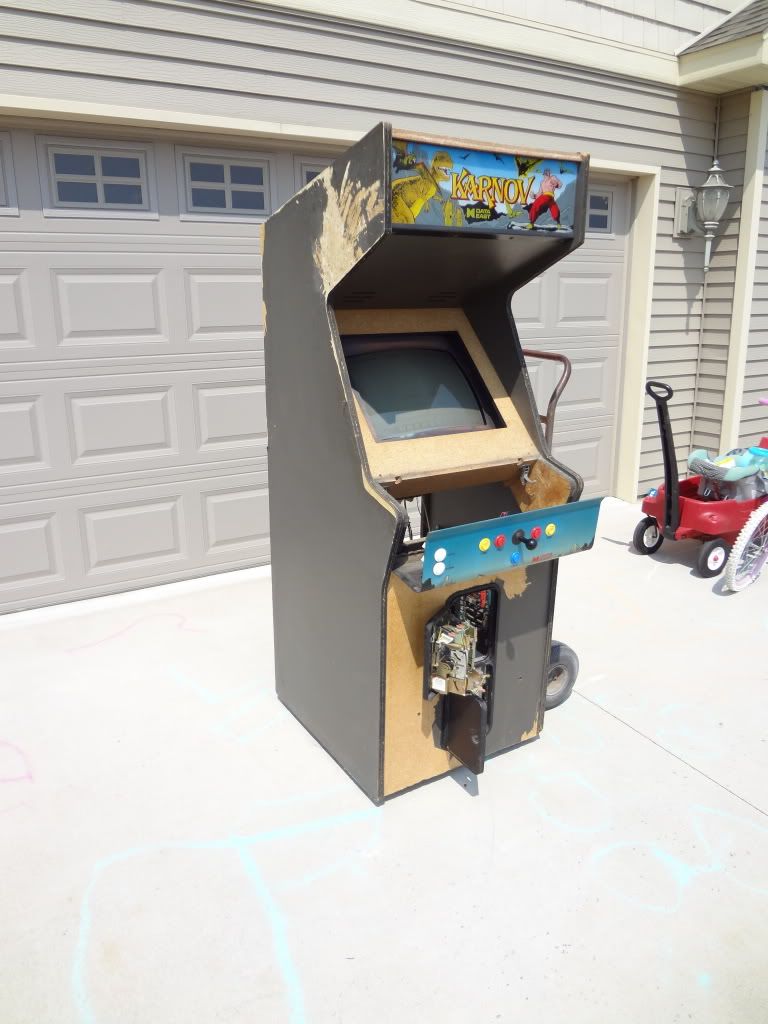

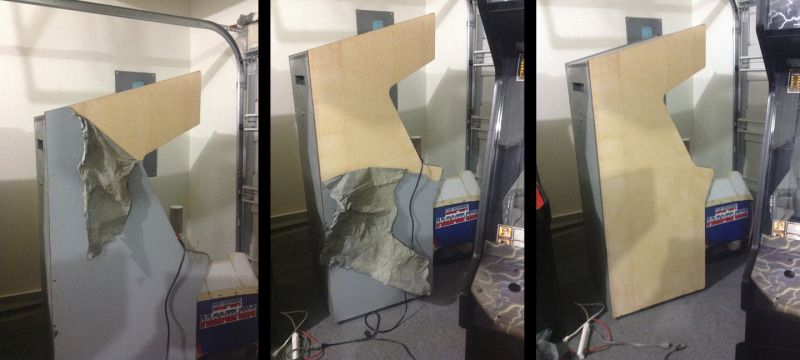

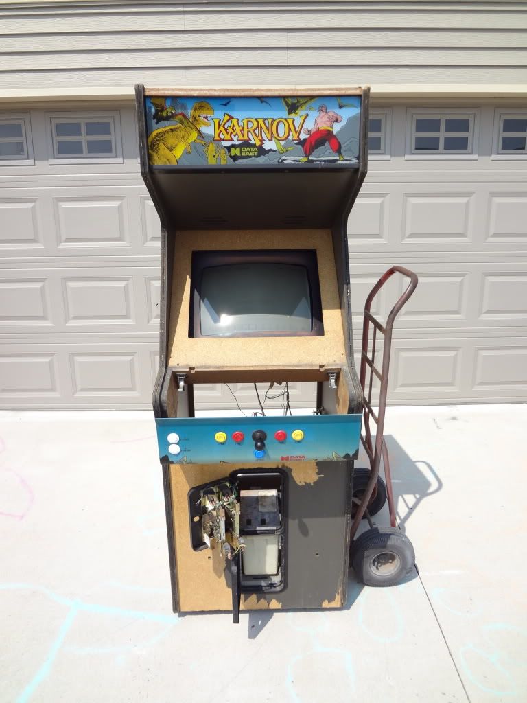

In between my Eyes and Punchout! projects I have been slowing working on rehabbing a Data East cab I picked up a while back. It's currently playing blind. I have scraped the vinyl off of one side and half off the front, but the other side is giving me problems. I've tried a heated decal scraper, a heat gun, citri-strip, acetone and just a sharp razor. Nothing is working. You can see the tiny area I have uncovered after trying for over an hour. This cab is also very musty and will need a good sanding, cleaning and sealing after all the vinyl is removed. Pics so far:

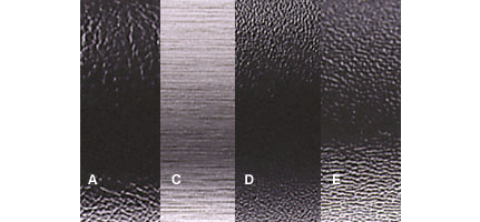

Does anyone know a good source for the dark gray vinyl Data East used? I checked Suzo/Happ but the only grey vinyl that they have is Sterling Royce Vinyl ('C' in this pic):
Which doesn't even look close. What would be ideal is a grey version of Happ's pica vinyl. But really, any dark grey vinyl would work.

The only thing about the DE vinyl is that it isn't pure grey. Based on my sampling on my cabinet there is about a 15% saturation of orange-red in the grey.
Edit:
My measurements came from florescent light, I loaded up Phet's natural light photos and and getting the same hue as my cabinet, but a lower saturation, more like 4% saturation. Anyway, the DE vinyl is not pure grey.

I spoke to Rich about the greys already. its a different type of grey. I need a matte look where 720
has a bits of silver in it and slightly glossy. We'll see. I just want it close as possible.

That's what I thought. Man, I didn't think it would be this hard to find grey vinyl.
You can find grey. It's hard to find a grey matte. All the greys I've seen are glossy.
I had to go into the automotive world.

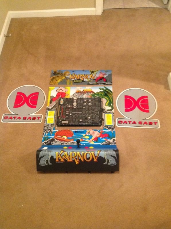

Yes. They are NOS but been through some serious temp changes. Found these bad boys in
A warehouse. I'm going to be careful with them when applying or just scan & vectorize them
and have them restored.

I have the same issue with the NOS set I have.
Tell you what phetisboy, I'll scan them at the end of the week & vectorize them.
