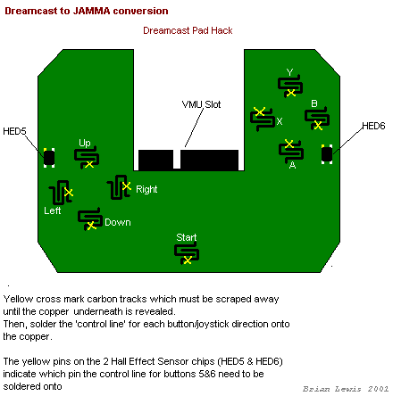

As for converting the controls, here are the solder points (including shoulder buttons):

I mainly want it for fighters but im for sure getting giga wing 1 and 2. thanks for the pic but where is the ground point on the controller

DC controllers have common ground...you can run a single ground to ANY ground on it, a ground would be the other trace for a button.
Lots of ground points. All common. I'd say take one off where the cable is connected to the pcb. Should be a nice big solder point right there.
