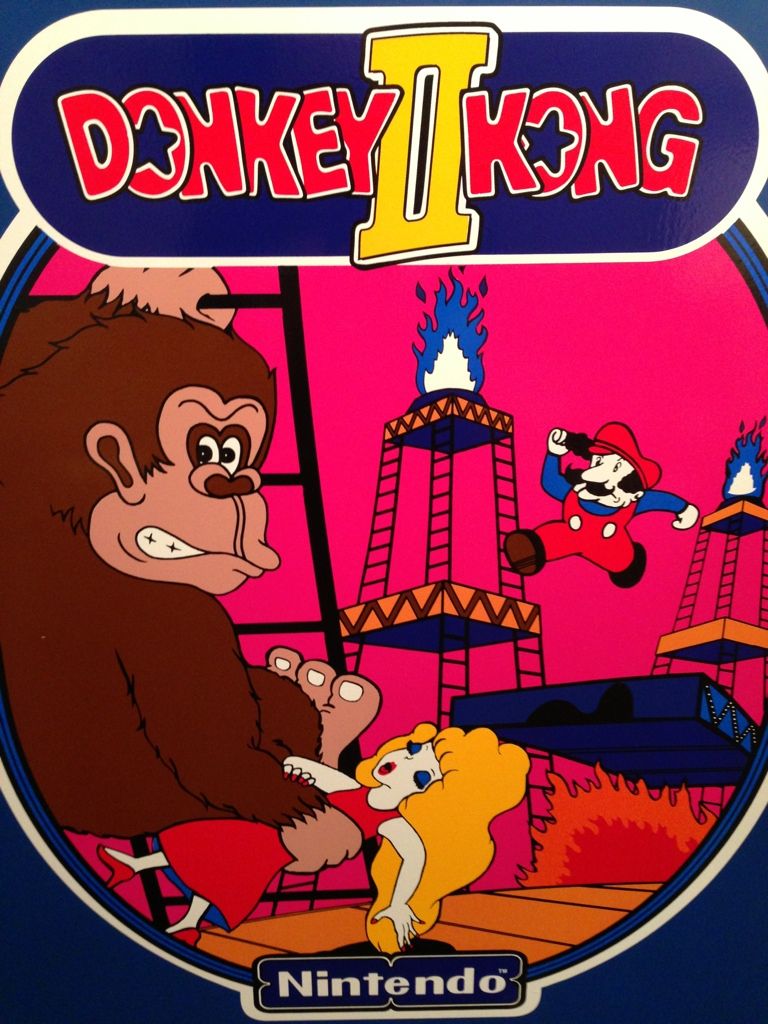

The custom artwork was ordered from thisoldgame.com and is absolutely spot on when it arrived. It's done with very high quality print and materials - it will look great when applied I think.

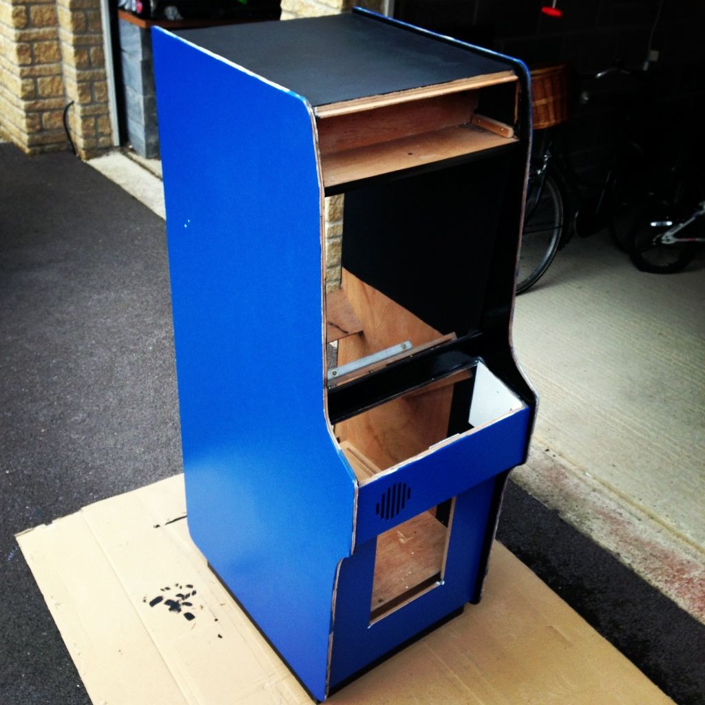

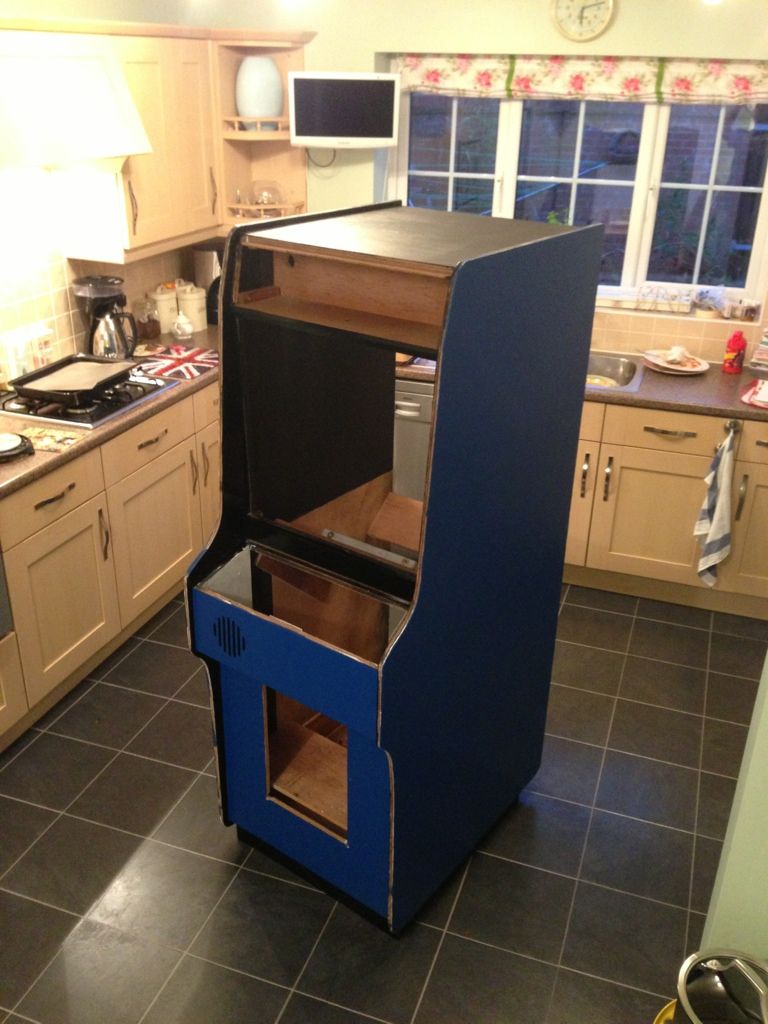

Cab was sanded and primed well over a month ago, today it was time to apply some paint!
The only thing that's changed is I've filled in some of the unused bolt holes on the side, that were there to support a horizontal monitor position. Couldn't see the point of leaving them in and having the bolts going through the side art, so there are now only two holes either side. Protocol apparently is to apply the side art, then put the bolts through the artwork, rather than try to cover the bolt ends with the artwork. With the removal of the unused bolts, I reckon it'll look much better when it's finished.
So the paint itself is specific to the Donkey Kong II cab and I managed to pick some up on a trip to the US last year as I mentioned earlier in the thread. It's a Behr Paint Blue Sapphire Sparkle colour, and the only place that does it is Home Depot. You need to get them to mix it for you in store while you wait.
(Clicky thumbnails gents, if you want more detail)
I sanded between coats with a light gauge sanding block to try to keep the finish as smooth as possible, and used a 5 inch small gloss roller. The paint itself has a satin finish, so it's not too harsh on the eye and not too reflective.
First coat start:
First coat on! It's gone on pretty well, but clearly needs more, as it's struggling to cover the white of the primer:
Three hours later, and after a light sand, I applied the second coat. Starting to look much better, but still pretty patchy. The hardest part is making sure you don't leave thick lines of paint from the edge of the roller:
Another three hours, another sand, and here's the final coat on:
I'm really pleased with the result. It's as smooth as it's ever going to be without spray work. There's a light patch on the bottom right hand side, but I think it's where it's still drying - I'll check it out tomorrow. Nothing stopping me doing another coat if needs be, but it's had three, so I can't imagine it needs more. I used a fine brush for the edging work at the front - it's not obvious, unless you are right up close examining that area of the cab - I think the satin finish of the paint helps with this. But my main concern was keeping the sides as smooth as poss, ready for the side art.
Later this week I'll get the black gloss parts done - only small amounts required along that inside edge you can see running the length of the cab both sides at the front. The top, rear and base will be vinyl wrapped in black - I reckon this is the easiest solution as the back is pretty tatty.
Managed to source a nice coin door from the US last month too, and just waiting on some buttons and switches for the Control Panel as mine are pretty beat up.
It's amazing how much more "cab like" it looks just with a decent lick of paint, so I'm really motivated now to get this finished soon!
More updates as and when I get my butt into gear in the coming days and weeks.
Decided to get all the painting finished a week later:
Revisited the gloss black, started again with it and ended up with a good result. I've done the rear and top of the cab using a matt blackboard type paint, and I'm really pleased with how that's ended up.
Anyway, all done - I've learned that I absolutely hate painting! It's now drying out in the garage.

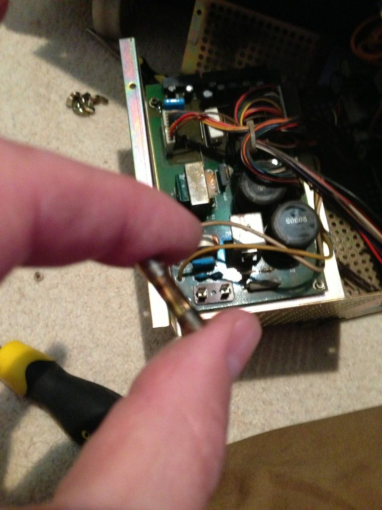

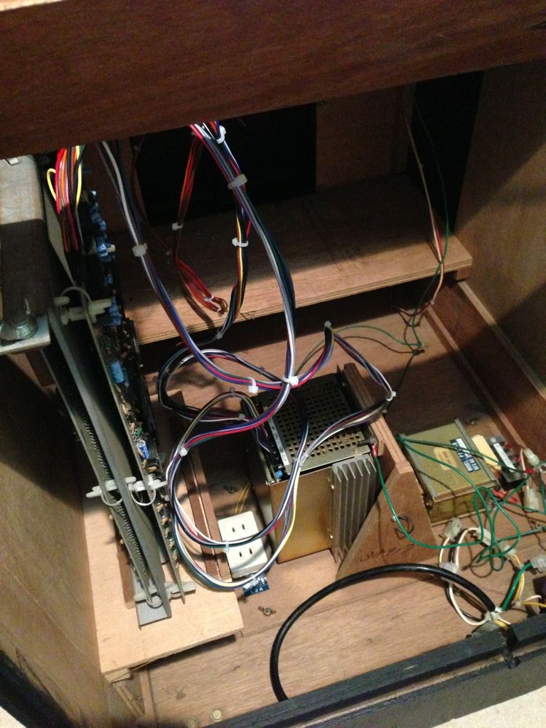

This evening I stripped down the power supply unit, and cleaned and tidied up the cabling which was badly worn in some places. Chopped a good length off the power cord too.
That's a before shot. It's all cleaned up and ready to go.
Another job for tomorrow is the monitor. Need to clean that up and sort out a black bezel from somewhere. The monitor itself is caked in some sticky crap around it's edge where the bezel was stuck to it.
In the home straight now...
Forgot to say that yesterday when I was cleaning up the Power supply, it became obvious that there was something rattling around inside it. I gave it a good shake upside down, and out fell an American quarter dated from 1992 - which would suggest the cab had at least a ten year life in one guise or another. Stuff like that makes this hobby interesting.

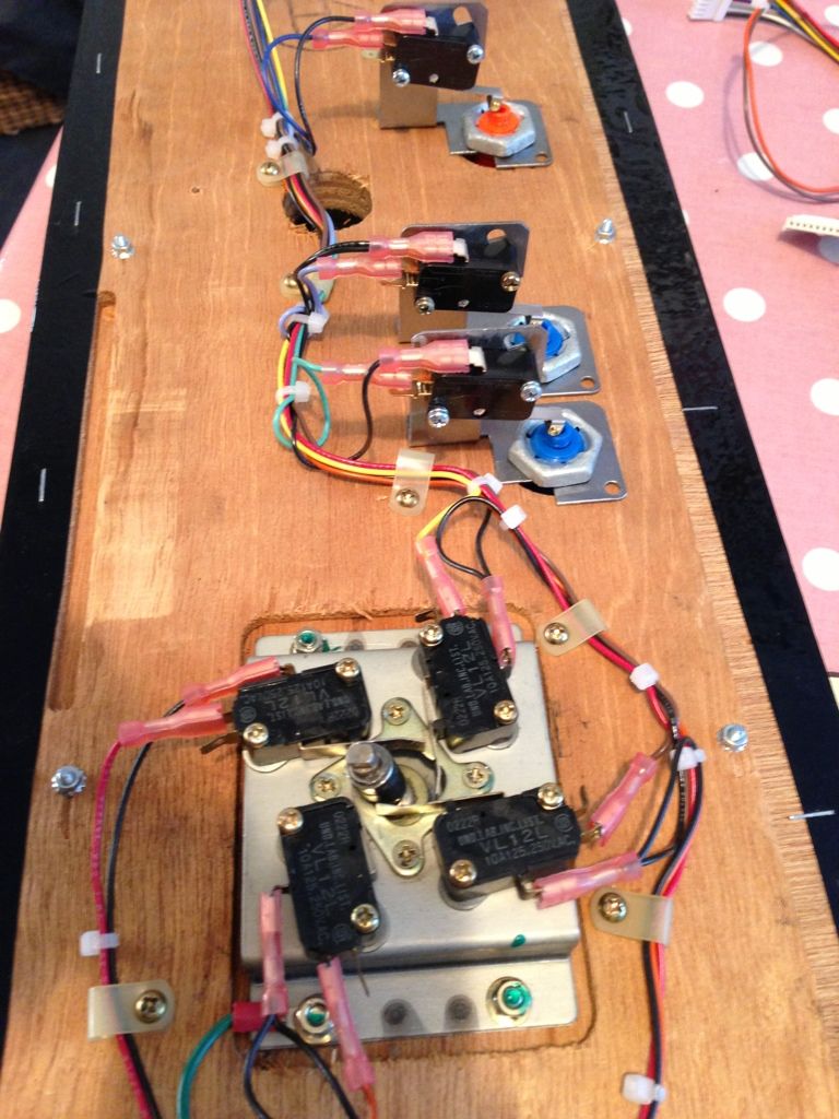

Anyway coated the control panel with glossy black vinyl this morning, and as planned, wrapped it round the back. Used a staple gun on the back to secure it firmly. When I'm ready to apply the t modling on the front, I'm going to slice through it along the groove - this should help hold it in place as well.
I managed to secure one of the repro harnesses made by Dokert. I've had this since January waiting for me to get my arse into gear with this cab! These are really well made harnesses - his work is first rate. A lot of care and attention has gone into it.

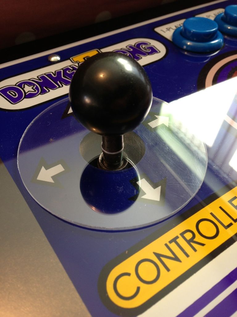

So I populated the panel, bolted on the new plastic overlay, and assembled the joystick (having now been scrubbed clean to within an inch of it's life) - it looks a lot better now. Added the new Nintendo buttons, button holders and applied the new loom to the control panel.
Here's the back of the joystick:
And here's the rear of of the control panel with loom and various bits of kit:
Because the harness is bespoke built for the cab, there's no wastage, so it's nice to look at the loom in place, as it all fits so well and looks a lot more compact and neat than the original Nintendo one.
One nice part I sourced is the joystick protector, which is basically a clear plastic o-ring that sits under the joystick protecting your fingers from the hole underneath, and presumably prevents the CPO from getting scratched through play. I ordered it for 50 cents out of curiosity when I sourced my buttons. I've not experienced one before - a great idea. Here it is fitted:
(Edit: decided to remove this clear o-ring after a while, as I noticed it was scratching the CPO underneath)

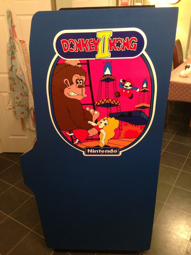

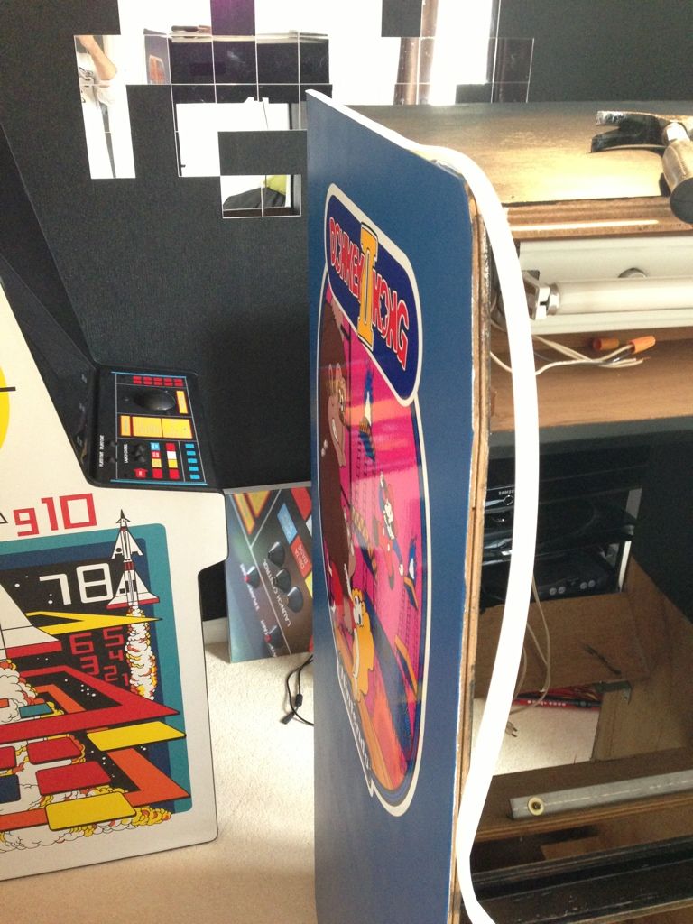

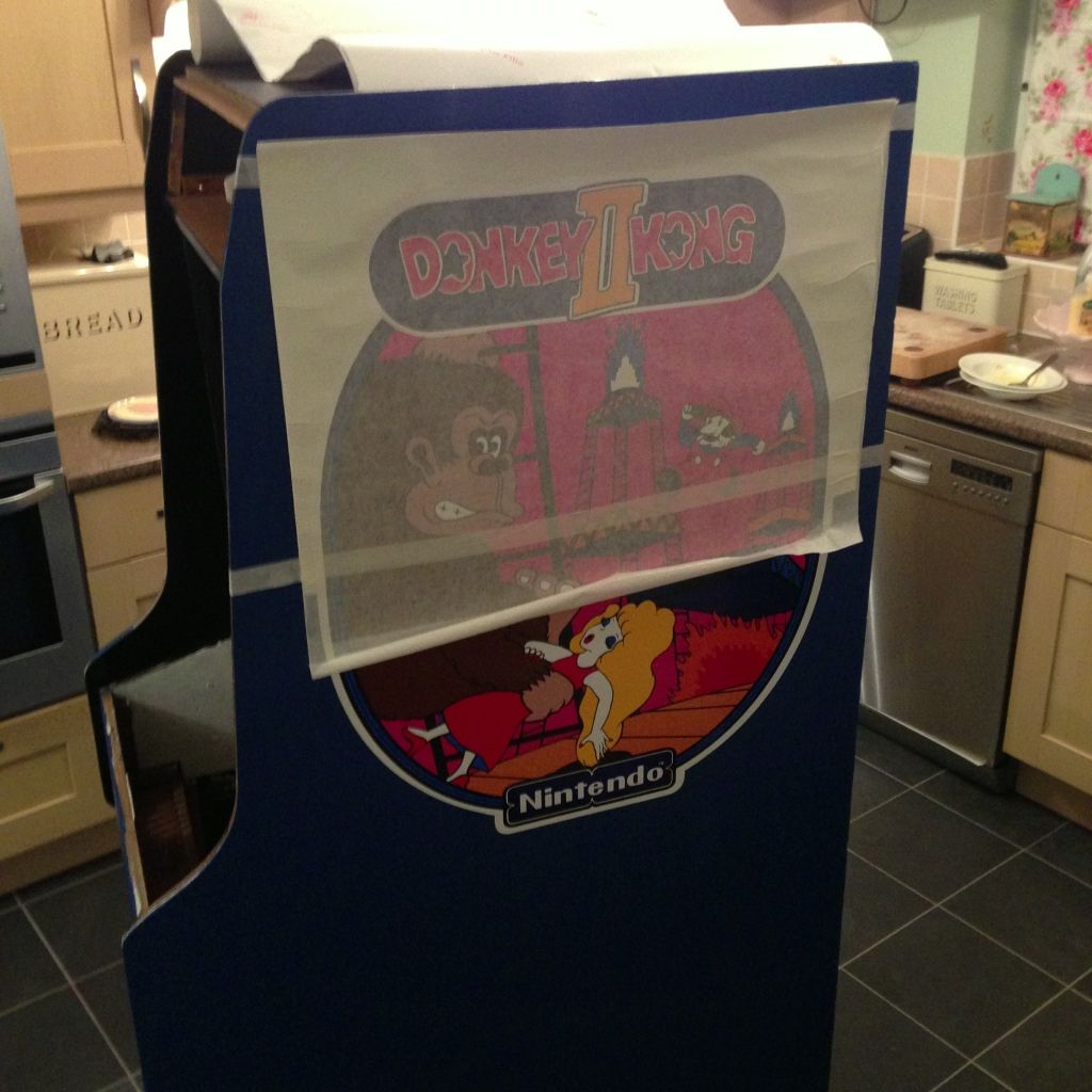

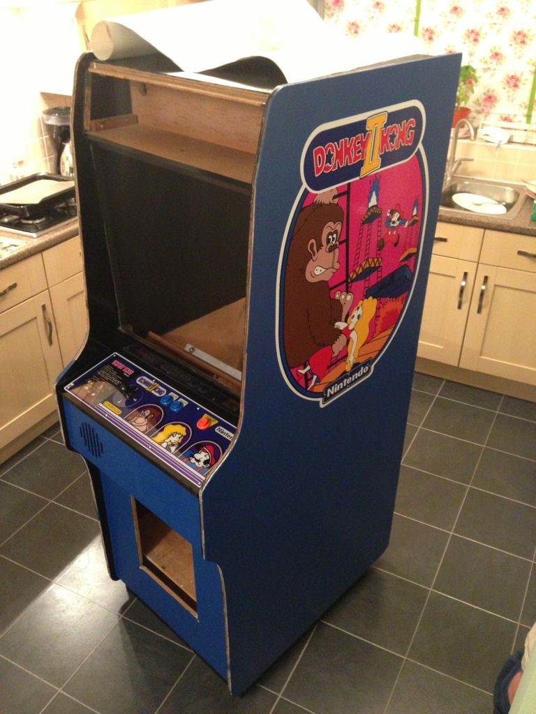

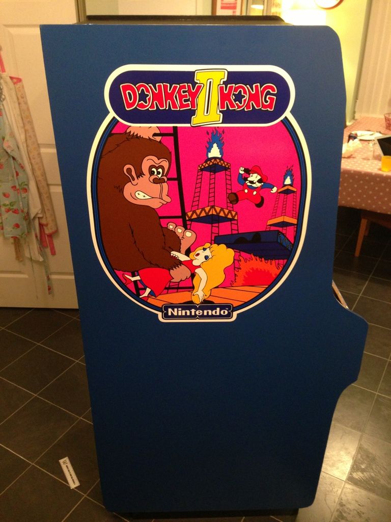

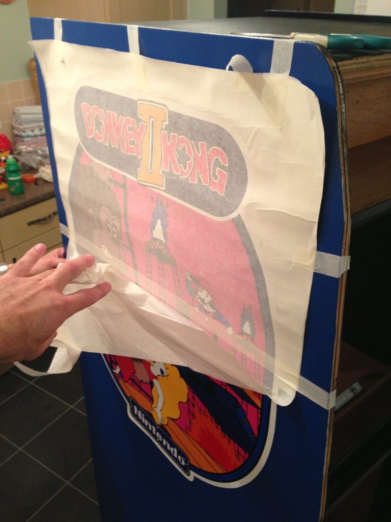

It's sideart time!
1. Bring the cab into the house, remembering to carefully negotiate around "The Warden". Don't worry, her bark is worse than her bite.
2. Measure up your artwork and decide where it's going to go. Tape it in place with masking tape, with a long piece across the middle. Remove backing from the bottom up to the middle of the art, where your long piece of masking tape is, and cut off this bottom part that's now unattached from the artwork. Then carefully start to squeegie from the middle, down and outwards. Notice there's another layer of paper on top of the art, to allow a good amount of pressure to be applied without scratching the artwork. Once on, you can peel off the protective paper to reveal the shiny art underneath:
3. Remove the centre strip of masking tape, and the top half of the backing. Squeegie from the middle, up and outwards. Et voilà:
4. Repeat the process on the other side, taking measurements from the side you've just done, to ensure their positions match:

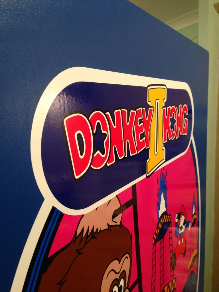

5. Step back, admire your handiwork:
I was surprised at how easy this was. Take your time, use common sense, and all is well. What I do like is the way the contours of the paintwork subtly show through the sideart in certain lights. I think I prefer this to a sheen, flat art, as any imperfections can be forgiven when there's some texture there. This is down to the roller technique I opted for on the paintwork rather than spray:
That picture above makes it look very uneven, but it's actually very smooth to the touch. Here's a closeup of the art:

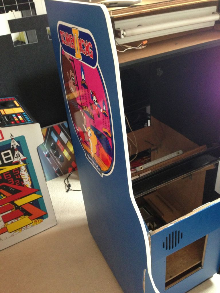

So all done. We got the cab up the stairs to the gamesroom without incident, ready for marquee, lights, boards, wiring, metalwork, PSU, bezel and t molding. Should be all done sometime over the weekend.
Time to start populating the cab again. Various small jobs to get closer to the end result:

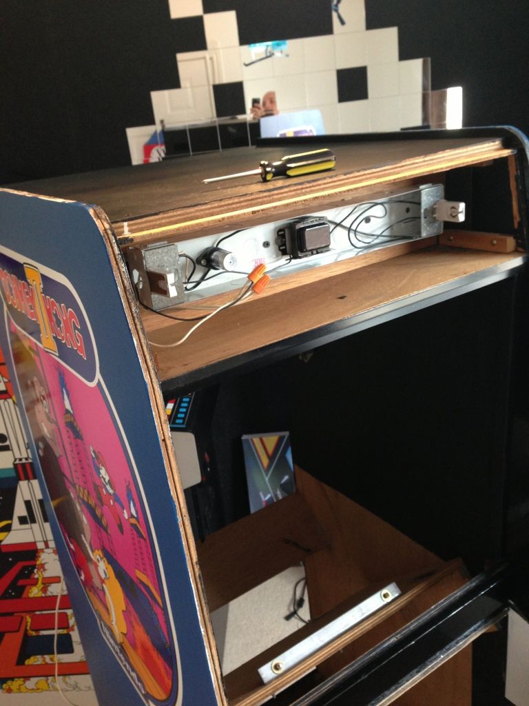

Marquee light back in:

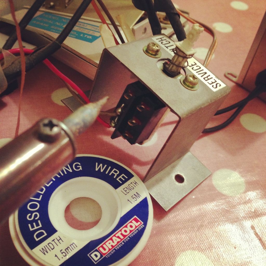

De-soldering the old loom where it needed it:

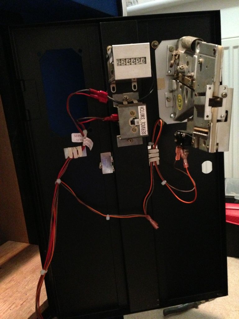

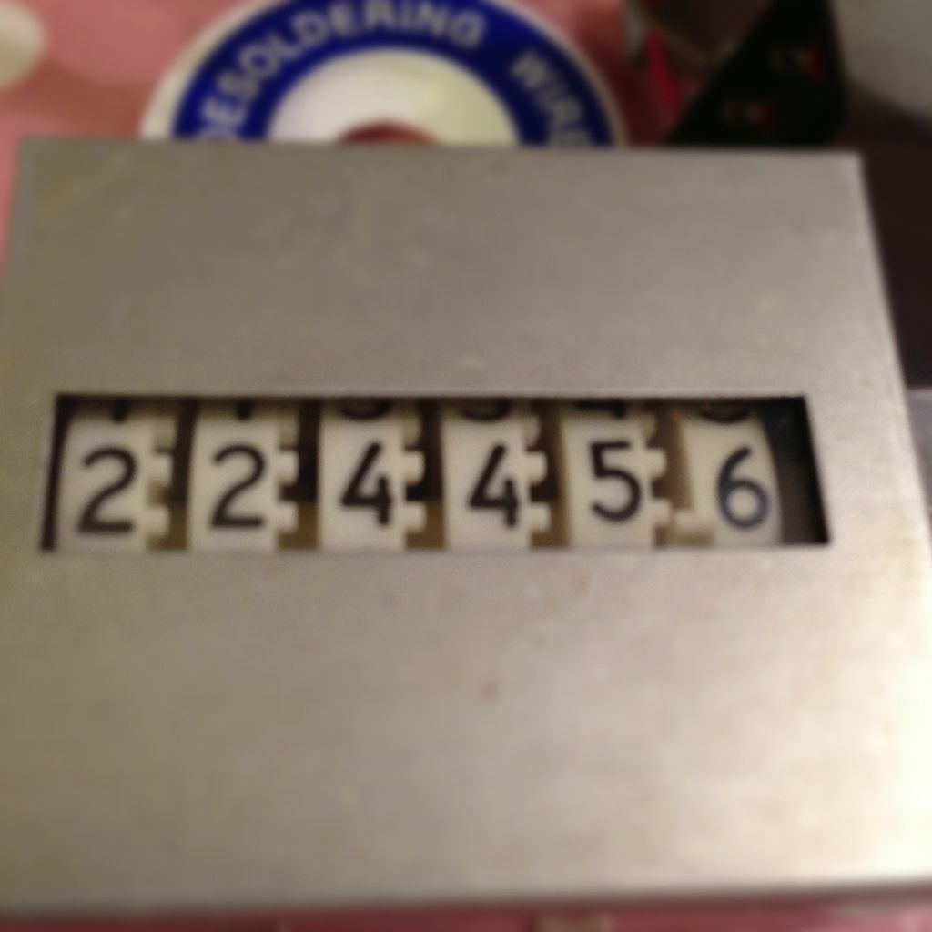

Populating the replacement coin door, with cleaned up counter, mech and service switch:
On that subject. I paused to reflect the fact that this machine has had nearly a quarter of a million plays:
Assuming each of those coins were quarters, you can assume that this machine has taken $56,000 during it's life. Presumably most of that was in the early 80s.

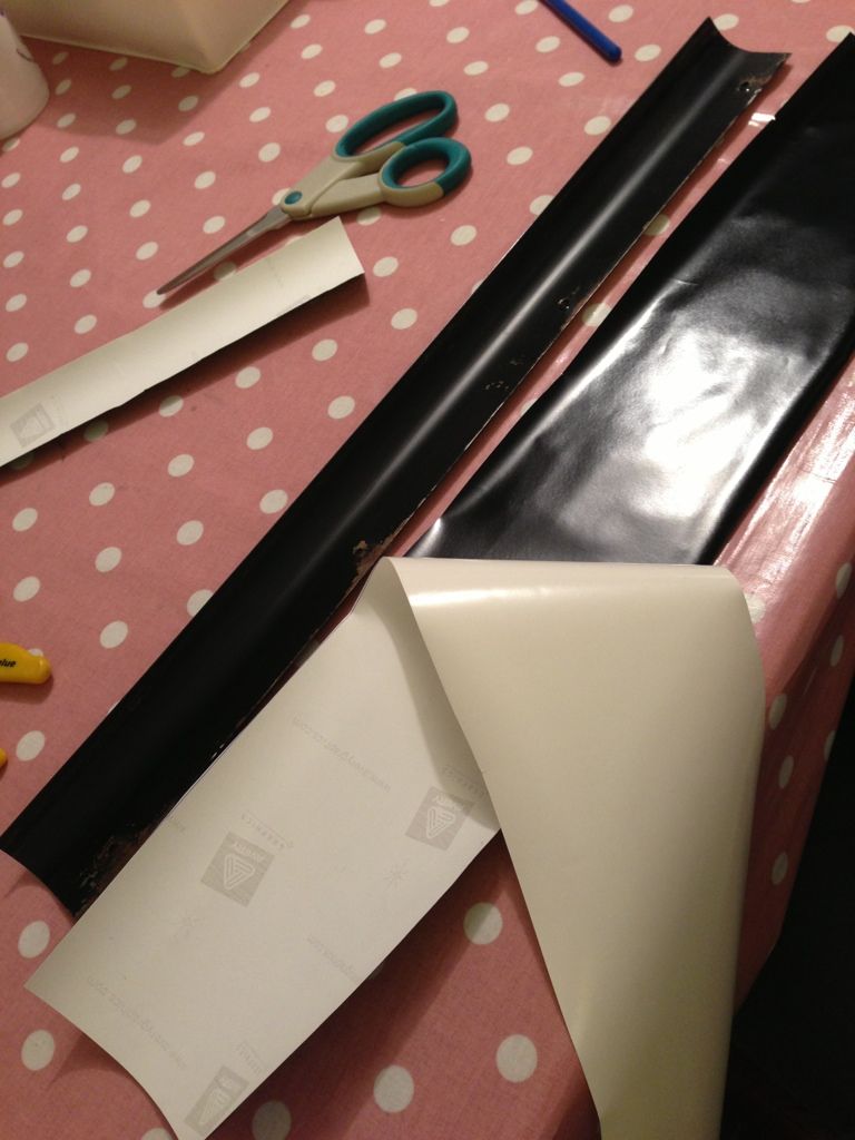

Used a smooth black vinyl to cover the metal work that holds the marquee in place:

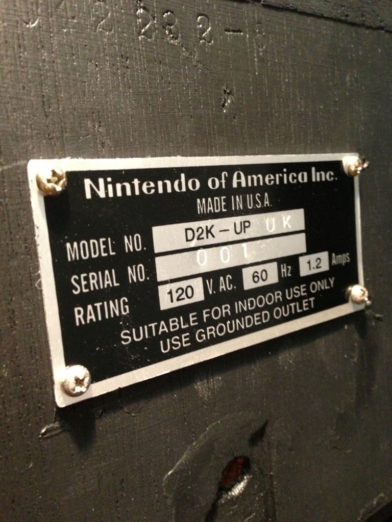

And the new identifier plate. Notice the serial number (this is the first DKII kit shipped outside of America):

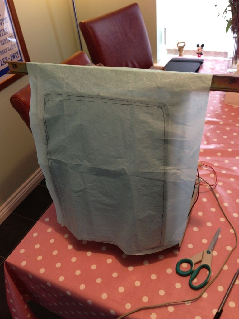

Next up was making a cardboard bezel. I used tracing paper to make a template, then cut round using Stanley knife:

One blown mini 4A fuse. I reckon this was blown when I had the disaster with the monitor a few months back and we managed to wire it up wrong.
Do I have one lying around? Of course not!

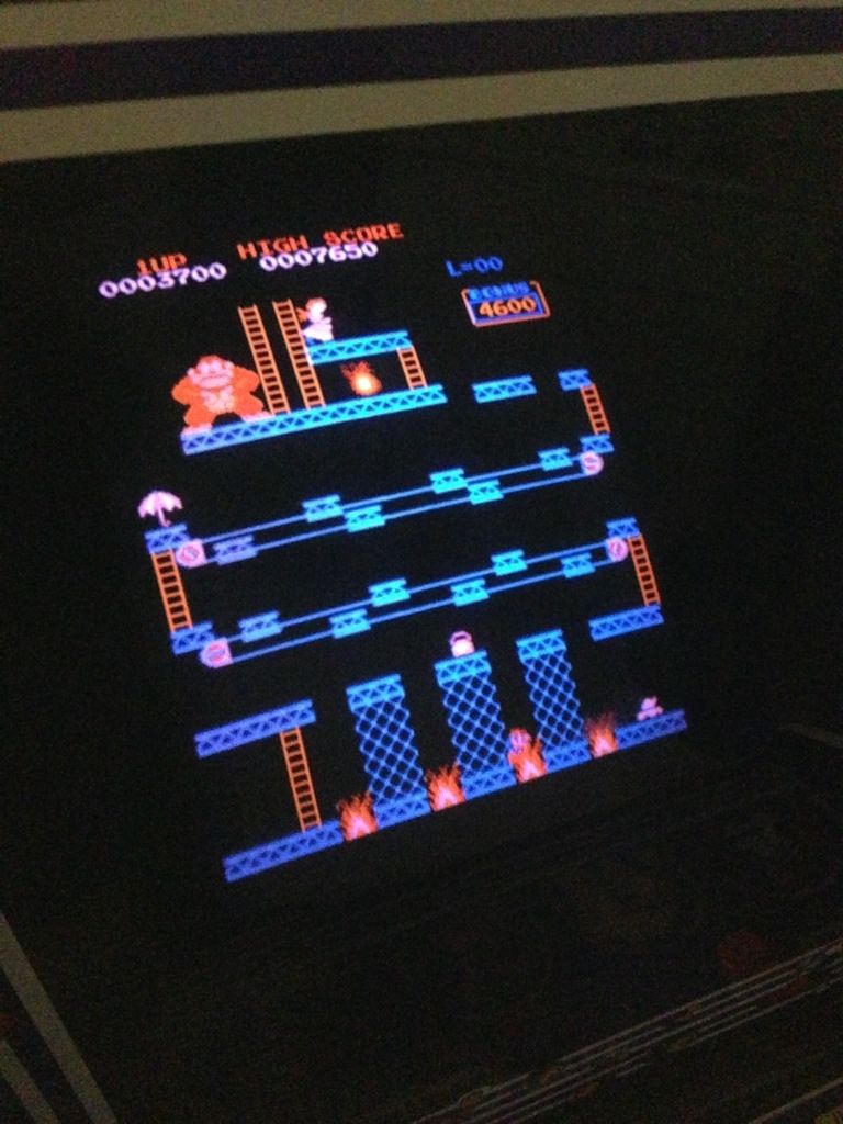

So no working DK2 fun as yet. However, here's some shots of the finished article. There's a few details left to complete the job, but it's pretty much there. The fully working shot will have to wait until tomorrow night when I've gone fuse shopping - assuming that's the problem of course.

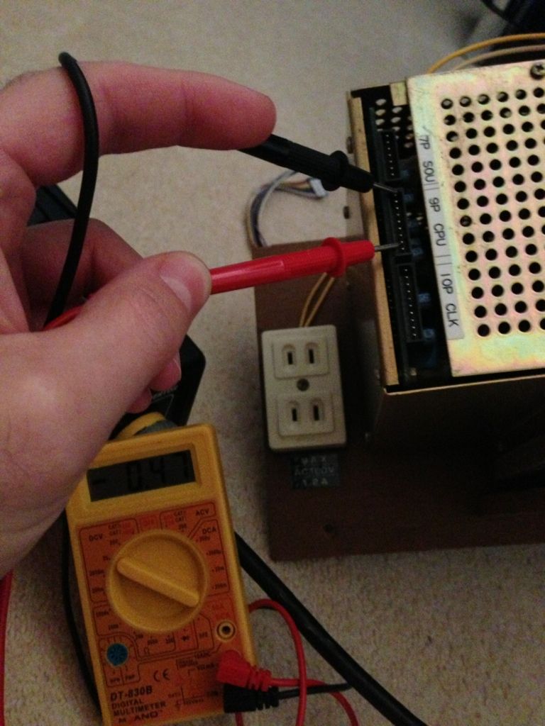

So I had a nightmare with the PSU. The fuse kept blowing, I replaced a few parts, but it became clear I wasn't going to be able to repair it with my limited skills, so started to hunt down a replacement unit. Luckily, a forum member came up with a spare and was been kind enough to loan it until I found one for myself - which was really good of him.
So it arrived today:
I thought I'd best check out the voltages before plugging my board in. You like my one handed technique? The things I'll do to get a photo... Anyway, everything was fine:
So I plugged in and after realising I'd forgot to connect the video cable to the monitor, we had signs of life!
All good. The monitor is throwing out a pretty good picture. The chronic burn on the screen doesn't show up when the cab is on, and the warm glow of the CRT just suits the cab and game perfectly.
The nice thing about this rom add on, is not only do you get the new levels of DK2, but holding down P1 and P2 buttons at any time, gets you back to the original Donkey Kong game. In addition, it adds a freeplay option which wasn't in the original code - plus all the dip settings are on screen via a menu which can be accessed at startup.

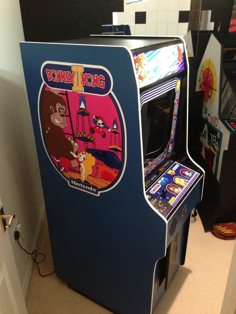

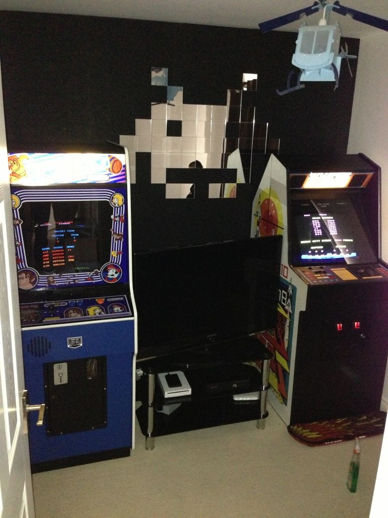

Shifted things around, got my power sorted. This is how the games room is looking now.
The space invader on the wall is made from lightweight acrylic mirror tiles, stuck on the wallpaper with double sided "no more nails" tape.

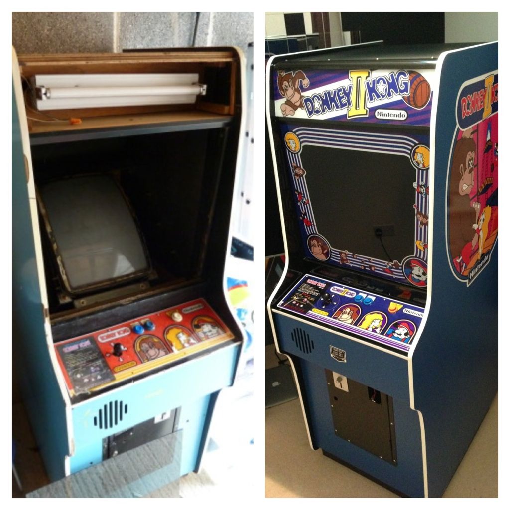

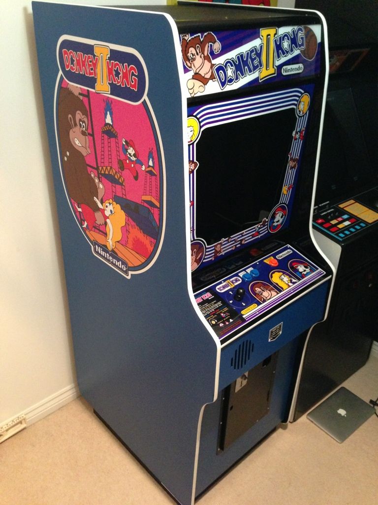

Anyway, here's a before and after shot of the cab:
Small but significant update. Been after some nice coin slot fascias, but they are very difficult to track down over here in the UK. Thanks to a forum member on a forum over here who is a metal worker, I now have two shiny new repro ones. He even engraved them with the D2K logo. Got them fitted tonight.
They look absolutely superb and really set the cab off.
The cab is complete, I'm planning on taking some proper high res photos of the cab and will post them when done.
