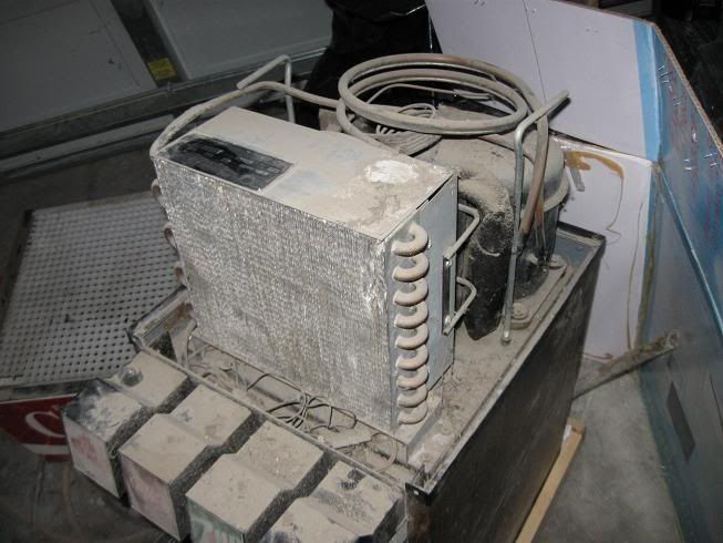

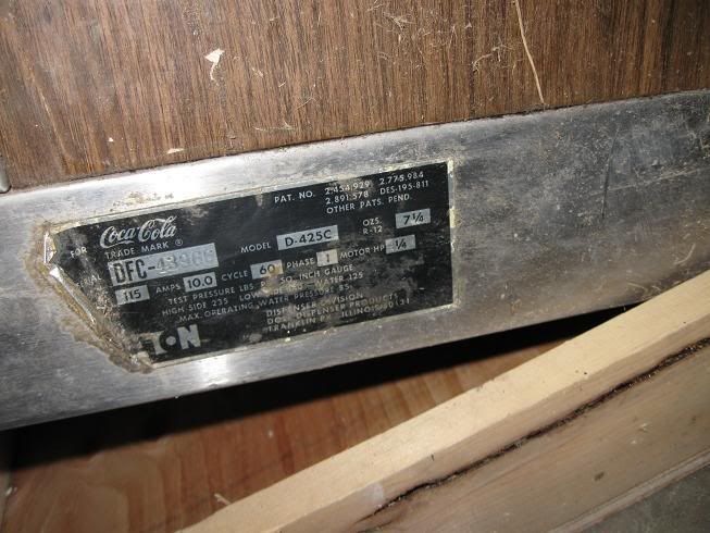

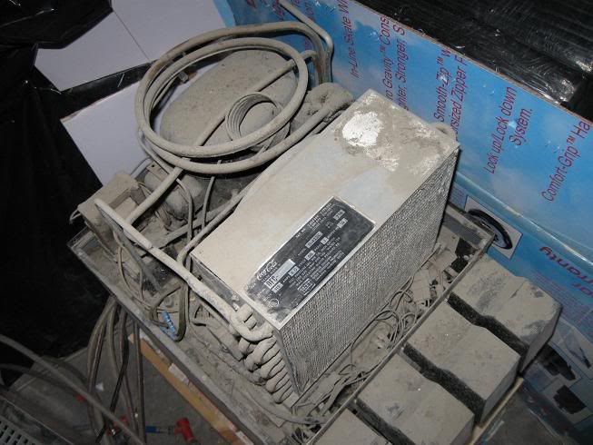

Anyone know where to find a manual for a D-425C? I can't seem to find any info for it online, but that is clearly the part number on the sticker on/in my machine.
It has been sitting for a few years because it didn't work, but when I opened it up, I found a butt connector that had one of the wires pulled out of it. I plan on resoldering that, but would like to pick up a manual/schematic for it as well.
I am a bit confused as it has 4 flavor lines, plus one water line in, but I don't see a CO2 hookup. The syrup tanks have CO2 bungs on them, but I don't see how those would carbonate it properly.
Any info would be great!

Looking at your pics again, I see a reference to water pressure on the label. You wouldn't need a water source for pre mixed tanks...

Are these valves specific to this industry? I seem to have gotten everything working in the machine. The cooler comes on and works, the solenoids at the heads work, all the switches seem to be correct.
I think the next thing to do is put water in one of the tanks and pressurize it to see if it comes out. To do that, I need the mating valve, and I have never seen that kind before.

I believe that I have a post-mix setup.
1. I have tanks labelled post mix only. The hoses come off of them and go directly to one side of each nozzle.
2. I have a water hose that goes to a tank with a chiller and a compressor (appears to up the pressure on the water outlet to a constant value)
3. The outlet from the water tank goes to the other side of each nozzle.
4. The nozzles each have two solenoids, one marked syrup, one marked water. The syrup one also has an adjustment screw.
My largest confusion is that I do not have any CO2 inlet other than the CO2 bung on the syrup tanks. I assume that means I am carbonating the syrup there, and mixing it with the chilled water at the nozzle, and dispensing it.
From the research I have done, it seems like this would mess up the amount of carbonation in the final drink, but perhaps that is just a matter of setting the CO2 pressure correctly. The tanks do specify a CO2 pressure, but I do not remember it off the top of my head.
The parts list for the Lancer CED500 looks just like the guts of my machine, and its manual makes reference to "BIB" or "FIGAL" connections. As I understand, the BIB is bag-in-box and the FIGAL is the tanks, but the manual does not say anything about the carbonation and/or CO2 connections.
The only carbonator they sell carbonates water.
Huh, well I've never heard of carbonating syrup only. Normally in post mix they carbonate the water- and I thought the water was supposed to be chilled in order for the co2 to mix in properly.
You might be able to get assistance from the parts supplier.
Well, there is always trial and error.
Lancer was about the opposite of helpful, but I think I found the missing piece to the puzzle.
I think:
I am missing the carbonator. The water should be carbonated when it goes into the chiller. The CO2 pressure on the tanks only serves to push the syrup out into the machine where it is chilled and combined with the water.
Does that sound right? If so, it makes sense why there is a different connector on the water line and why the Lancer manual doesn't say anything about the carbonation. It also makes sense why the Lancer manual says the same machine can be hooked up to FIGAL or BIB, because that is just the syrup source.
Seem reasonable?
