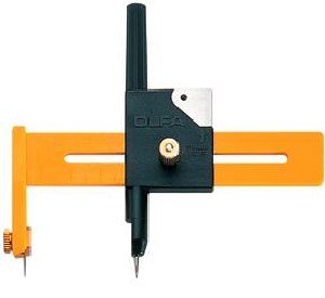

I use one of these...
Bought it a few years ago when I was into RC cars, I used it to cut out the wheel holes in the car bodies.
