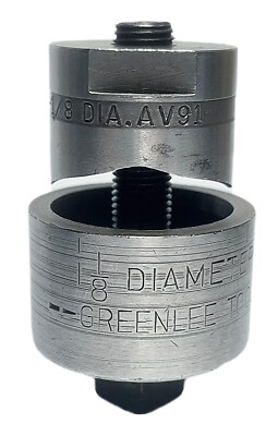

Wondering if the Greenlee 1-1/8" punch would cut through a cpo nicely...? (I honestly don't know) But it makes the cleanest edged holes in metal, and is super easy to do.
If I remember when I get home today, I'll try cutting through a thin piece of steel with an overlay on it to test...
This kinda thing, but I wouldn't buy this one, shipping is waaaaay too high... I paid $30 shipped for mine a few months ago.

All great suggestions... I had a custom CPO made for Ikari Warriors to use on a repro cabinet that is something other than a Dynamo HS-1. I aligned the CPO approximately where I think things should line up on the blank metal panel I had purchased for this project, then clamped it down to the CP onto my workbench. I then used a countersink punch and marked the dead center of each location where I think a button should be, as well as where the joystick should be. I was able to fit this onto my drill press for MOST of the holes, except for two, so I made the small pilot holes. I ordered one of those Greenlee punches that @jawhn linked to, but, for $30 shipped, as I already had a kit of the harbor freight ones, but they did not have a 1 1/8" hole size in the kit. I'll enlarge the holes and use the punch once it comes in.
My conundrum with this was that I needed to figure out a way to transfer the button/joystick locations onto the metal control panel before I drilled it, so the countersink punch was the key.
