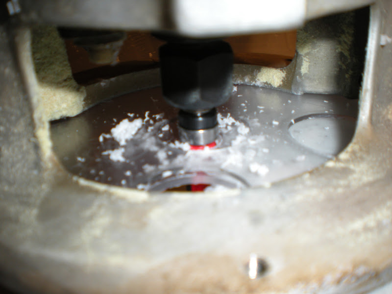

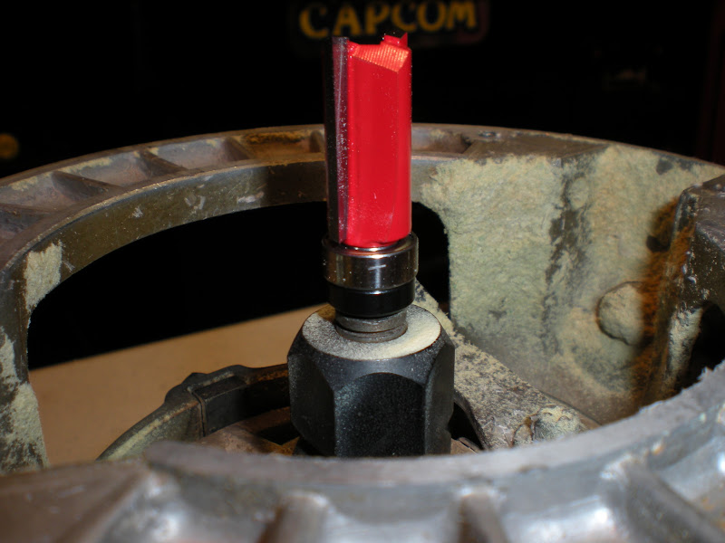

I picked up one of those laminate trimmer bits and used a router. It worked great, you just have to be very careful of the height, I cut a little extra in a couple places, but they are covered by the buttons. My router's height slips so I had to keep adjusting.
Here is the bit:

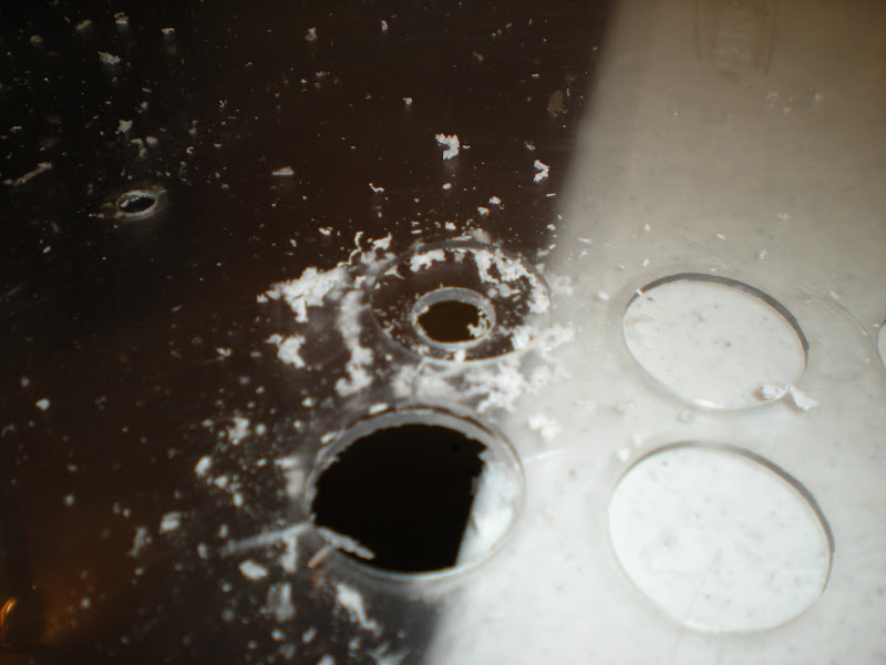

I drilled holes 1/4 inch the same size of the bit. You can see a hole that was routed in this photo:
It is important that the bearing line up with the original plexi:

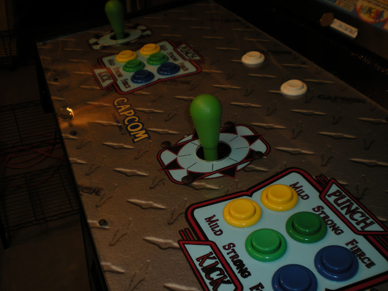

Here it is installed, looks so much better than the cig burns and spider crackes!
Hard to really see ing photo, here is an angled shot:
The only downside of this method is that the bit was $25. But I am sure I will reuse it in the future.
Looks really nice, glad that it worked out well for you. Maybe it's just the angle but does the P2 stick go all the way into the down position w/o hitting the edge of the plexi? Again, probably the angle, but the stick looks a bit off-center.
