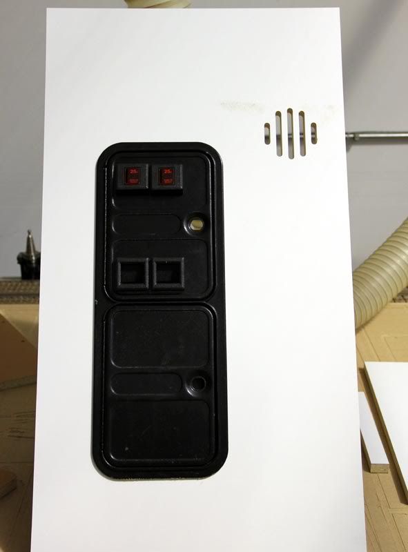

Coin door is mounted to check the fit. There is a smudge on the board from the tape they used to hold the $5 sale tag which I will clean off. The mounting holes for the speaker are already pre-drilled on the back.

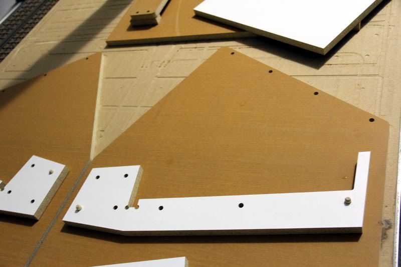

The inside of the side panels are shown here with the matching monitor/CP mounting structure. The dowels ensure perfect alignment and a rock solid connection when they are glued in place. The panels will be painted black on this side before it is assembled.

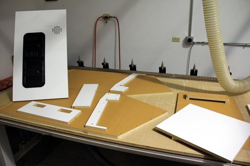

Here is the first batch of parts cut and ready for the remaining parts. The CNC router makes fast work of them.
