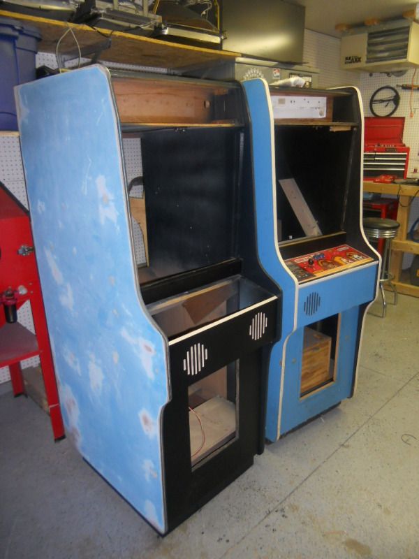

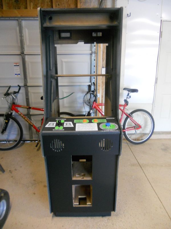

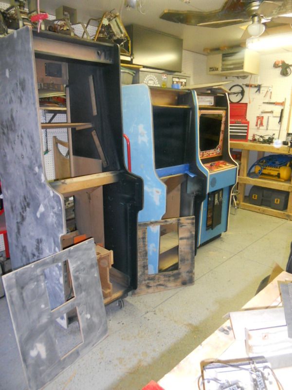

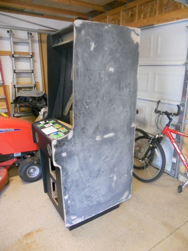

This is whats in my workshop right now. I started with a Punchout and a blue Nintendo cabinet. The Punchout seemed to have been dropped out of a truck and was falling apart. I reinforced it and am in the process of a full restoration. I have the bondo and sanding done as well as making a new pedestal and painting all black on the top, back, and inners. I had all metal powdercoated.
The blue Nintendo cabinet (Middle one in pics), I bought gutted from chips4sle last Summer. I think it was a DK at one point, but empty now. I have a multi idea for it for my arcade. I have the Bondo applied, sanded, and all black paint done on the top, back, and inners. I made a new pedestal and had all metal powdercoated for this as well.
The other cabinet was a dedicated Hogans Alley that I picked up on Craig's List last weekend. Its also empty. I just dug out a Donkey Kong bezel and control panel to put on it. I have a friend who wants a 60 in 1 and this cabinet is perfect for that project! Other than putting the marquee and bezel on, I haven't done anything to it yet.
I'm hoping to have these dome by the end of July. Here's where I'm at:
Here's kinda where I started:

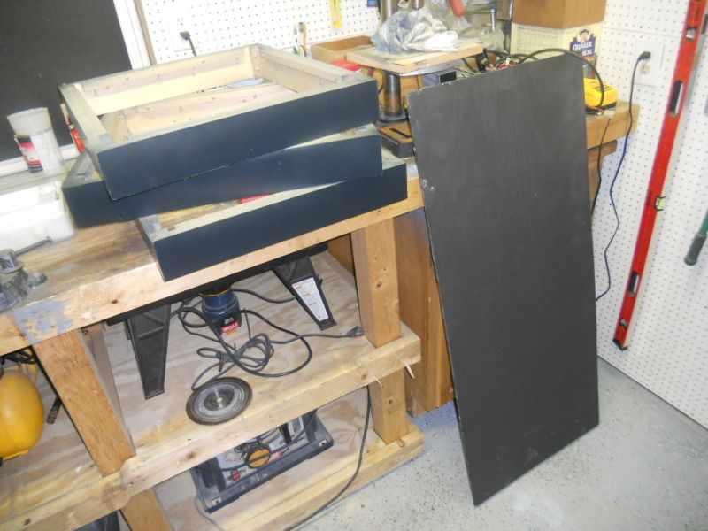

Thanks. And yes, that's a side of a trashed Star Wars cabinet on the ceiling. I made a little more progress this weekend. I cut a back door and painted the bases:

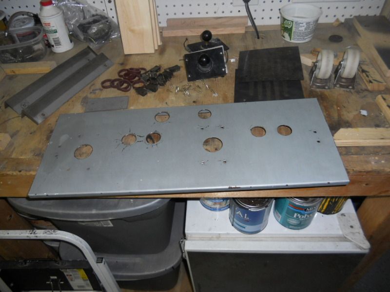

I found a Nintendo VS control panel in my attic that'll work perfectly for my blue Nintendo idea. I removed the old CPO and media blasted it:

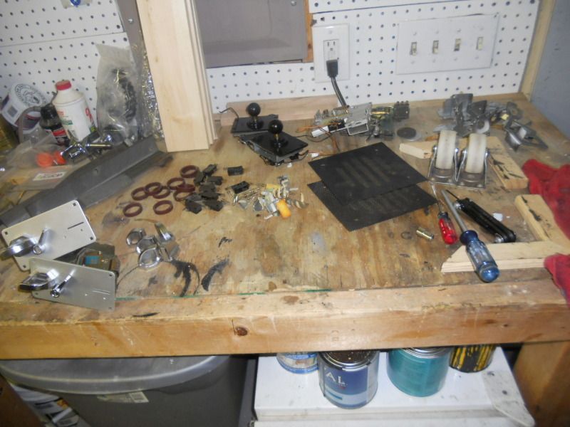

I dug around in my parts and found a ton of switches, button mounts, joysticks, PAL nuts, monitor mount brackets, coin mechs, and misc other parts I'll need:

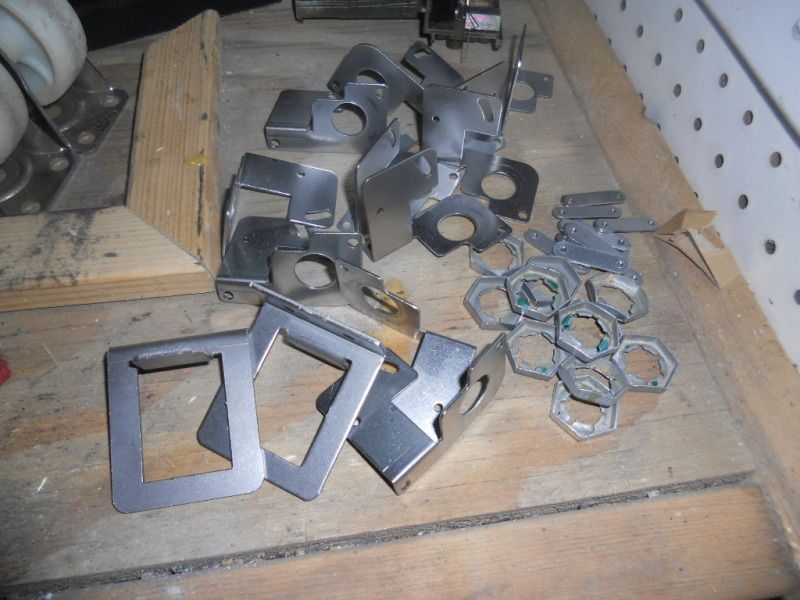

And I was alble to disassemble, clean, and polish the PAL nutsbutton mounts, and CPO mount brackets:

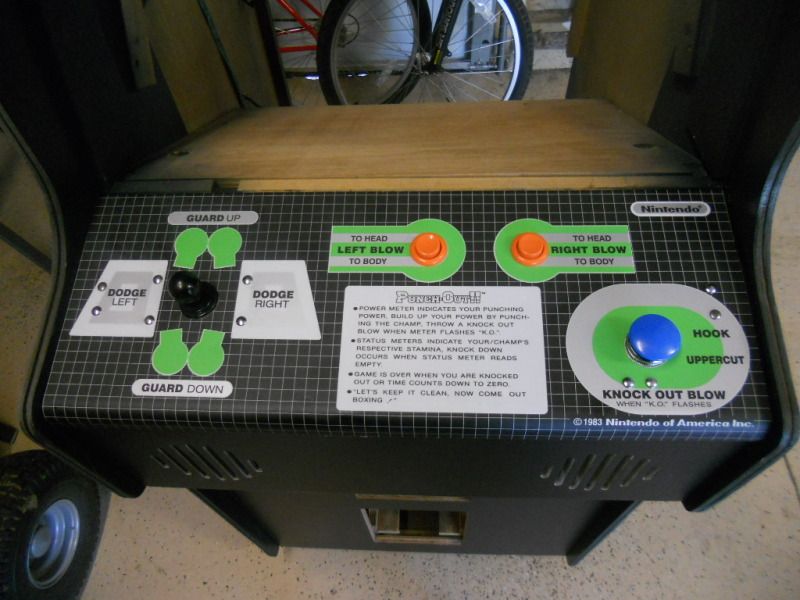

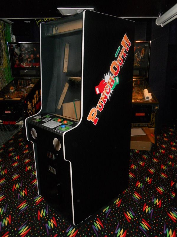

I made some progress on my Punch Out. I ordered black vinyl from ThisOldGame. I was able to do the front panels and secure them. I will get the sides once it is in my basement. I don't want to risk marring the sides. I also finished the control panel with a new overlay and buttons. I'll be recapping the monitors and rejuvenating the tubes this week. I'm also plugging away on my othert Nintendo project. Here's some quick pics:
Thanks for the offer, but I had a local plastics shop make me one. I was hoping to have my monitors capped and rejuvenated yesterday. My desoldering gun wasn't sucking the solder up like it should and I had to order a new tip. I'm hoping that I'll have it by the weekend. My front speaker panel came today for my regular Nintendo cabinet and I was able to get that on and the vinyl applied to the entire front of the cabinet. I also put the vinyl, sideart, and powdercoated coin doors on my Punch Out. I'm making progress. Here are some pics:

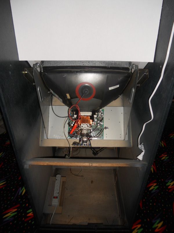

I brought the cabinet down to my basement arcade and put it together. I had a new Vision Pro 19" CRT monitor sitting here that I had no immediate plans for, so I dropped that in. I wired the control panel and pinned the Molex connectors. I picked up some mat board and used that to replace the crappy looking original monitor surround. I put some white T molding on. Now, I'm just waiting for my friend to drop by with the computer. He's setting it up (MAME) with all of the NES games. I'm thinking about adding a gun still, but other than dropping the computer in - IT'S DONE!
