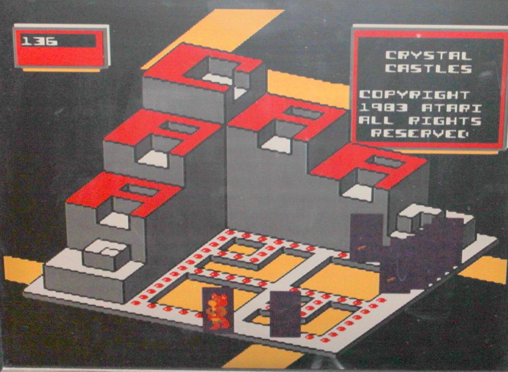

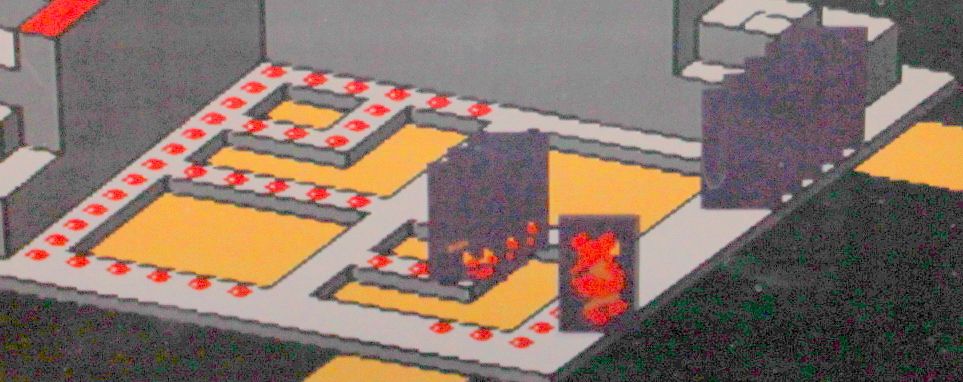

Hey gang,
Board played fine this morning. Then I came back this afternoon to this little surprise.
Black boxes are behind the character sprites. How do I make these go away?
Board passes the boot RAM and ROM tests. And board passed the Rom test in Test Mode.
Any ideas?
Thanks!

it's not a ROM issue or a power issue. usually there is a circuit that takes the sprite and the background and decides which pixel to draw. sprites are rectangular so the parts of the sprite that should be "transparent" and let the background be shown instead.
in this case that circuit is always choosing to draw the sprite, even when the part that should win is the background. I haven't looked at a CC for a while but that's going to be somewhere after teh video ROM in the circuit thats in common with the path of the background circuit.
Are you talking about the motion-object buffer circuit?
http://arcarc.xmission.com/PDF_Arca...stles/Crystal_Castles_SP-241_2nd_Printing.pdf
I'm thinking either 11A or 9A.
Gonna try 11A first.
