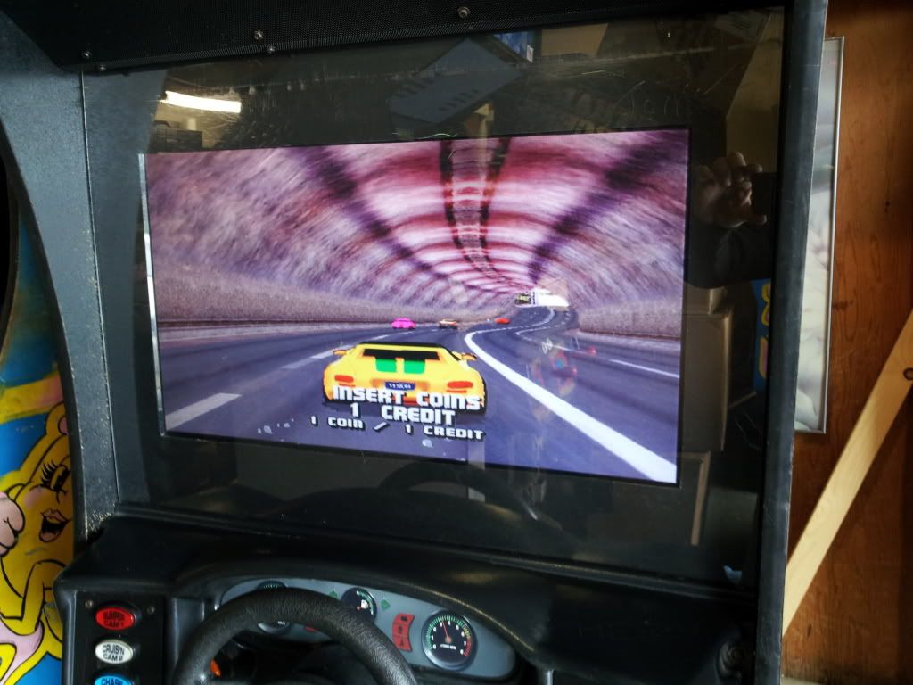

Wow, this thread wont die!! As the thread starter a couple years ago, I just wanted to update that it is still working flawlessly, absolutely not one problem. Screen has always powered right up, converter board has done the same.
In my experience, any old crt medium rez monitor would have needed some attention in all this time, and I also think this LED screen picture is 150% better image.

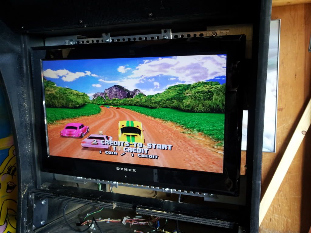

Today I installed my LCD in my cruisn sit down. It powers on and holds the VGA setting as needed. I had to adjust the clamp as mentioned and then picture looked great. Got it mounted in, still need to finalize the install. I got a converter board that came without a power cord, just soldered a wire on and ran it to the +5 . I had the game running next to a stand up cruisn with a rebuilt Neotec and the side by side comparison really showed how great the LCD looks.

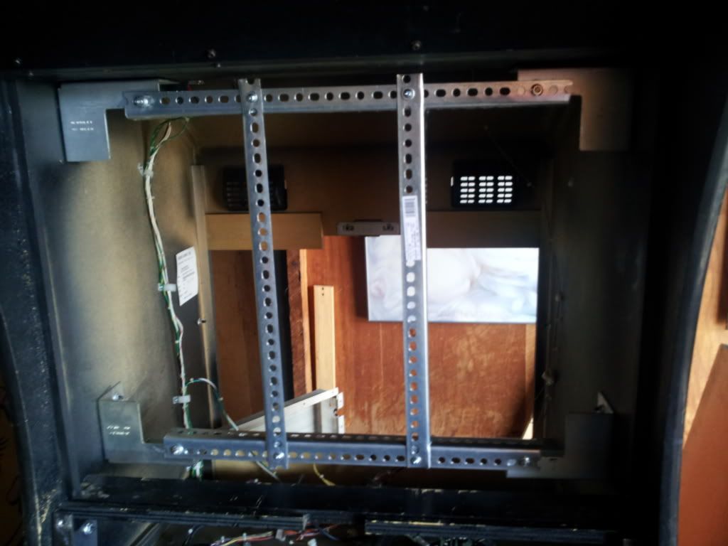

Here are some pics of my install.
I used the original brackets in their original positions and put metal pieces to bolt the monitor to.

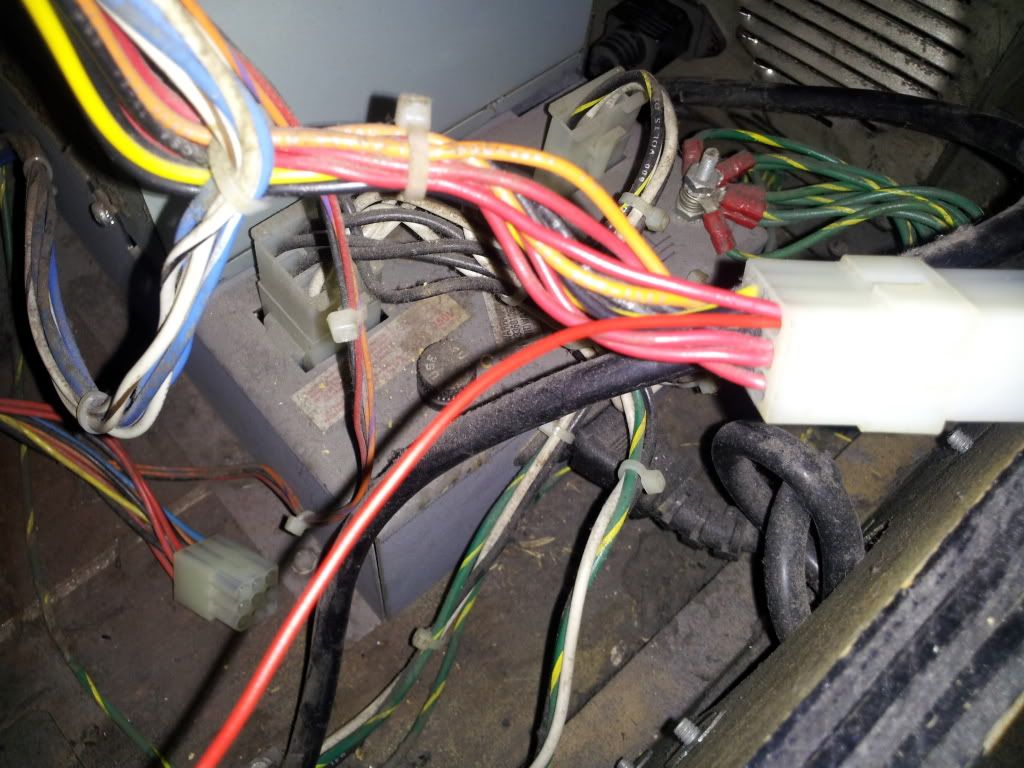

I tapped into the +5 at the molex from the power supply to power the converter board. I pulled out one of the +5 pins, cut it off, twisted the wires together, crimped on a new pin and put it back in the housing.

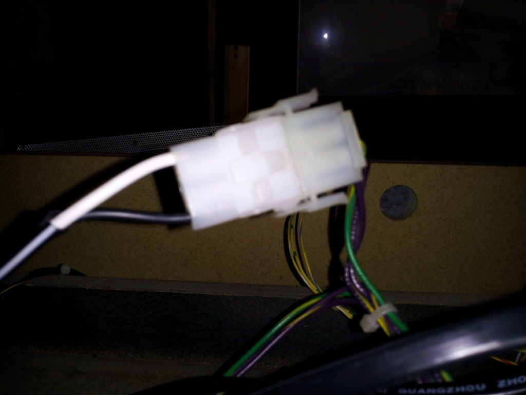

I cut the end off the power cord for the new monitor and crimped on pins and put a molex on it to plug into the original monitor power cord.
Fired it up, did some adjusting ( make sure you adjust the clamp on the converter board) and it looked pretty good.
Picked up a piece of black heavy construction paper/poster board from Target for 77 cents, it was the perfect size. I did not have to cut the width or height, just had to cut out the middle. Looks a little amateurish but not too bad.
