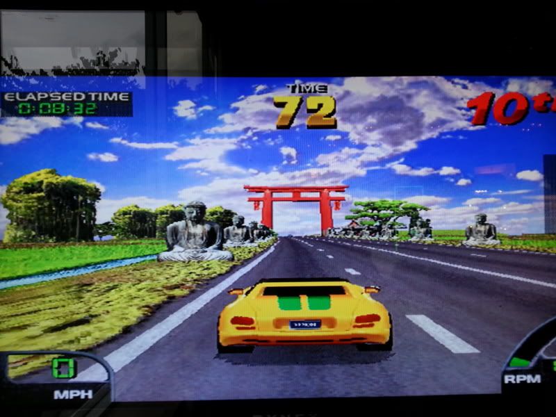

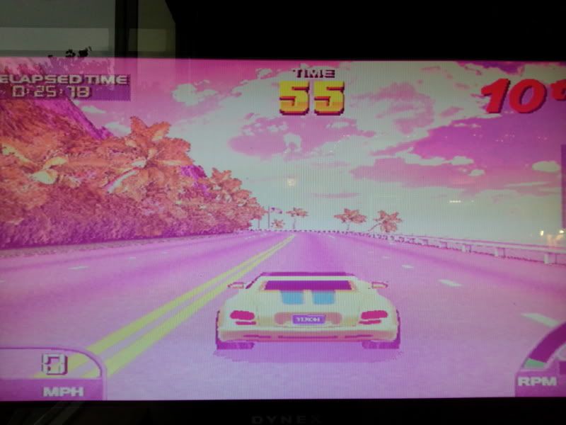

Finished up a majority of a rebuild for a Cruis'n World and am having a problem with the screen turning gradually pinker and pinker. When it first turns on the color and vid is perfect but after a few minutes the screens hue starts turning pink. 20 minutes with the game will result in a playable but annoying pink hue.
I installed a converter board and now have vga connection to a 26" monitor. If I ground out the sync the image restores and the pink process restarts. Grounding out the red pot, I still have pink.
I'm assuming the problem is coming from the board... any help or even a push in the right direction would be very welcome.
Thanks
When game is restart or when sync is grounded out picture goes back to perfect.
After 15-20 minutes gradually turns to pink.

I spent all night last night looking both on these forums and online and no results. If you have link to the thread I'd be much appreciated.
Set your Clamp St to 3 and Clamp Sp to 4 (in the converter menu) and that should take care of your problem.
