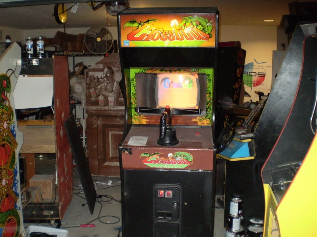

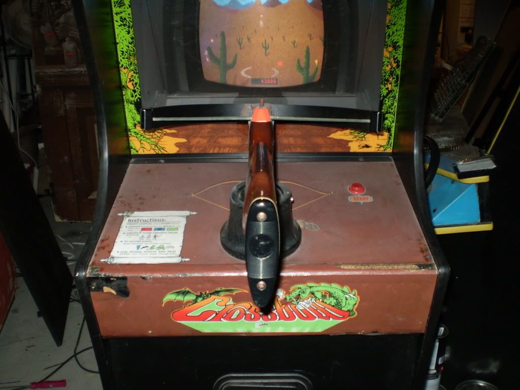

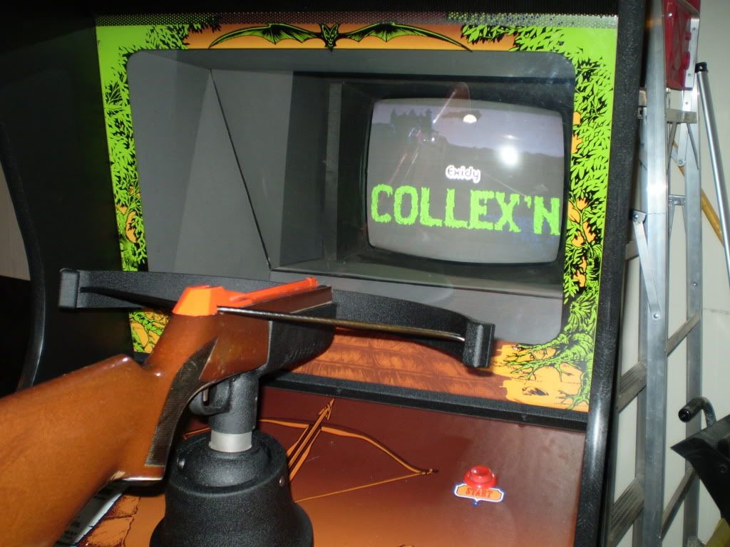

With the recent Exidy 440 kit, I decided to fix up my Crossbow.
Picked it up off of ebay a while back for about $100 -
Not too bad. Rebuilt the power supply and it is working.
Of course, that's not good enough! Installed the Collex'n -

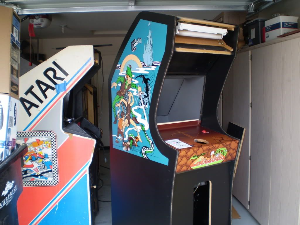

Now to make it look good -
Took off the parts to be powder coated -
Why did they make this thing so hard to take apart? :)

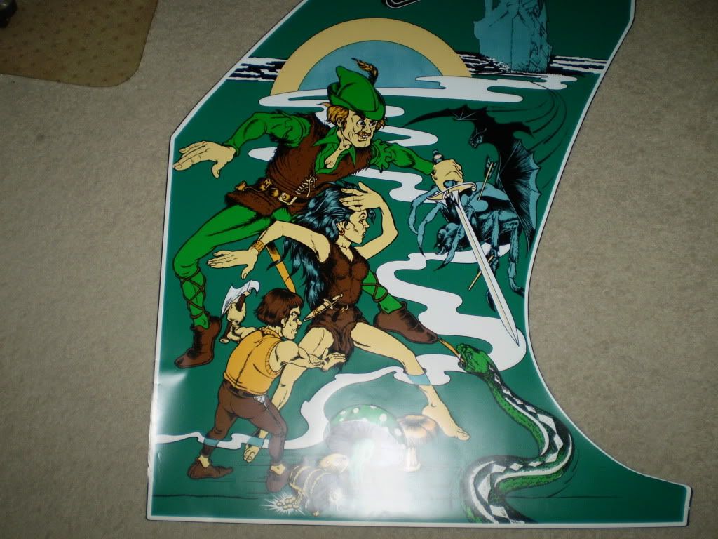

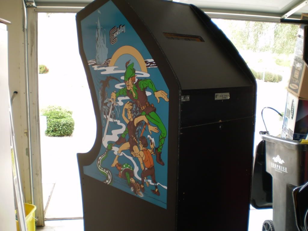

While the parts are being done, started with the side art -
Mamemarquee -
Didn't like it. Fellow KLOVer IvanT made a better replica. Will be shown in next post -

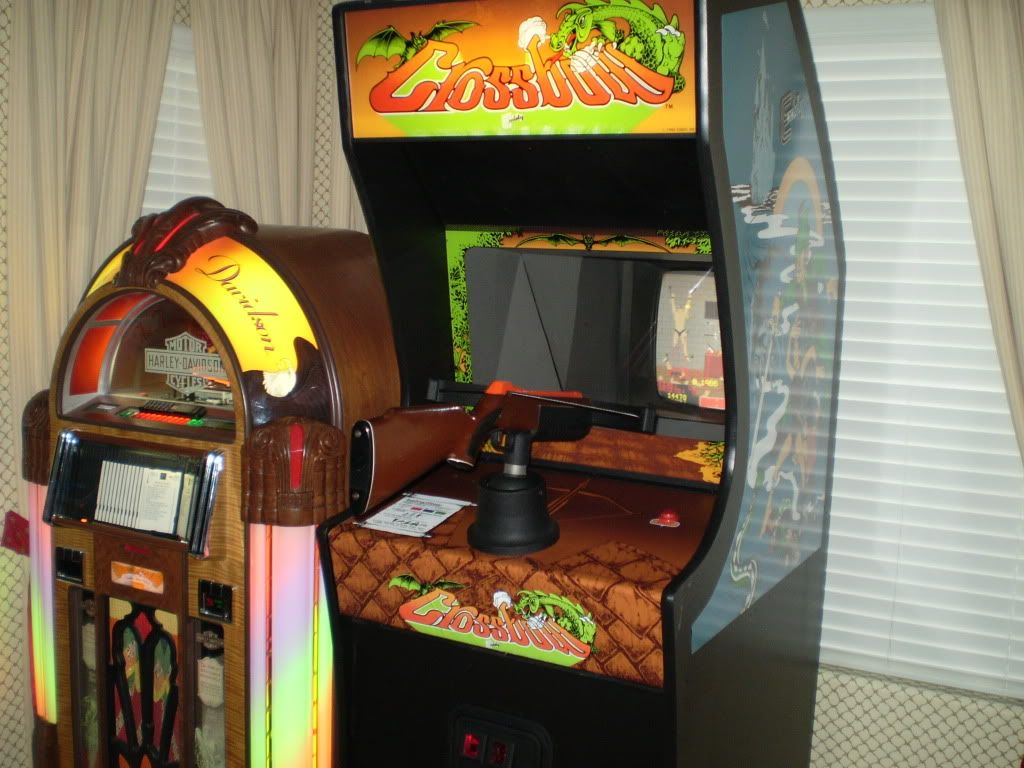

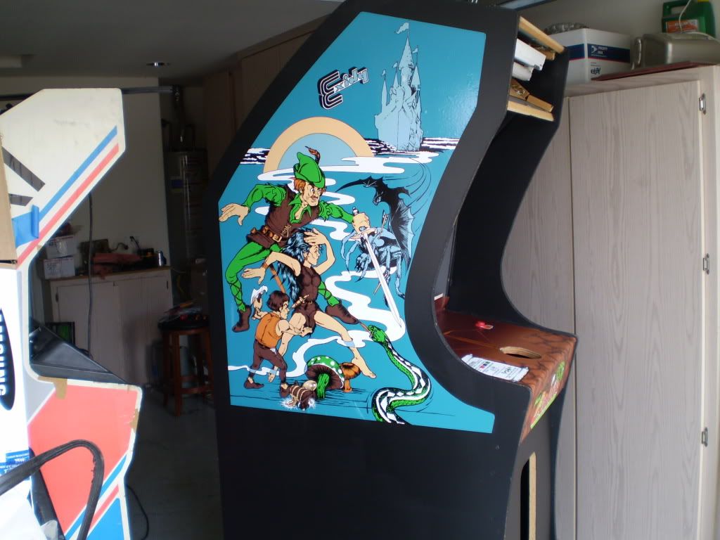

Here is it today, after redoing the cabinet and applying artwork -
The artwork from IvanT turned out great! Thanks a million!

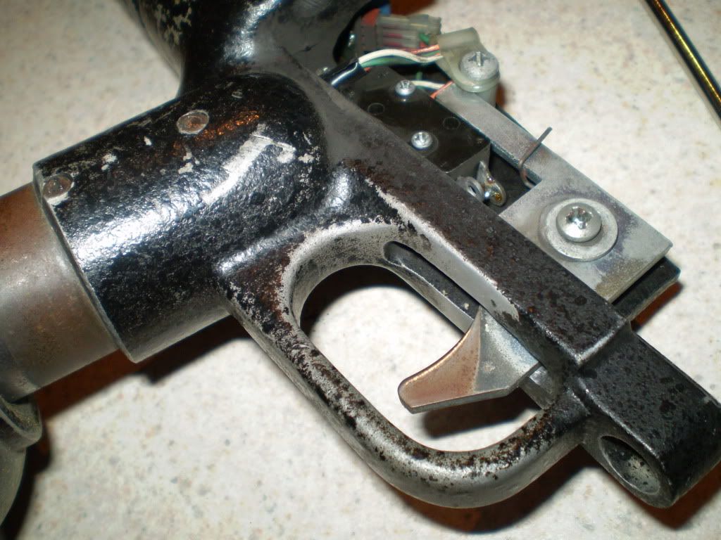

Since you have it apart how does the contact system work gun mech. If you lean to hard against mine it seems to lose gun tracking. I'm assuming something is worn.
Looks Great! Now I have to do mine.
Thanks, artwork made the game!
Not understanding your question...what do you mean by contact system? The optics in the gun, or how the gun is in the swivel holder?
I'm assuming it is something to do with the way it connects in the ball joint. For some reason when you put your weight on the gun it seems to screw up the way the gun works. I've not had mine apart so I'm not sure how the whole mess is set up I'm just guessing you maybe have an idea why this is happening.
Nothing in the ball joint except wiring. The connector is actually near the coin door. May be the wiring itself, or bad optics.
(I assume you have done calibration)
Check the wires from the opto sensor in the gun that run down thru the swivel ball. Sometimes the wires become worn and frayed and will short out randomly when aiming. This is something I have seen twice in 440 games. Fine metal shavings will end up in this area also from the gun swivel ball joint which only adds to the problem.

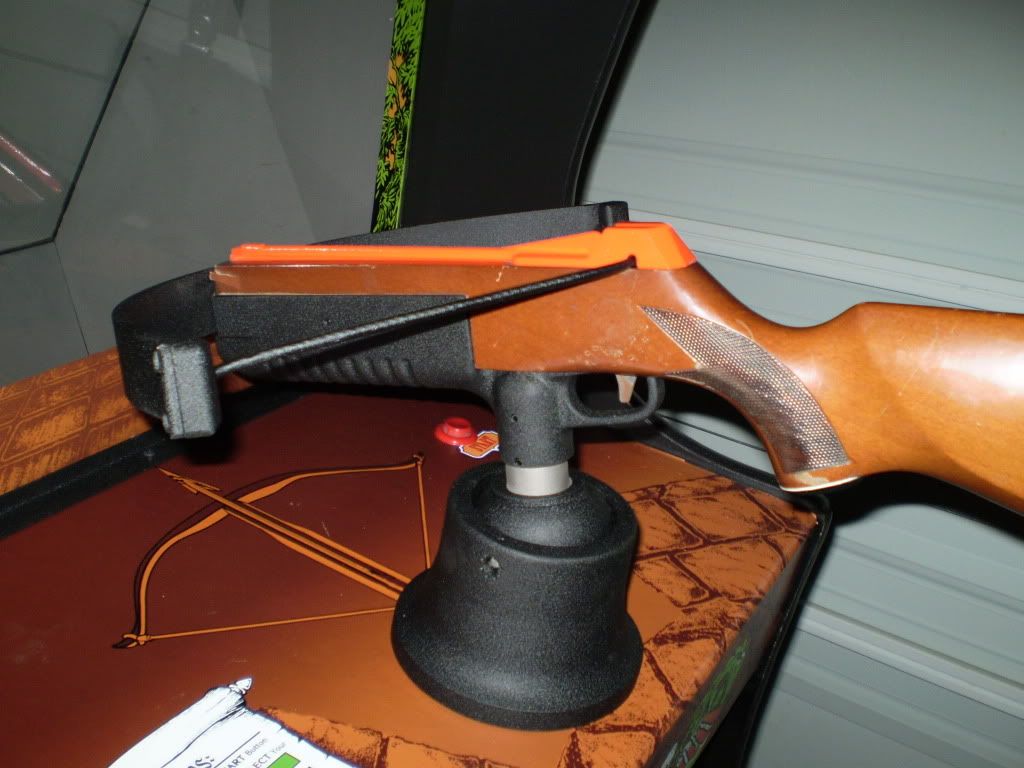

Here are a few more pics after the parts were done being powder coated. Reassembling the crossbow (damn trigger assembly) was a b****!

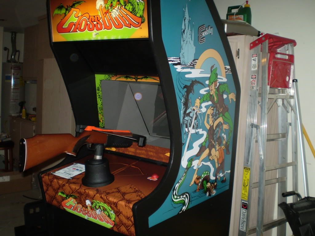

Starting to shape up -
Couple things that I'll have to live with -
1. The CPO being put on a little high and the Start is under the button a little.
2. The woodstock wasn't redone (maybe later) :rolleyes:
3. The cable on the crossbow didn't want to come off! Rivet bolts were used and didn't want to damage the frame of it. Melted off the plastic and did the whole thing black. It is now the "Stealth Crossbow"!

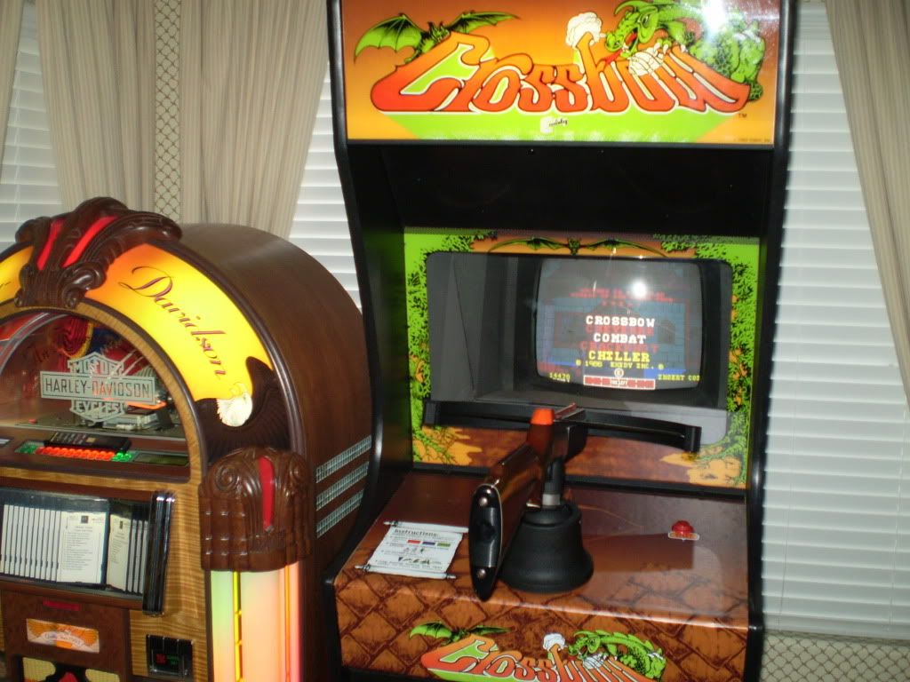

And the money shot -
Put this in it's own spot! Looks to be a little dirt on the right, should have seen it before the pic... :rolleyes:
