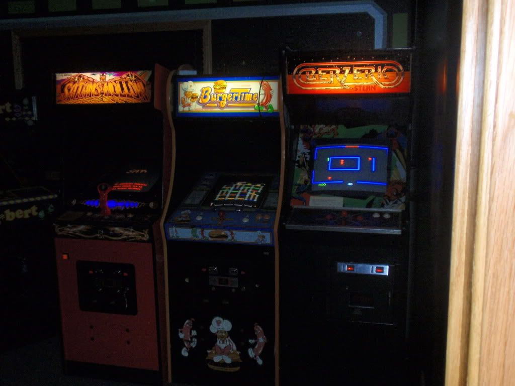

See the little light left of the coin door on my Satan's Hollow? That was the previous owner's idea of a great credit button. It's a 2 inch square lighted draw poker button. I think it says 'DEAL'. As in the 'Real Deal', which is what this credit button solution actually is.
Nice that they illuminated it. As if you weren't going to see that tumor otherwise.
I've seen cabinets with regular buttons mounted in the middle of the coin door, control panel or wood above the coin door. Theres plenty of worse places to put one than what I used.
I agree completely. If you're gonna do it, you're well down the right road with those, they're stealthy and get it done well. One of the cabs I have there was already a button installed on the front of the cab just about knee height on the player 1 side. I ran a coin line to the microswitch since it was already there. At least it was a black that matched the cabinet there, but it sucks. One of these days I gotta fix that.
