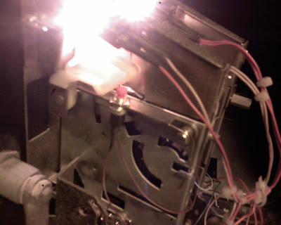

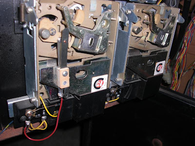

I cant bring myself to put a hole in a cabinet, I can however drill or grind on coin mechs. Pushing the reject will trigger a credit.
I did this one for my Exidy Collexn, std mech and plastic reject button.
And this is in TRON, the reject button is the round metal style.
This is what I also do on most of the games that need a credit switch. I rig something up so pushing the coin return racks up a credit. Completely hidden and completely reversable.
