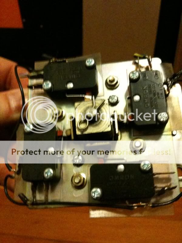

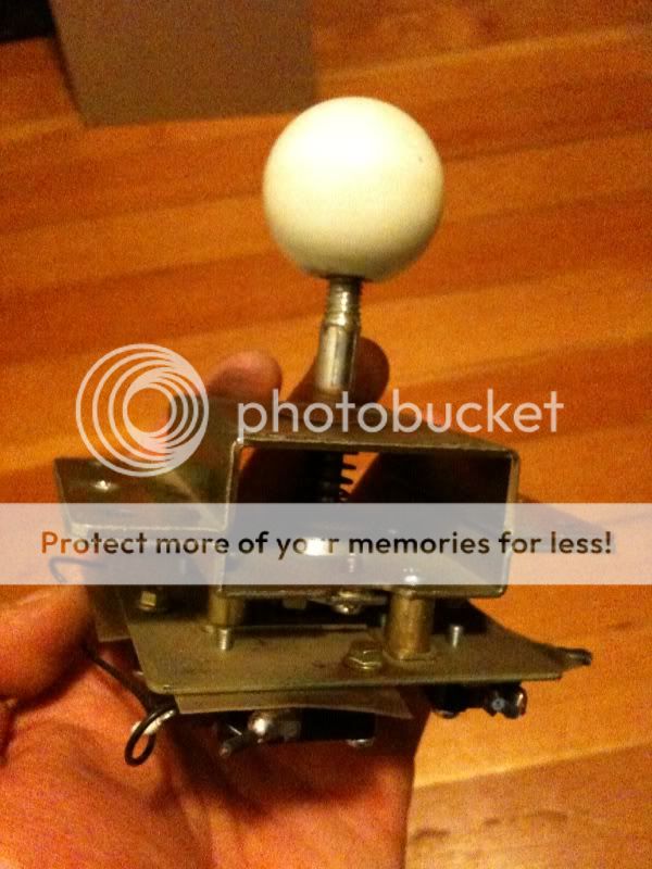

Here are pics of original Crazy Climber joysticks. I made new control panels to put Sanwa JLF joysticks in so I wouldn't have to mod the JLF joysticks like that tutorial on the web, but just ordered JLW sticks from www.lizardlick.com and they are drop in replacments. No modification necessary except to desolder the wires & add connectors. They're also stiffer than the JLF's and feel quite a bit more like the originals only they work much better.
100% thats the joystick that should be in the taito. The 3 that I have owned had those sticks in them.
