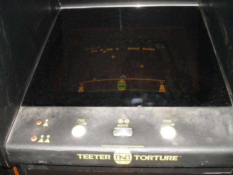

WELLLLLL..... I just took a peek at the contents of the last TT ROM in the set using a hex editor, and looky what I found in the code:
:D bigtime! :D
I guess (and hope) that pretty much settles what hardware it's written for?
Found this picture too that shows screen shot and control panel hardware...

Any more info on this project. Now that I was at CAX I really enjoyed the game play. Wish I could of gotten photos (wish I asked). Would a spinner mounted sideways work? Maybe with a custom roller? Like a roller blade wheel?
I got a look at the board and two things are evident.
1. it's definitely a venture/pepper II style board set.
2. the spinner/roller interface is basic with regards to connecting to the board set. Simply does so by adding a couple extra wires to the existing edge connector. Pretty sure it's gotta be like a arkanoid in the sense that it likely uses the left and right control pins to the harness along with a voltage (likely 5v) and a ground. I still expect to get a chance to get a look at this again hopefully in the near future.
I believe you could probably use an arkanoid spinner as a control. don't know about mounting it sideways.
