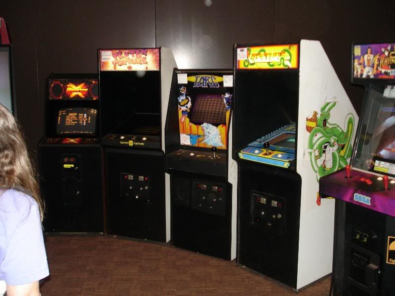

I don't know if you'll ever get a pic of the boardset itself, there's only one in existance and they're in a dedicated cabinet which usually makes the rounds at CAX, whom owns it I'm not sure. There is a pic on KLOV of the marquee, so somebody ambitious might be able to replicate their own. Here's a pic of the cab too, it even looks like a Venture:
http://images.google.com/imgres?img...mages?q=teeter+torture&hl=en&gbv=2&tbs=isch:1
It looks like it has a roller controller though, so that might be a complicating factor for adapting the hardware.

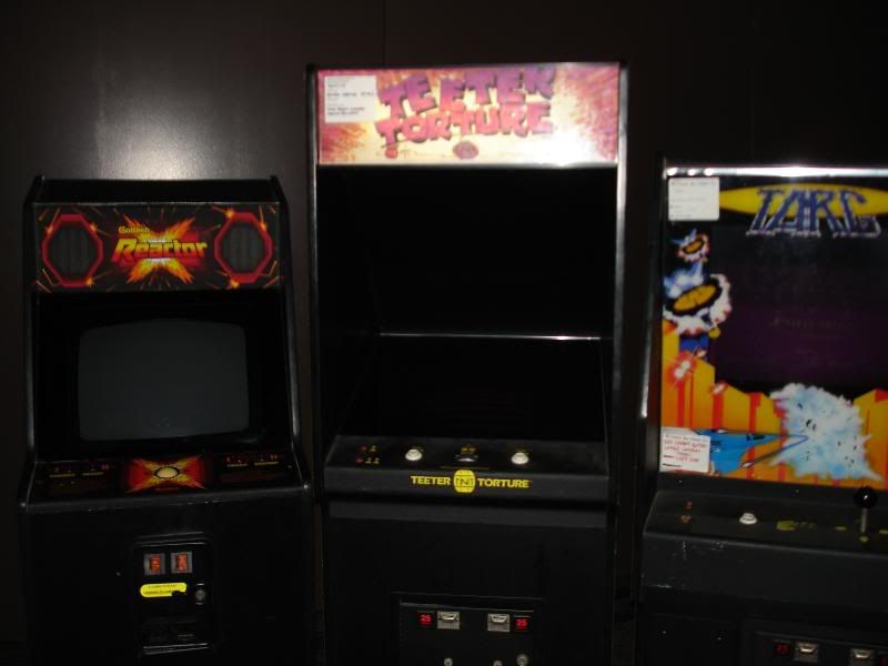

I don't know about the boardset because I couldn't look inside the machine..but the marquee..was just a custom art job that someone colored by hand on some type of paper behind clear plexi..had to look close to tell..nice job..remember thinking it was fun game at CAX when I attended.

The game is owned by two of the main organizers of CAX, and the sticker on the game (which has been there since the show began in 1997) states that supposedly Exidy itself doesn't remember making the game :D . And, yes, the marquee is hand drawn...but I don't know if the current owners made it, or if it was acquired as is from Exidy or whomever the previous owner was.
I played the sh!t out of that game last year at CAX, probably the most of any game, very fun and addicting. Label on the machine did say "Exidy prototype" and I also remember the "they don't remember making this" blurb. If you're going to do it, I'd be in for one! :D
