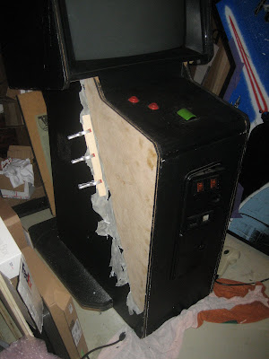

I started by unloading the cabinet and removing all of original primed/painted over vinyl. I thought about keeping it as is, but there were a number of scratches in the paint/primer down to the vinyl. While "removing all of the original vinyl" didn't take long to type, it sure took a lot longer to do. I followed Jedidentist's and esey01's footsteps here, using a heat gun and peeling the vinyl off section by section. It was very tedious and very slow, but it did the trick.
When I was done, I ended up with particle board that was very much like Wade's 720. In many spots, peeling the vinyl from the wood took small pieces of particle board with it, creating lots of areas with pitting.
Next I sanded the cabinet down using an orbital sander and 120 grit. Any areas with major pitting or with gouges or dents were first filled with bondo (for big fixes) or evercoat (for shallower fixes) and then sanded smooth to the surface. I got many of the larger pitting fixed, but there was still some left behind. Instead of fixing the smaller pitting, I decided to forge ahead. This ended up being a big mistake. More on that later.
Over the years, the front panel had come a bit loose near the bottom and the front sides were separating below the lower internal "shelf". To fix this, I clamped the sides and front back down into position, then inserted new 3/4" X 3/4" blocks which were Gorilla-glued and stapled with 1 1/4" narrow crown staples it to repair the broken seams. After the repair the lower cabinet is much more solid and it looks much better from the outside, even if there is a bit of Gorilla-glue splatter on the inside.

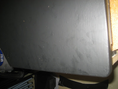

Once the vinyl was applied, trimmed, and folded over the edges, I added new smooth black t-molding. At this point...well...the pitting was a lot more noticeable.
I knew this side did not have the worst of the pitting...so...back to the drawing board.

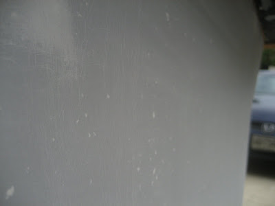

I removed the vinyl from the monitor side (much easier than the old vinyl as the new stuff didn't want to keep ripping into many pieces. However, I will say that the adhesive residue was a real pain to deal with. I first tried sanding, but that didn't work. Then I tried rubbing alcohol...but that didn't work so well either. Finally, I was able to clean up the adhesive residue with Citristrip. To try to fill the pitting, this time I tried something new, Evercoat Slick Sand. It is supposed to be a good way to apply a polyester resin over large areas, which is difficult with regular bondo or evercoat due to a short pot life. Once mixed, Slick Sand has a 45 minute pot life, which is long enough for covering larger areas. Technically, you are supposed to spray with HVLP gun...but I don't have a spray set-up. So, I figured I would try to roll it on instead with a dense foam roller. I was hoping that this would do a better job filling in the pitted particleboard. While the Slick Sand did do a good job with some of the very shallow pits, it did not get rid of the deep pits.
Ugh. So that meant more sanding. And this time, I'm sanding hardened Slick Sand so it is like sanding bondo. After sanding the sides smooth again, I finally listened to advice from both Wade and Jedidentist. This time I used joint compound to fill in the pitted areas. I covered both sides with the stuff, let it dry and then sanded most of it off. After I was done, you could clearly see the pit locations by the white joint compound left behind. Finally, with the sides devoid of pits, I covered with 2 coats of polyureathane, followed by more sanding after each coat. I was finally left with a surface that should take the vinyl better than before.

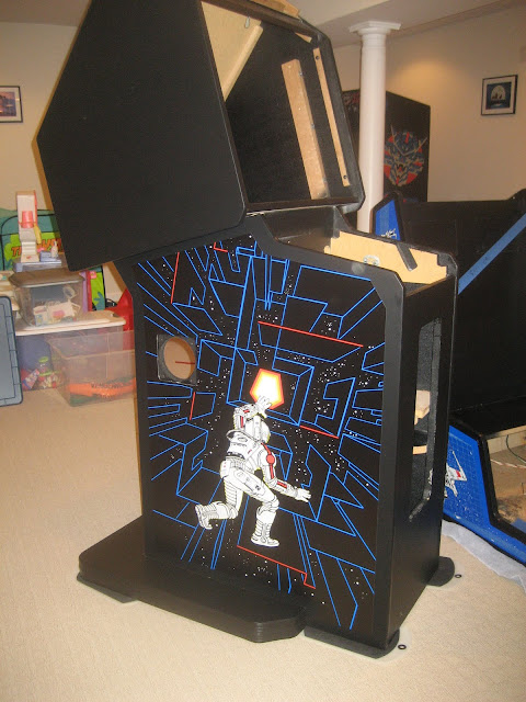

This time, I applied black vinyl using dry method after asking a lot more questions of Rich from ThisOldGame. Thanks to Rich for his guidance. For applying pressure to the vinyl I used a combination of a hard rubber j-roller and my hand with a soft papertowel underneath as I slowly pulled off the backing, 1/2"-1" at a time. For the most part, I was able to get it down with few bubbles. The base of the 720 is a real pain to re-vinyl due to the unusual cabinet shape which causes the pieces that but up to the bottom and top edges. I placed a layer of quick release masking tape on the poly'ed base so the vinyl over-hang from the side didn't adhere too strongly to the poly and I could re-position the bottom edge until I got the vinyl firmly pressed into the corner, which worked out pretty well. Despite being a complete novice, the end result looks very nice. There there are some areas with small bubbles and some areas where I didn't get all of the voids filled or the poly 100% smooth. I will live with the end result as I think the finish looks much better than the previously painted vinyl.
Next, I worked with Rich to modify his vectorized Major Havoc conversion artwork to fit the 720 base. Becasue of the extra deep base of the 720 cabinet, and the fact I wanted Major Havoc to be a bit smaller as he is on the dedicated Major Havoc cabinet, Rich needed to do a little modification to the art to get more maze visible on the sides. Rich was very patient with my change requests and he delivered to me exactly what I was looking for. When I received the artwork, I decided to trim the top part of it to more closely mimic the top of the 720 base profile using a metal straight edge and a fresh blade on an exacto knife. Once I had one side to my liking, I took the art pieces I cut away, flipped them over, carefully positioned them on the other piece of artwork and traced the new cuts for the other side. I ended up with two pieces of artwork with the same shape. The artwork was applied with the "dry method" very similar to applying the black vinyl. I used the same tools as before and went very slow. It was more difficult since the paper towel did not slide as well on the premasked artwork. Once I had the artwork down, I misted the pre-mask using warm water and used a bondo spreader to work out any bubbles I could see through the misted premask. Once satisfied, I pulled off the premask from the center to the outer edge, keeping my hands very close to the cabinet so that the premask is pulled off at an angle close to 180 degrees. As with the black vinyl, there were a few air bubbles that I had to poke a pinhole in to get them to lay flat. Again, I am very satisfied with the results for my first sideart job.

So, here she is, what I belive is the only 25" Major Havoc that exists in the world:
