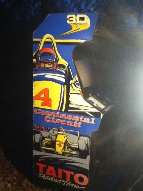

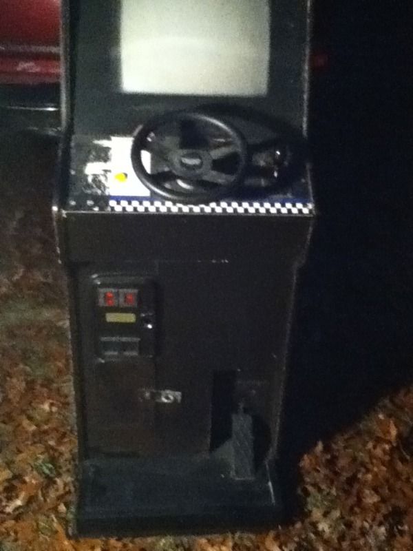

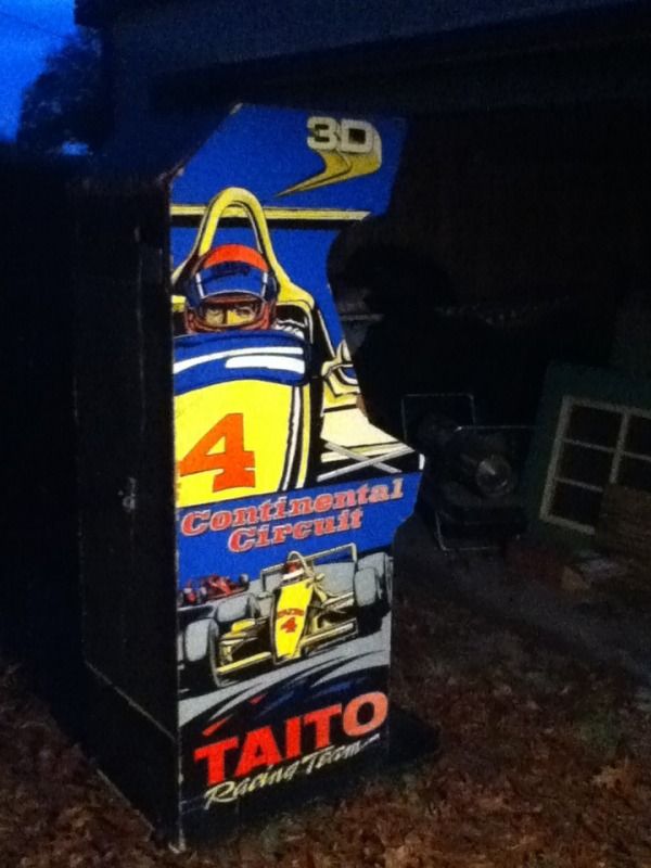

I just got home with it. So here is the hole deal. I found it on cl for $75. It stated the sound and steering wheel did not work. I was not looking for one at the time but thought I would throw out a offer and see what happens.Last night I emailed him a offer of $40 and told him I could pick it up the next day, today. This was about 8:30 last night. He emailed me back this morning and sed if I come and get it today he would do $40. I get it homa and plug it in and no sound. I coin it up and start to play. The gas peddel works, the shifter works. When I go to turn left the car goes left but when I go to turn right nothing. It also makes a lot of noise when I turn the wheel. Since it was getting dark I stopped there and will look at it better tomorrow. It looks like some of the wood has been replaced but the angled part on the top is pretty bad shape and crumbles when you touch it. One plus there is side art on one side, it is not the best shape but it is there.
Here are some picks taken from my sons ipod. I will bring my cammera tomorrow and get better picks.
