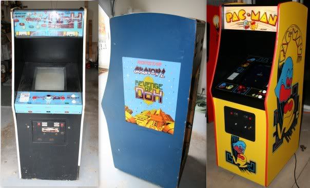

Todd from tntamusements sells complete upright pacman wiring for $20 plus $10 shipping.
That's where I got mine and it worked perfectly. Here is my restore that should help you out. It contains the paint codes if you want to use automotive paint (warning: not cheap).
Here are the before and afters:
As far as stencils, they are out there, but you'll probably need to get your post count up before someone will offer them up.
