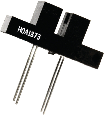

Thanks for confirming, I suspect the difference would cause the switch/joystick to act differently. I just got a boat load of old electronic parts from another klover and found a draw full of these that looked similar so I was hoping it would work right.Honeywell HOA 1873 vs 1879: (suffix seems related to diameter of the detector aperture)
HOA1873-013 Honeywell - Datasheet PDF & Technical Specs
Download the HOA1873-013 datasheet from Honeywell. Optical Switches, Transmissive, Phototransistor Output 4 Ma, Darlington 75Us Rise And Fallwww.allaboutcircuits.com
HOA1879-015 Honeywell - Datasheet PDF & Technical Specs
Download the HOA1879-015 datasheet from Honeywell. Sensor; 1.6 V; 20 mA; 10 muA; 3 V; 100 mW; 100 nA; 30 mA; 0.4 V (Saturation)www.allaboutcircuits.com
Yes I'm familer, I tried one out and it worked but didn't sit as well as the original due to the difference in spacing. Plus I didn't want to spend another $10 shipped since I had so many of these already. Guess I will have to go that route anyway.Many of us have used this replacement. It's currently out of stock but I'm sure you can chase it down elsewhere
agreed on the way it sits. I suspect you could likely enlarge the through-holes on one side to allow it sit better but still works fine the way it sitsYes I'm familer, I tried one out and it worked but didn't sit as well as the original due to the difference in spacing. Plus I didn't want to spend another $10 shipped since I had so many of these already. Guess I will have to go that route anyway.
