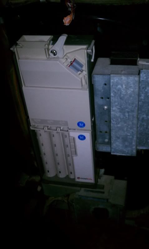

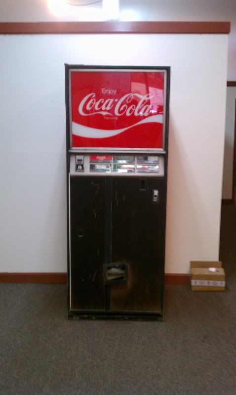

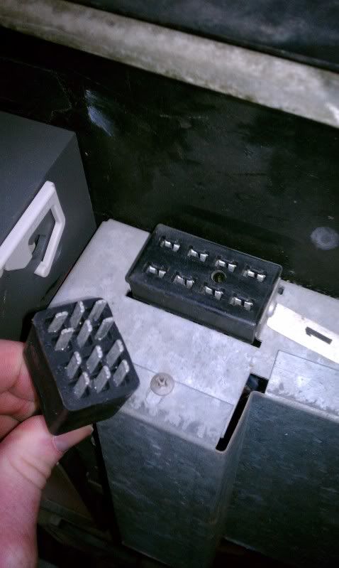

Hey guys, ran across my first coke machine today. A guy brought it to my girlfriends store, asked me if I could get it working, told me if I did, I could keep it. It appears to be complete and working, minus the coin acceptor. He was given a coin acceptor to put in it as it was missing the original one, but this one doesnt match up with the connector. Any idea where I can get the correct one? Here are some pics:
Any help would be greatly appreciated. Thanks! -Jason
Man that is cool as hell, I remember they had one at Kingsport that had some 80's aerobic chick on it for sale. Hope you get it working. Would be very cool to restore.

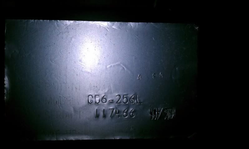

You can check ebay. I would try to find a manual to see what changer it used. My guess would be a Coinco. You might check their web site they may have a list of compatible machines. Here is a picture to set it to vend with a button.

Thats a standard 9 pin Jones plug on your machine. You can look for a Coinco S75 9800 series changer for pretty cheap.. Price can be adjusted from .05 - +1.00
Basically, no... either one will work. The location for the dip switches to adjust price is different, and I believe the B can be set to a higher value.
If you look at your socket picture, the round pin is in the middle between the 2 rows. Its hard to see in the ebay 2nd pic, but I'm 99.9% sure the round pin is in the middle. I have never seen any different jones socket on that coin changer. Ask the seller for a better pic of the plug.. Thats a good price if it stays that low. I've seen them go in the $50-$75 range
Yeah, upon looking at other auctions with the same model number, I see exactly what your saying. Hopefully I can score this thing and bring the machine back into service
