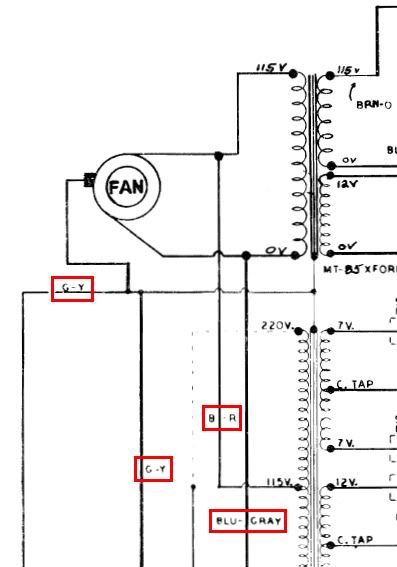

I just got a 60-1 multi board for a empty cocktail cabinet I got for free. Just wondering a few things. The control panels only have the joystick and one fire button, how many buttons do I need to play the games on a 60-1 multi? Is 2 buttons enough or should I put 3 buttons? Also the cabinet was empty except for the monitor so no power supply but there is a fan at the bottom, just wondering what power voltage the fan should be wired to and where can I get decent mulitcade CPO for the control panels.
I think most of the games are two-button - there are two that use three buttons but one can be set for a single (can't remember titles, but a search will reveal that)
Fan is likely 12V - someone will correct me if I'm wrong.
CPO will depend on what the cocktail was originally - finding one that will match up with what you have will be the first step. There are sites that will custom print if you can come up with a design on your own.
Good Luck!
It is a midway cabinet. There is a 3 plug connector on the fan. Two brown wires and a black wire which is the middle wire on the connector, do I just run the fan to the 110ac on the power supply? Do I hook up all the wires?
take a moment to download an original schematic and check it. Way more cost effective than guessing and seeing smoke poof out instead of a spinning fan...
Example: Ms. Pacman cocktail
