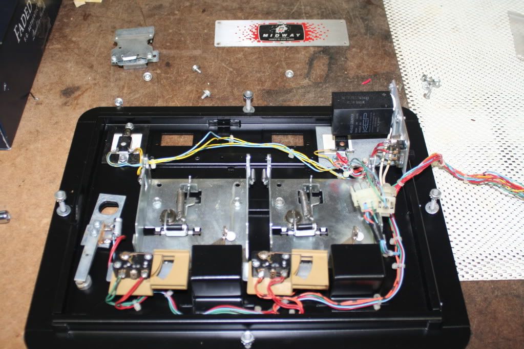

Just got my coin door and frame back from the powdercoaters last week, and now I'm getting ready to put things back together:

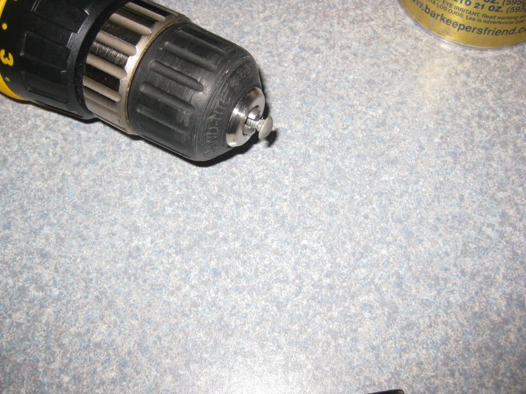

I used this on the bolts:

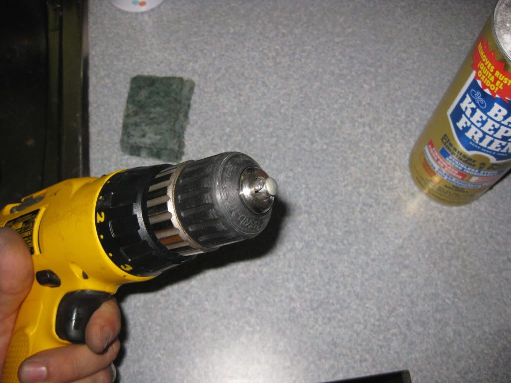

I just put a bunch of it on a wet scouring pad, and chucked the bolt in my drill, like so:

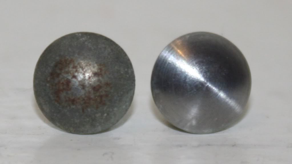

After spinning the bolt on the scouring pad with some paste, here's my result:
Ahhhhh...much better.

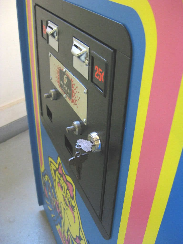

Taking a tip from a fellow KLOVer, I decided to use water and aluminum foil on my coin plates.
Take a look at how well the plate cleans up by rubbing it with just water and Al foil:
water and aluminum foil? i have never heard that one before. interesting
nice job on the door
