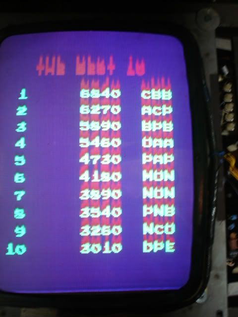

ok here is my glitches game seems to play fine but all the sprites are garbled or not correct

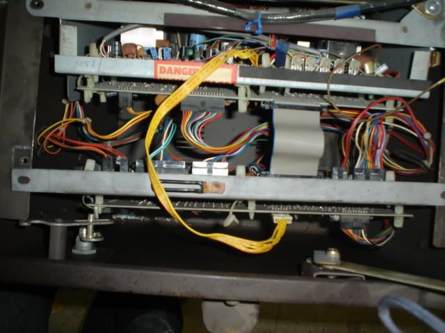

here is the board set in ?
i pulled the main set(still trying to figure an easy way to remove the ecss board attached to the underside of the monitor frame without pulling the monitor as well)

and i got a good pic again with only verry slight graffix glitches
turned of the machine and when i turned it back on later the full glitches came back

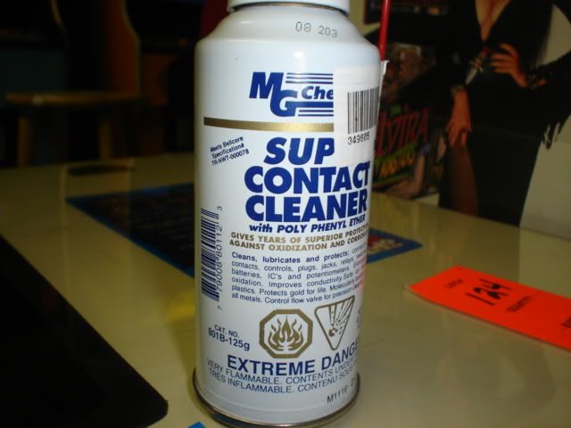

well when i pulled the roms i noticed some corosion (i.e white fuzzy stuff) in the chip sockets so today i ran out and got this stuff
i had 2 choices at the store the stuff i got or stuff from the same brand but it was just contact cleaner not super contact cleaner
they bolth were the same price
the only diffrence is the stuff i got says it bonds to metal and protects ic legs ect.ect.
is the stuff i got safe to use on my boards to clean the chip sockets or should i run back and just get the regular cleaner

while repaccing the one thats connects the 2 board set to the ess board under the monitor i found somthing that is weird
if i only part way plug in the ribbon cable (using a new floppy cable with key tabs cut off)the game goes perfect but if i insert it all the way i get the garbled graffix and red bleed
if i puse it almost all the way in i get good graffix but red bleed
arggggg well im going to reflow the heaqder pins on the ess board for the cables

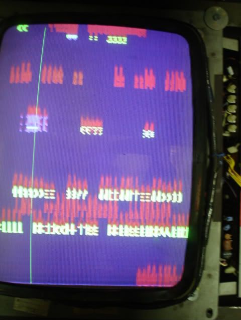

after messing around a little more i found that if i evenly place the ribbon cable in tis all garbled but if i stick one side in more than the other its fine
if i push the cable all the way in i get totaly scrambled graffix with red bleed
slightly push it in i get perfect pic
push it part way on one side fully on other i get god graffix but with red bleed

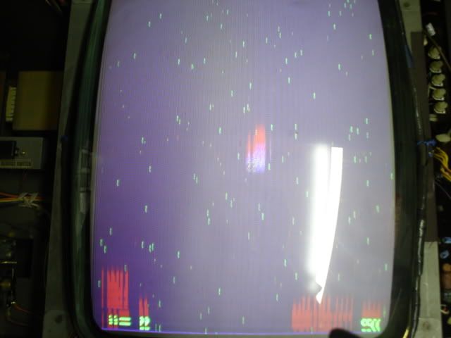

i can get it this good by only partily inserting the ribbin cable
looks like ill ned to cap the montor tho cause the adjustment pots ar not affecting the red bleed
ribbon cable fully in (ship ijust weird words are just garbage and there is a green line that rolls across the screen left to right)
with it only in part way (all graffix look great ship is correct allong with letters and numbers but major red bleed)this way tho it wont start a game
