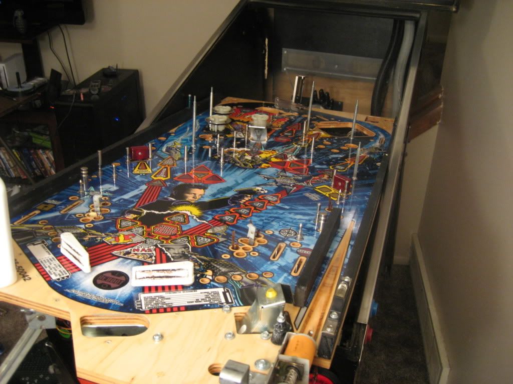

Happy T-day to everyone and thanks for replying in advance. Just purchased a Data East Batman pin and got into the playing field this morning. What I thought was ball wear on the playing field is really only dust and a lot of it. A good wipe down is needed and it sounds like Novus is the stuff to use to clean/polish the playing field. Anyother tips or cleaning supplies that might be helpful in my weekend adventure?

Do you have the novus already? It really works wonders. It cleans plastic ramps amazingly too.
After you get it all cleaned up you are going to want to wax that playfield. This thread covers wax.
But you are going to want to get a pure as you can Carnauba Hard Paste Wax in a can. Not something that squirts out of a bottle. Avoid anything with the words cleaner or polisher. Wax, let it dry, buff off with a soft cloth, repeat once or twice, and enjoy.

To clean mine, I use magic eraser, cut into 1" cubes, dampened with isopropyl alcohol. Don't use too much pressure, you can take off paint.
Then I polish with novus 2 and magic eraser. 8 oz. squeeze bottle from pbresource.com/cleaner.html (a little goes a long way) .
Then wax and buff and new balls.

hmmm, never tried the novus on an eraser. I always used the magic eraser and alcohol and followed that with the novus 2 and a white t shirt, then a couple layers of carnuble.
if your rubbers are pretty nasty Id pull your playfield plastics (one at a time) and clean them to a shine, top and bottom with novus 1 and put new rubbers on while you have them off, kill 2 birds with one stone.
as said by the others, make sure your ball is clean and shiny, your playfield is only as smooth as the ball
I love the magic eraser but have never tried isopropyl alcohol though. Thanks for the tip. Wildwest, I like your idea of taking each plastic out, cleaning, and putting back. Being my first time, I do not want to get confused. Balls are always better when they are clean and shinny. HAHA!

While you are taking stuff down make sure to take a million pictures. Stuff you are sure you can remember how it goes is suddenly a mystery when you go to put it all back together. I always do a full tear down since you want to wax the whole playfield I dont think taking off one plastic at a time, cleaning and replacing it works to well. JMHO

agreed - if you go the full teardown route take many pictures. seriously - take hundreds of pictures. *and*, take them from different angles for any complex area. nothing more frustrating than having a picture of the area you want during the rebuild, but not being from the right angle :/.

Ya the first time I didn't want to either. Then after 20 plays dirt had come from under every little spot I hadn't quite gotten to. Pointless to not go full hog in my opinion. BUT i cant stand even a tiny bit dirty game.

I spent 5 days over the holidays cleaning my data east batman and it came out great. It was super dirty and looks very respectable now. I took everything off the playing field and got it reassembled correctly. I did lose a small nut on one of the switchers but that was the worse thing that happened. Novus worked great, took lots of pics that helped out a ton when i reassembled it, baggies was a great idea, and all of your input helped!
