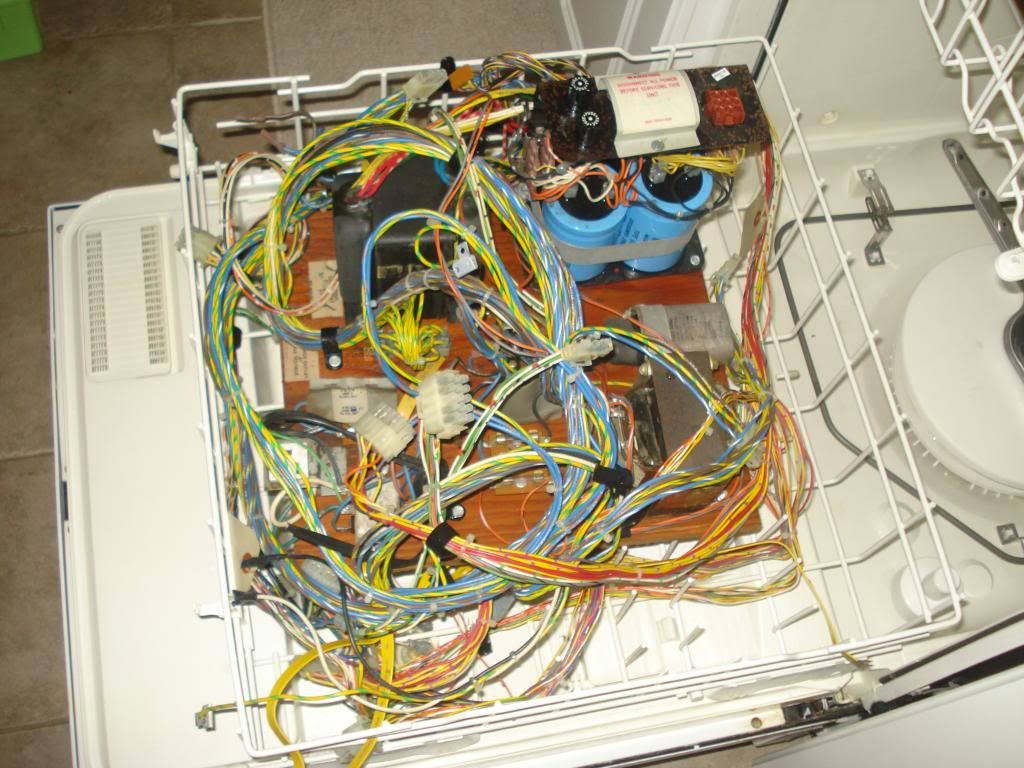

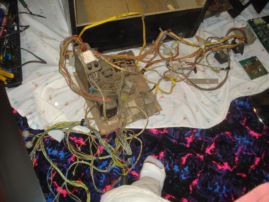

All in the dishwasher for me. Up to hundreds of boards now! Never a problem, just wait to dry. There isnt much that i wouldnt put in the dishwasher at this point, except for Plastics that could melt (like Pinball ramps - the heat cycle could melt them) and any matte metal parts (like mounting brackets) because they dont clean well and usually get a nasty white film left on em.
Here is a before:
And the after:
Its a no brainer.
Here is a before:
And the after:
Its a no brainer.

I use the dishwasher on almost anything as well. wiring harnesses circuit board coin door monitor chassis. I only put plastic stuff on the top rack!
nice and clean and heated dry
