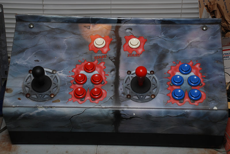

I finally pulled it out of the box, flipped it over to the business end and what's this I see?
Holy crap. I've never seen one looking this good. The only issue with the decals is the off center P1 start button, everything else there is pristine. Looks like someone converted the CP to this, put down the decals, and threw lexan or something over top of it. There's some discoloring on the lower left, but otherwise this thing looks like the day it was done. Looks like the protective plastic will be able to come off and I can get scans of the decals, since as far as I know, nobody has scans of them. The sticks are mismatched, as:

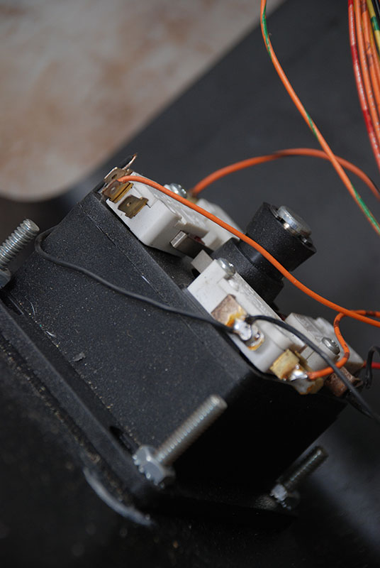

The left one is a leaf switch stick. Aside from the fact that the leads are soldered, it looks to be in great shape. Feels really smooth, but these were supposed to be 8 ways, with color of stick and buttons matching, good thing I've got the sticks from the other panel.

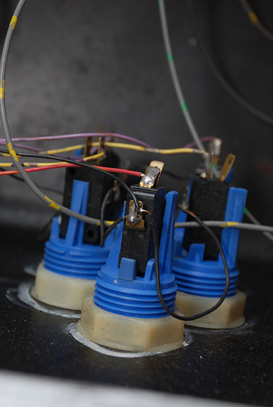

A closeup of the soldering on the buttons. There looks to be little enough solder on them that a lot of the switches are probably reusable, though likely I'll still have to put in an order somewhere.

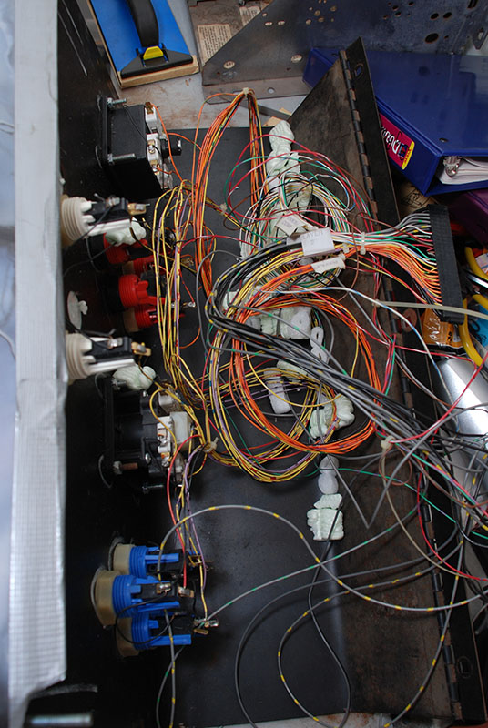

The current wiring mess (and messy bench, including the WG4900 that's going in the cab), with attached JAMMA harness and a few remaining packing peanuts. Looks like some of the wiring on the harness is missing, I'm going to have to go through with the schematic and figure out what's borked.
