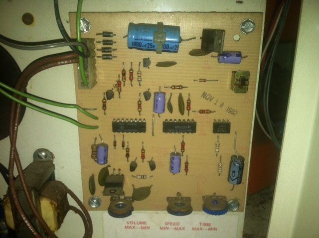

I pulled the board out and there was actually two boards. I brought them in and took a few pictures of both boards. The lower board is drastically cleaner than the top board. I found it interesting that both boards have a dial. If there was just one I would assume it was volume, but with two what could they be? I attached pictures of the boards in the original flickr link.

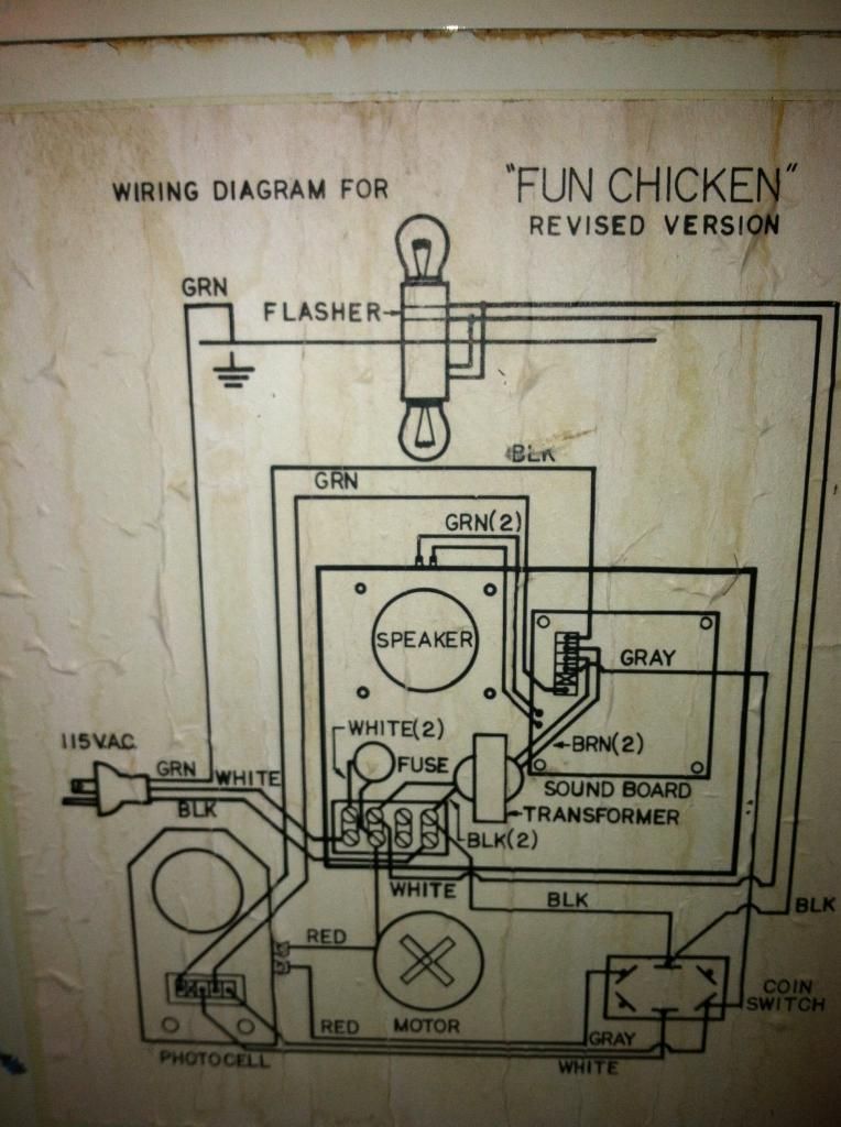

Let me check my fun chicken tonight because the motors look similar. I may have a diagram as well.
Sweet, that would be really helpful. You might could stick your voltmeter across the terminals and see what is flowing through it when it's running.
Will do but give me the weekend cause I may be a little too intoxicated tonight :)
I haven't been back there yet but I have these pics on my computer so ill post them up until I can get in there, hope they help for now.
Thanks a ton for the photos. That explains why both of my boards have a dial on them. One is probably the volume and one is the speed. What is the difference between speed and time?
