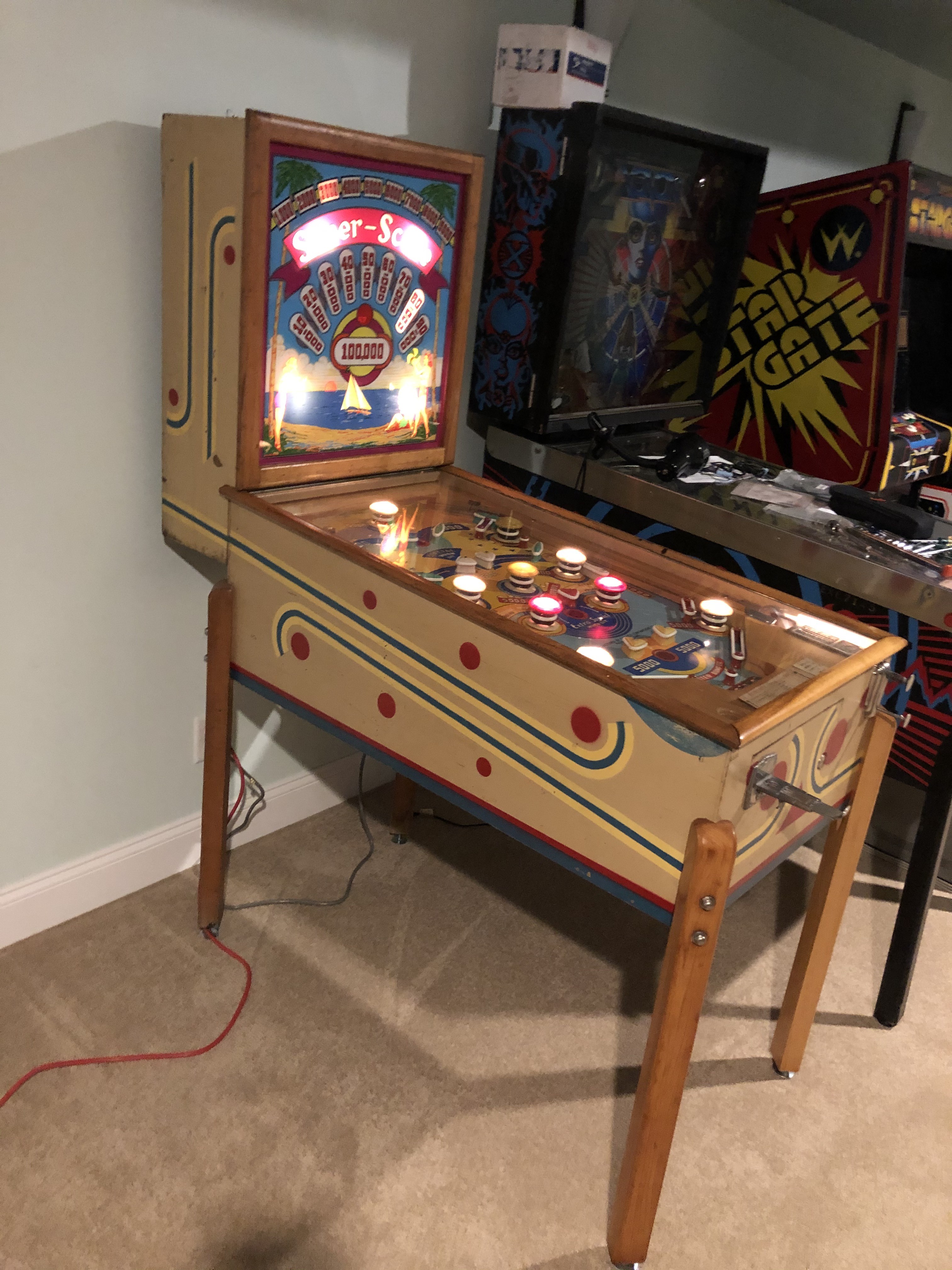

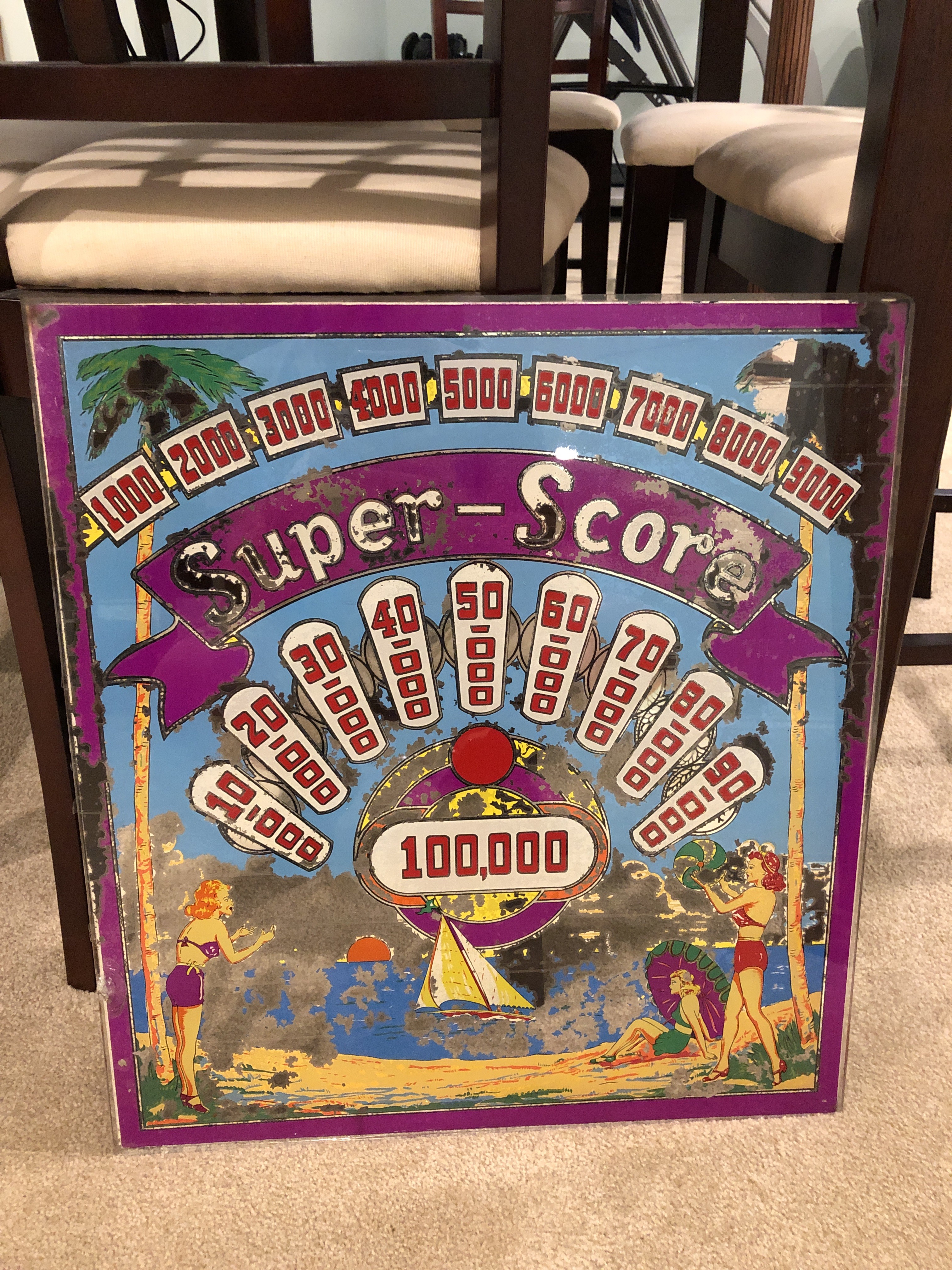

I figured that I should keep a log of everything I'm doing with this 1946 Chicago Coin Super Score.
First off, I washed the outside of the game - from the 1940's, it had a pretty good coating of dirt and nicotine. It took several different cleaners, but I got all the black goo off.
I pulled the EM stuff out of the head, and removed the backglass. I sent it to BGRESTORE for a re-do. The re-do turned out great.

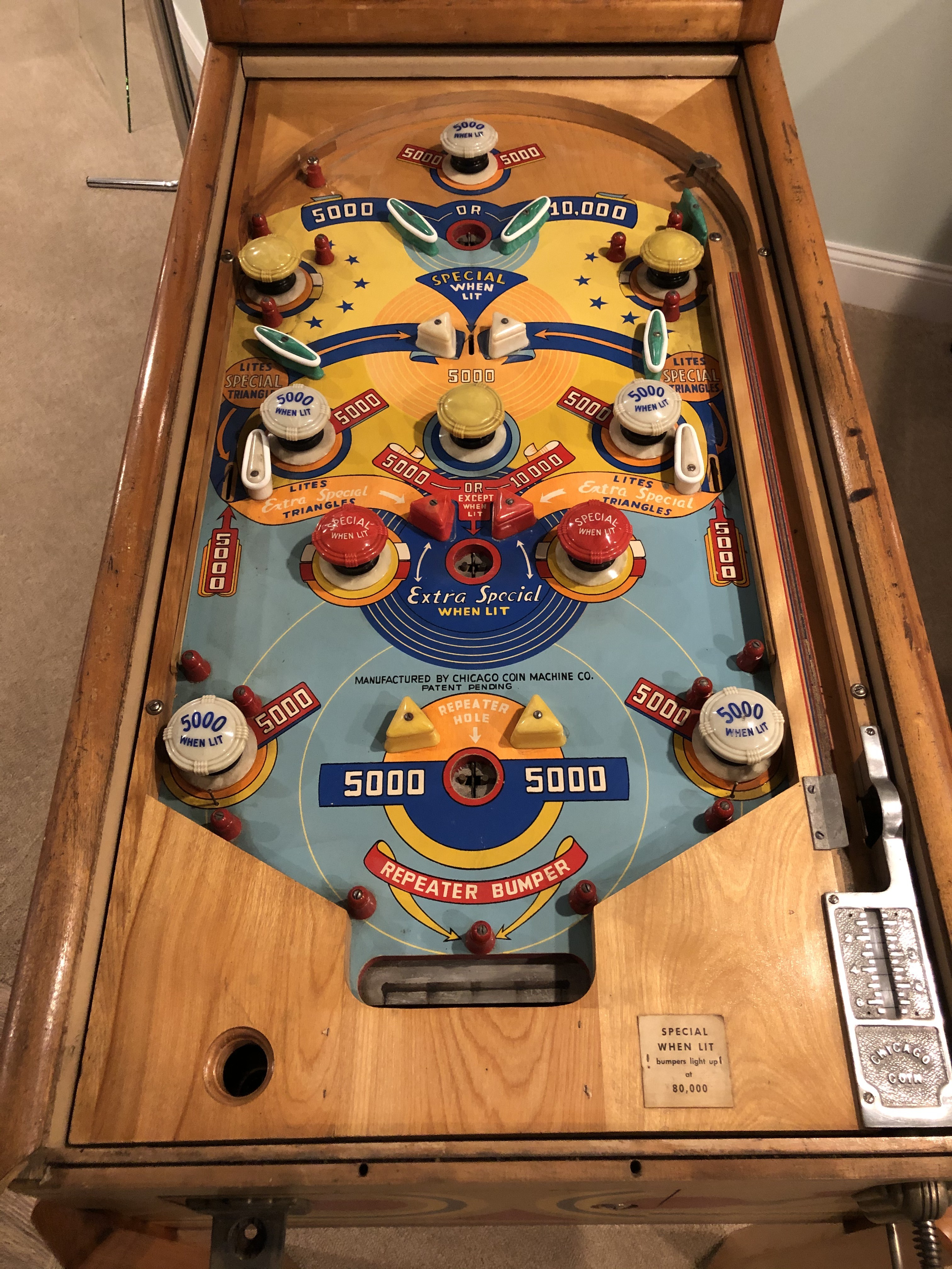

I have done a deep cleaning of the playfield. It's remarkably clean, apart from a few areas which have lifted.

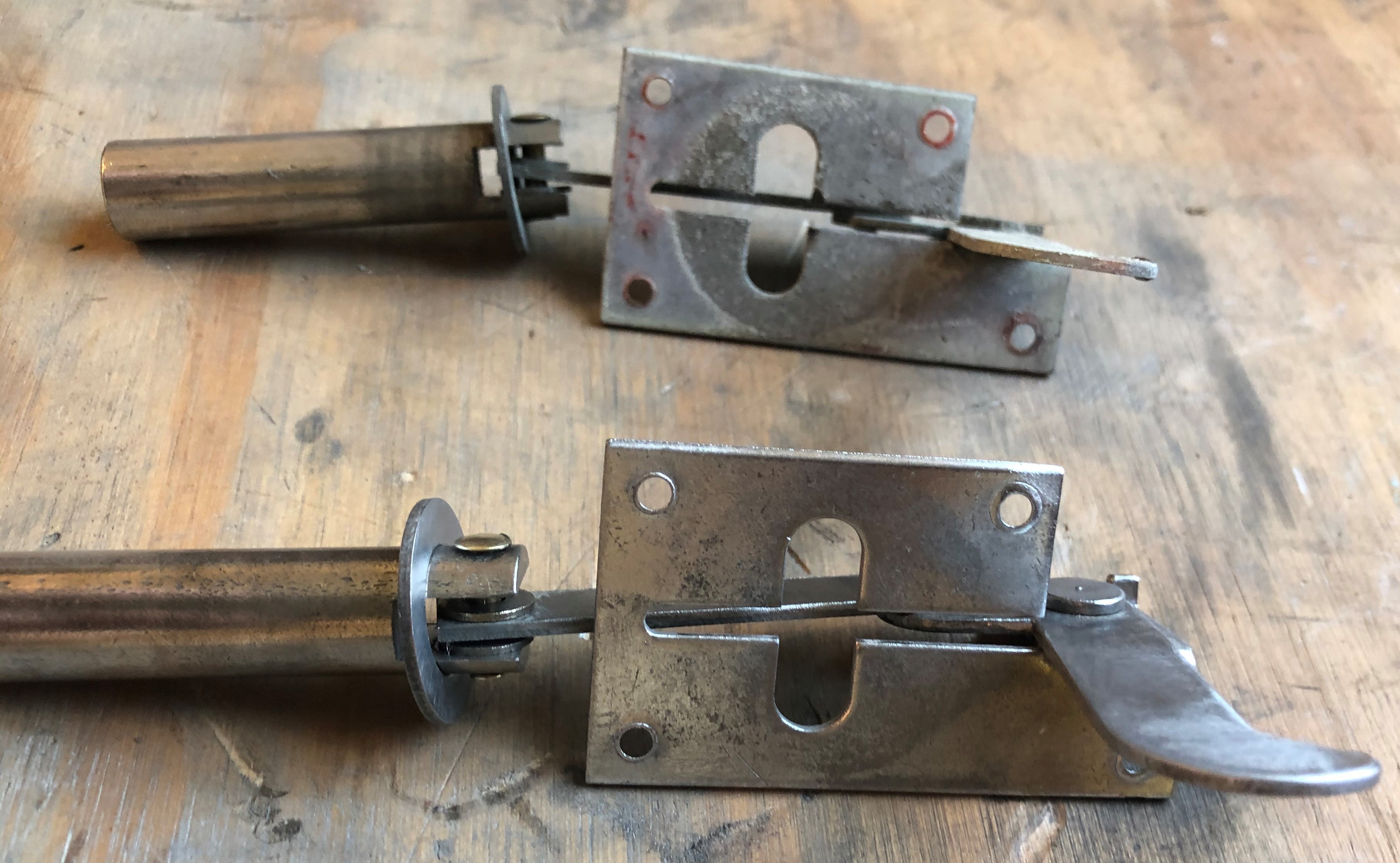

So I extracted the 3 outhole mechanisms - pretty easy.
1. Disconnect the two switches - I used cardboard with the original screws to keep the stacks together.
2. Remove the 4 screws from the plate
3. Carefully extract

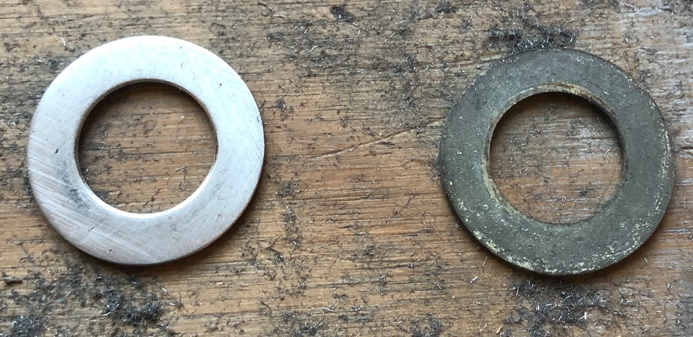

Now it's on to the 0000 steel wool, bench wire brush, Dremel wire brush, and sandpaper when absolutely needed.
Here are the results. The first one is of the plates, before and after cleaning
The second one is of the spring washers on the plunger, before and after.

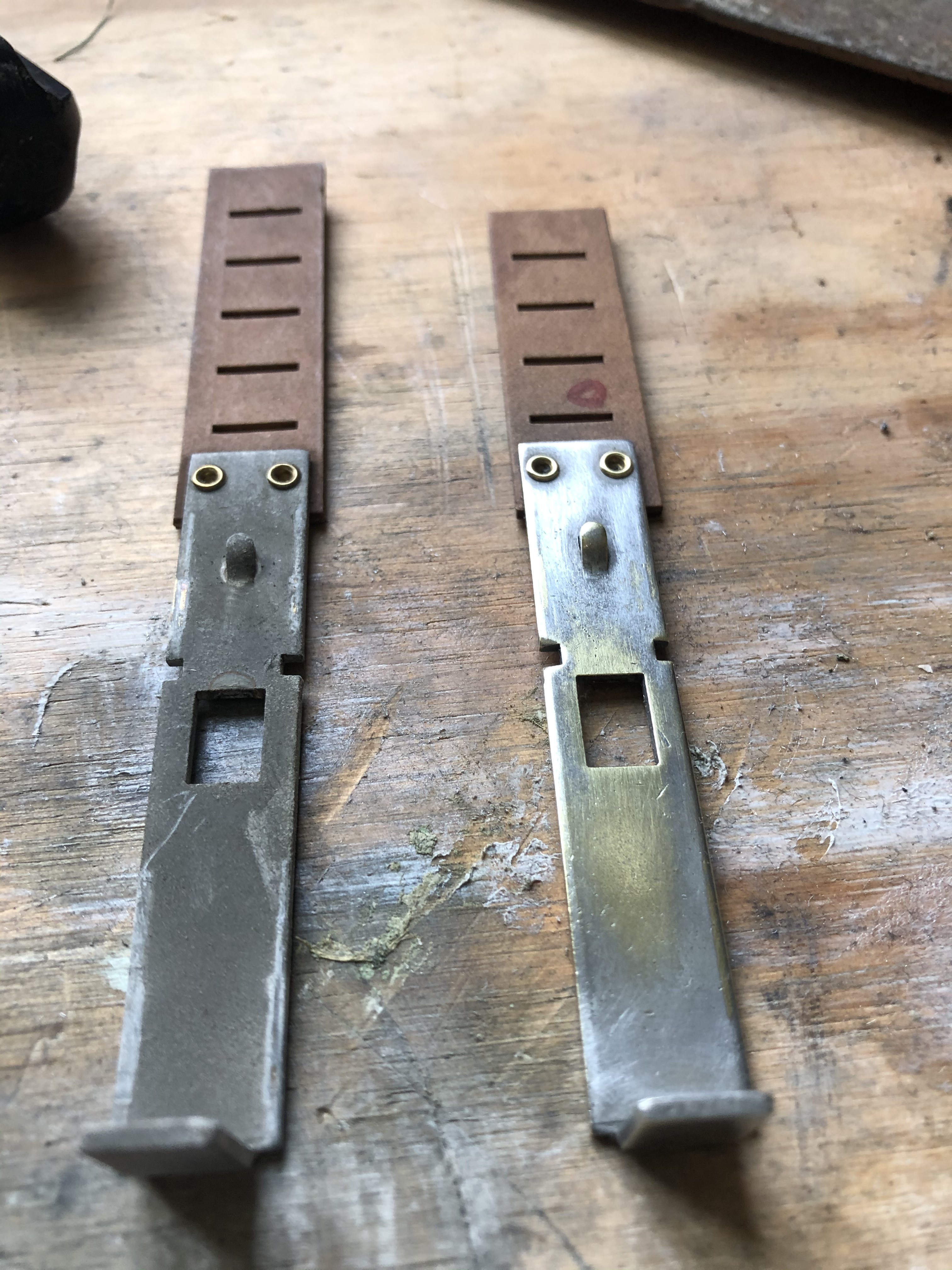

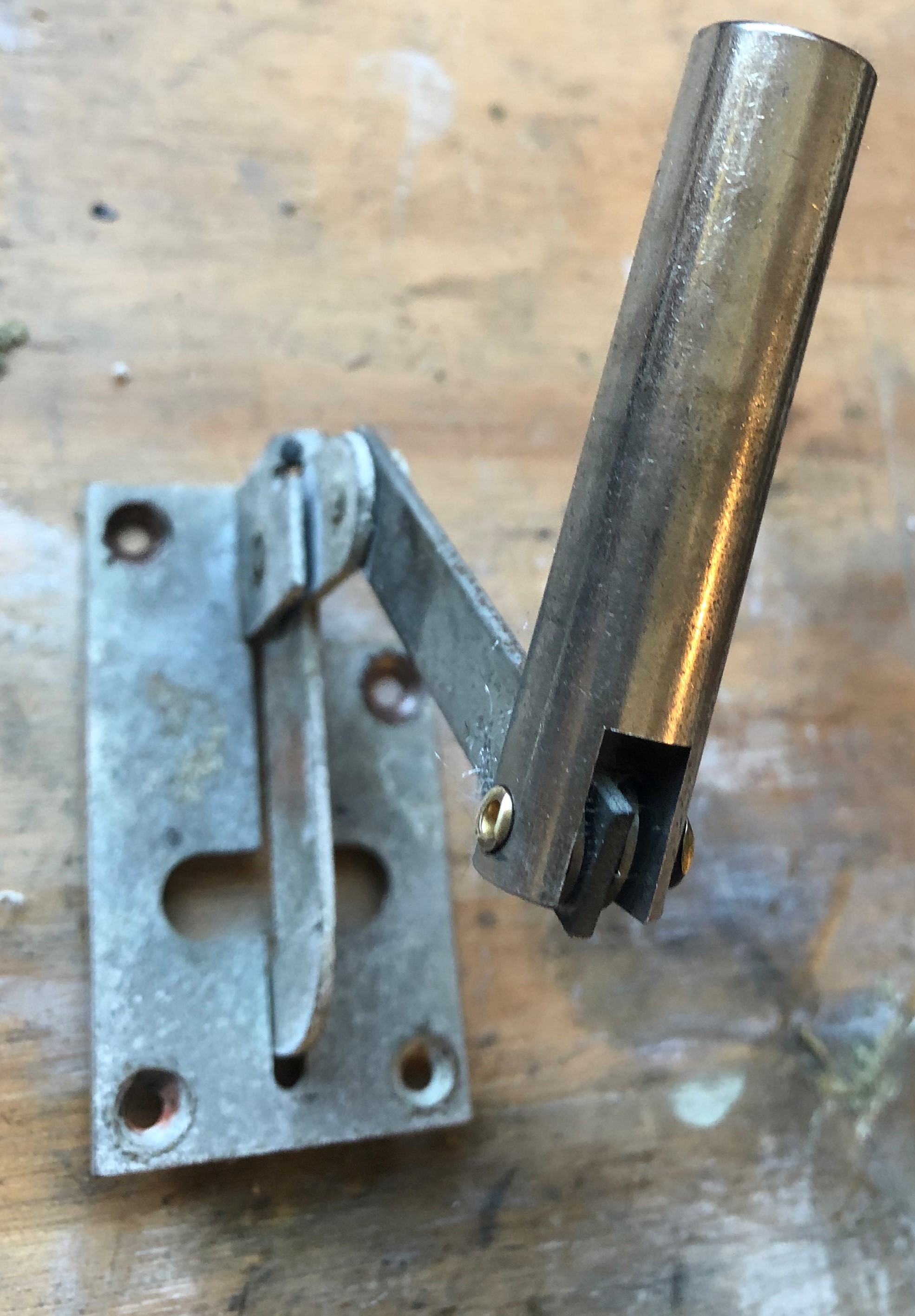

Corrosion, corrosion everywhere! These switch gang blocks were so corroded they were hanging up.
It was fun getting them out - they came out easy, but you have to remove the stacked switches - again, a piece of cardboard worked to keep the screws in place to hold the switch blocks together.
You can see from the before and after, some of the tin plating is just gone. Brass is showing in the base stock! Oh well.
Some C-L-R (mixed 10% C-L-R to 90% water) and a brass bristle wire detail brush (the kind that's always on sale at Harbor Freight Tools) will clean up those relay armatures quite nicely.

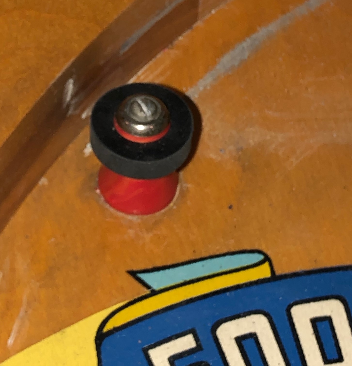

Finally, the top ring bumper came in! I had to source it from eBay. The original ring was some type of rubber which was falling apart. It is on the right. It is around 1/16" smaller on the OD, and a little larger on the ID. I am going to see if I can get the rubber to stretch for the ID, and live with the bigger ID.
I can't tell what the original material is. It's spongy to some degree, but doesn't seem to be rubber. Then again, after 74 years, it may just have started to disintegrate. For now, I'm putting this one in.
For others with old Chicago Coin Machines with this odd ball arch bumper, I have 3 more - I'll sell them if you need one.
As you can see from the second image, it fits! I had to wet it a little, and removed the post and then reinstalled it, but it's installed, and looks great!

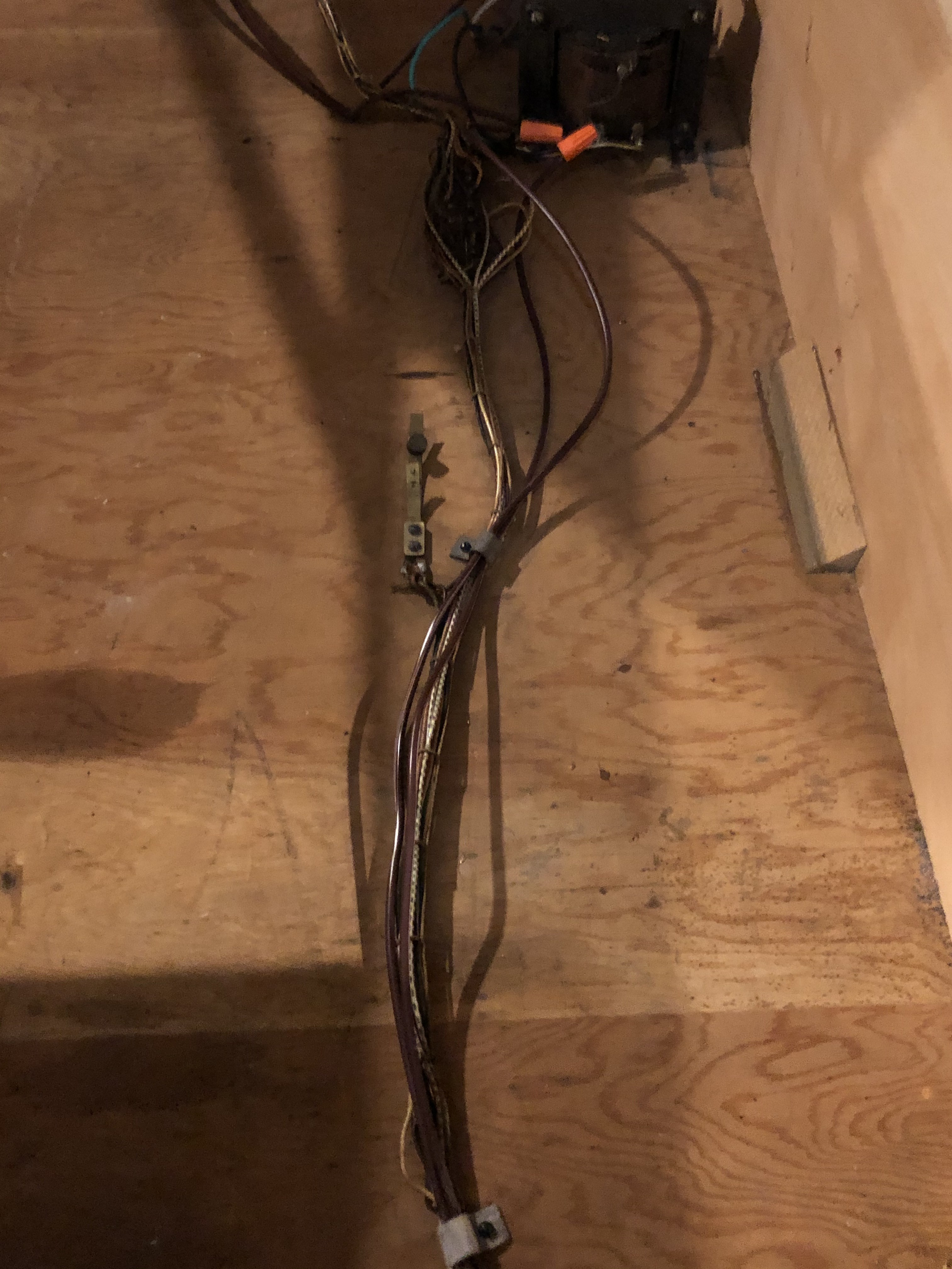

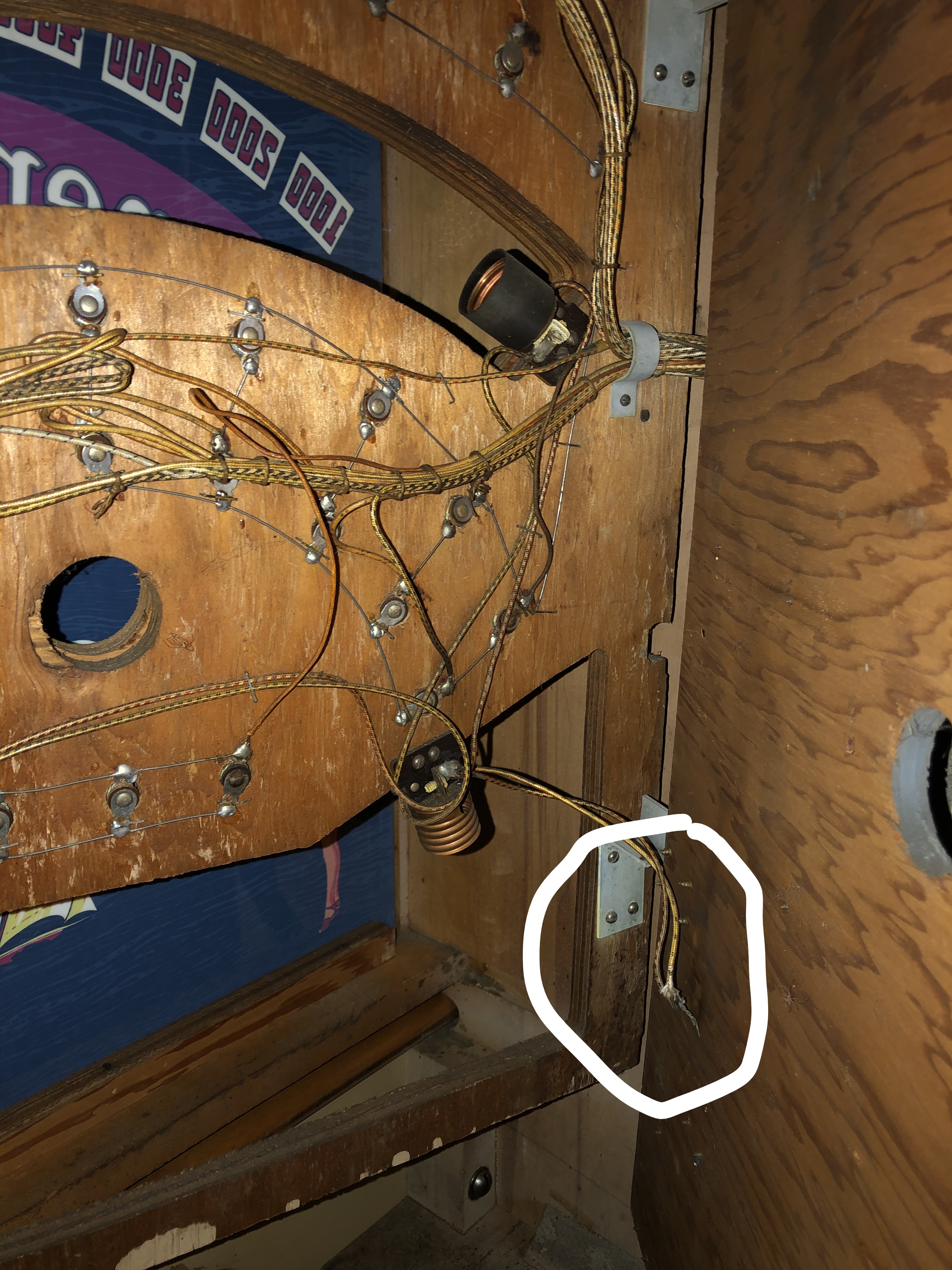

Well, This Can't Be Right.
The power to the 120 volt lamps (yes, 120 volt 10 watt lamps) in the head is odd.
Each lamp has a hot and neutral wire, as you would expect.
There are 4 lamps (2 top, 2 bottom - one on the left and one on the right).
On the left side (facing the head) there are two wires off the bottom lamp that go to the side of the head.
And they are tied together.
Hot to Neutral = Dead Short to Ground. = Smoke if no fuse (and since I don't have a wiring diagram.....)
So, here's what I'm looking for:
If anyone has a 1940's Chicago Coin pinball game, can you look at your backglass lamp wiring, and even a hand sketch, load here what the wiring looks like.
I know this can't be right. But these wires didn't just appear out of thin air - someone either added them, or they went to a lamp which is now removed. Maybe a 5th bulb in the middle. I'll go look for a missing fixture.
Well, I have that figured out - now what to do?
The wires I found bound together are dead shorted to ground. But that's okay - they aren't connected to anything but the lamp sockets - there is no power available.
If I follow the wiring convention (close red diagonal stripes on a white wire or HOT, close diagonal black stripes on a white wire, or Neutral) and then look, I can tie the black striped wire to the head central ground, (better check the small lamp voltage FIRST) and the red striped one looks like I could land at the red striped white wire coming into the Jones Plug.
Anyone want to dig in an old Chicago Coin head and see if they see that?

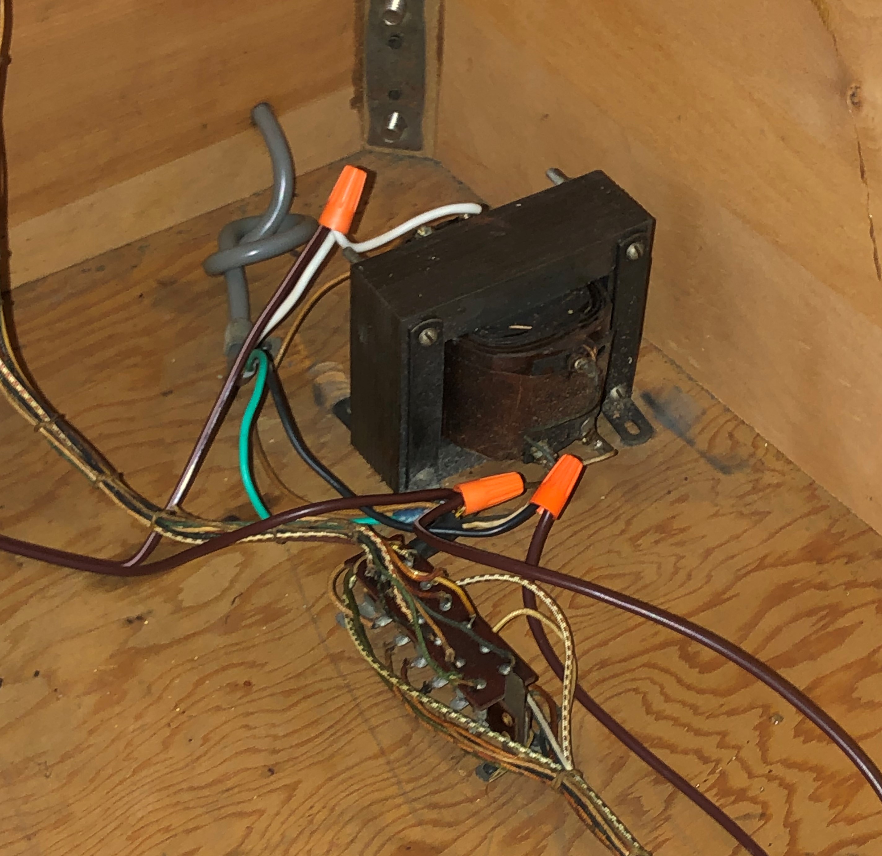

Okay, I got past the disconnected wires. See the thread looking for Super Score wiring diagrams (resolved!) for the details. Now putting in a power switch and the connection to the light switch with a T-Tap.
At this point, I'm ready to start burnishing all contacts in the game with a Flex File, and then after a final check with the ohmmeter looking for shorts to ground / neutral, going for power on.
I'll keep an G08 Repair Kit Fire Extinguisher (pin pulled and manned) at the ready during the initial power checks. That, and hook it to a surge suppressor / individually circuit breakered power strip for easy off.
I put in the power switch - basically inserting it in the circuit between the power in and the transformer. I morticed out the hole so the switch could travel. The plywood on the bottom of this game is very thin - around 3/8". I had to use washers on my shortest screws to not poke through.
At the same time, I interfaced the new Main Lighting wires into the same circuit, so when I turn the game off, they are off too.
Interesting how little is under the playfield on these early games. Very simple. (and probably b o r i n g, but we'll soon see.

Everything is now working thankfully, so tomorrow I'll hit the playfield with Millwax and then clean the top glass, install it and I'm done. Push it into the line up, and move on to the other games in need of maintenance (too many of them do - time to work it down!)
Now on to figuring out the various wiring glitches.
I don't think this bumper is the best for the job. It fills the space, but when balls hit it, it doesn't have much rebound. I'm back on the hunt for something better. I might carve down a normal bumper and drill it out to fit.
Now to figure out how to do that and not look terrible.

I replaced all 5 balls with Silverballs - probably overkill, but after I polished all the metal work which would be in contact with the balls, it seemed prudent to spend the extra few dollars.
I just played two games - it works. My wife watched and said "Wow - is that it?" Yep.
